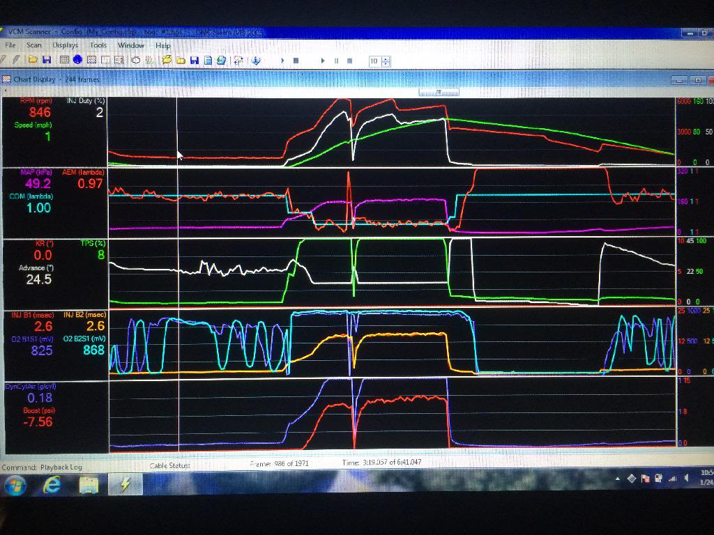

Turned out to be a pretty embarrassing night I managed 2.5 second 60' all night long. If i built any boost at the light, I would blow the tires off as soon as I let go of the brake. The tires would unload right away. And if I just tried to flash the converter, the 4.8L is so doggy down low that it wouldn't launch at all. Best run was 12.99 @ 115mph That run I blew the tires off after the 60. So I had to let all the way out and get back in it.
I was having a weird issue all night that were pissing me off. The trans wouldn't shift out of first fast enough. I have it commanded to shift at 6000rpm and 51mph. Looking at the logs, 6000rpm is right at 58mph or so so it should shift as soon as 6000rpm is hit. Well it wouldn't. The first log shows the wideband going all the way lean when the limiter is hit and the second log doesn't show lean at all. It was definitely cutting fuel at the injectors. So it did that the first to runs but instead of bouncing off the limiter, it felt like a huge misfire. I would have to get out of it, and then get back in. After it would get out of first, the truck was smooth as hell the rest of the run.

The 80es take a while to shift...keep moving the points down until it shifts where you want, and try to match the rpm and speed.
