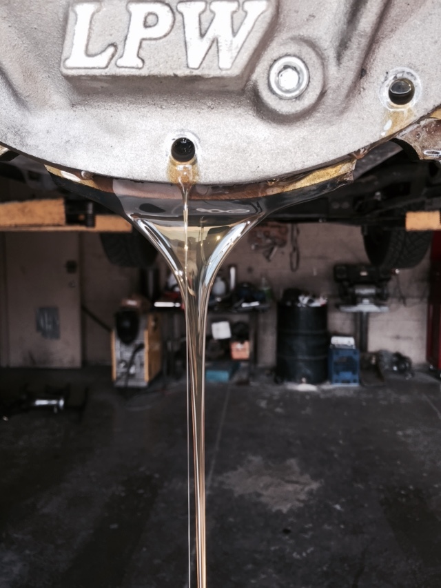

Let the festivities begin. Literally don't have any parts for the swap but what the hell
Fluid looked good

Damn I've never seen used rear end fluid look that clean!?
It was only run for a couple thousand miles haha

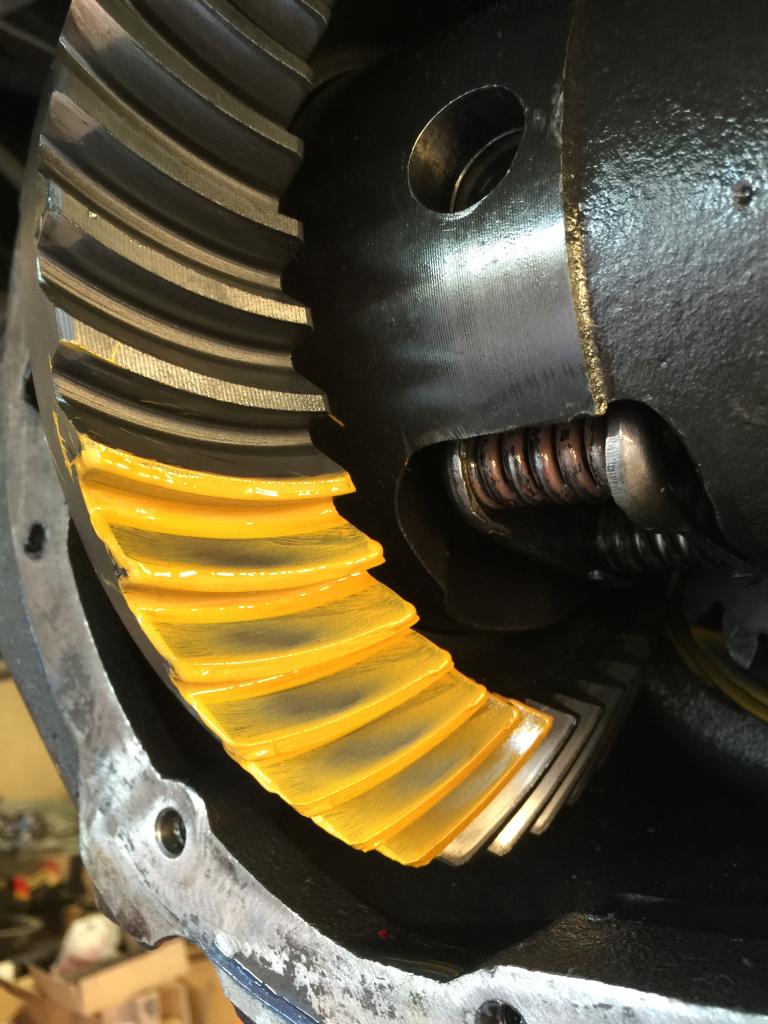

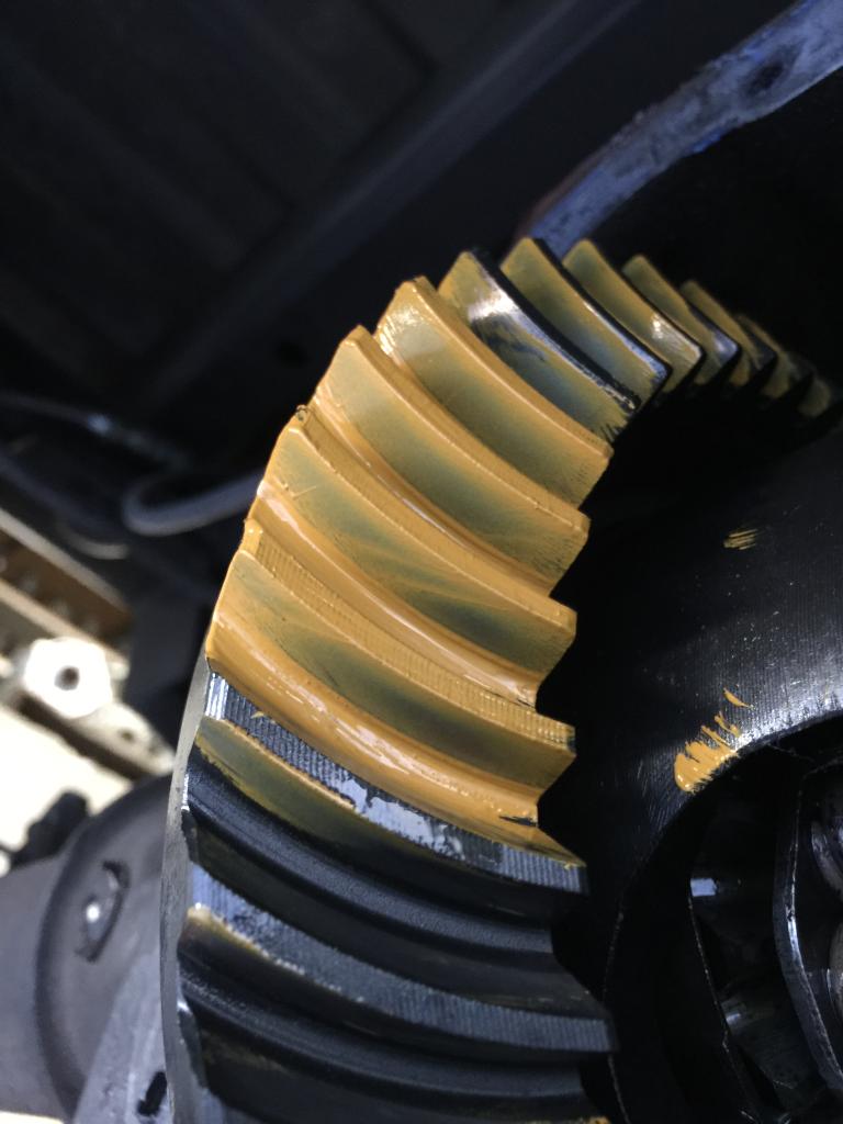

From: Las Vegas, NV
Didn't get a whole lot done today but I made some progress. Got the 3.42's installed and set up. Tomorrow my wheels will be shipping and I should get my 5 lug axles in. So tomorrow night I will slide those in and button up the rear end. Then it's just a waiting game for wheels/tires and front hubs to show up.
