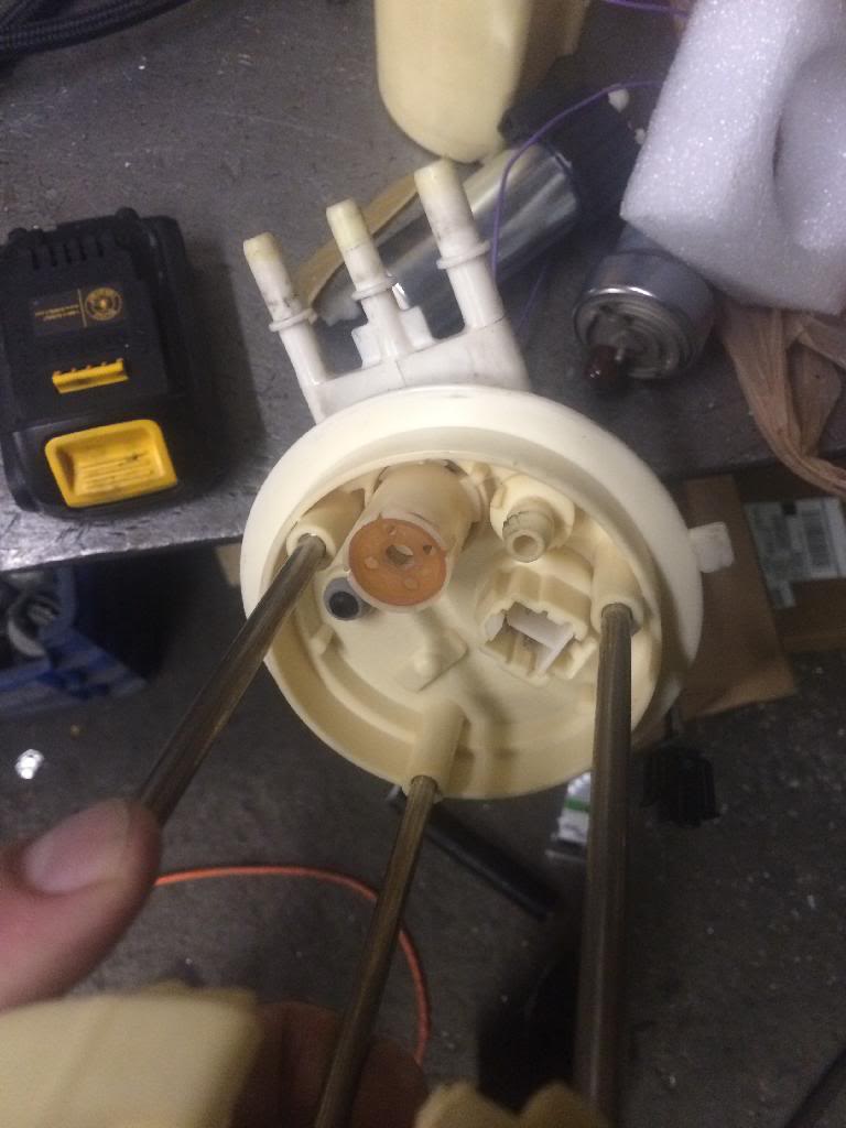

I'm going to head down to the shop today sometime and study my fuel bucket. I'll post some pics and see what you guys think about how to build the dual walbro set up.

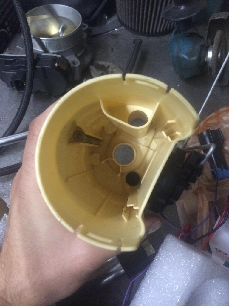

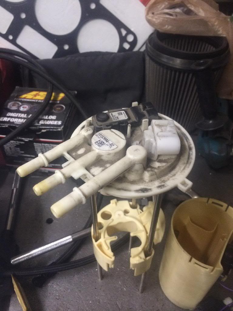

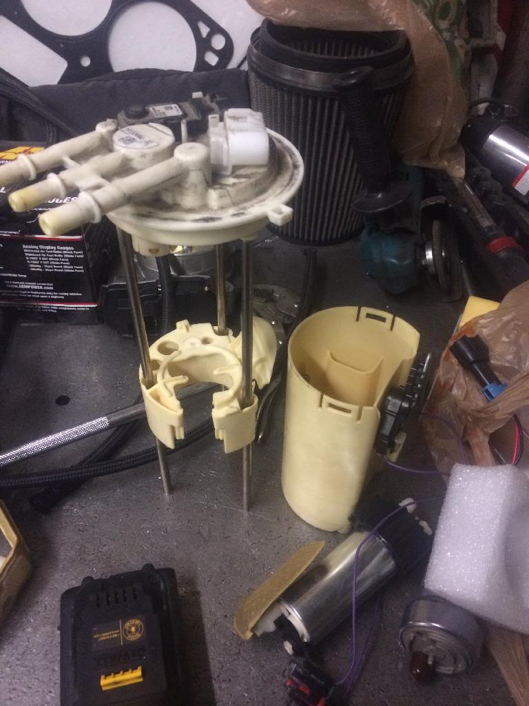

Here is my stock bucket

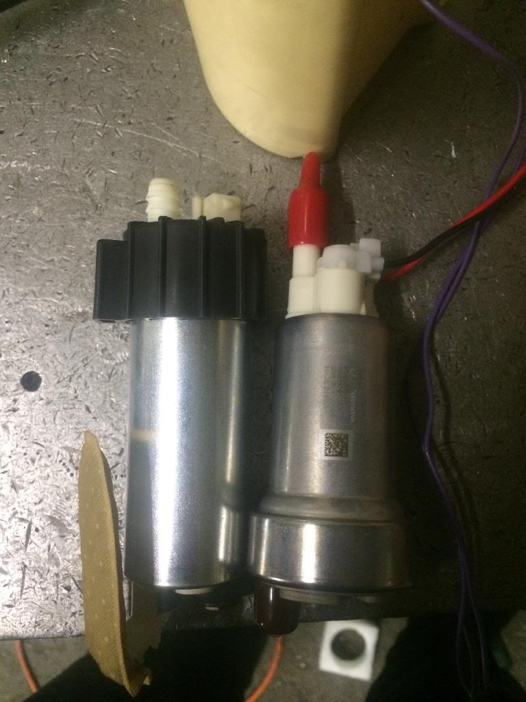

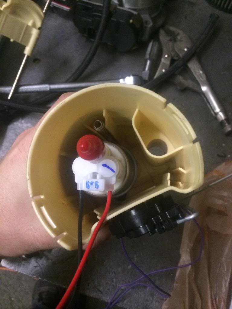

Here is one walbro 450 in the bucket:
450 vs stock pump
