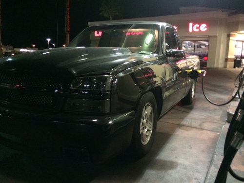

![Default](https://www.performancetrucks.net/forums/images/icons/icon1.gif)
Well I went ahead and filled the truck up with corn juice a couple hours ago. It really does feel like a whole different truck. I put 20 1/2 gallons in so I'm guessing it is around E50-E70. I can't believe how much more power it has. I looked at the log on the way home and never got above 65% tps. Tomorrow I'm going to drive the **** out of the truck ![Grin](https://www.performancetrucks.net/forums/images/smilies/LS1Tech/gr_grin.gif)
