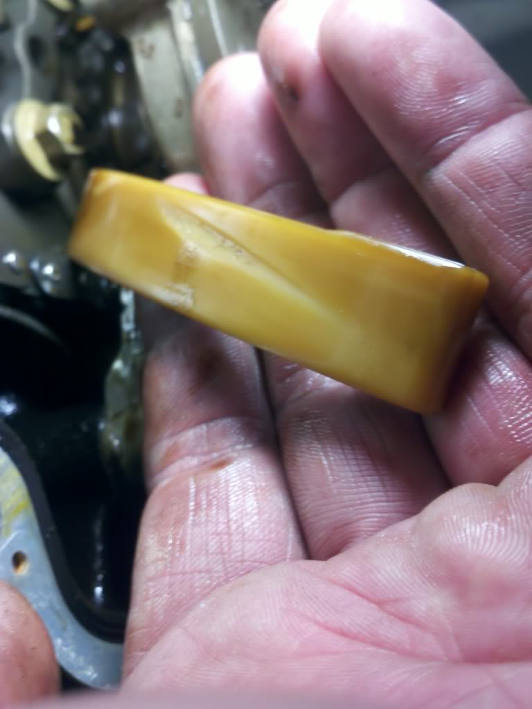

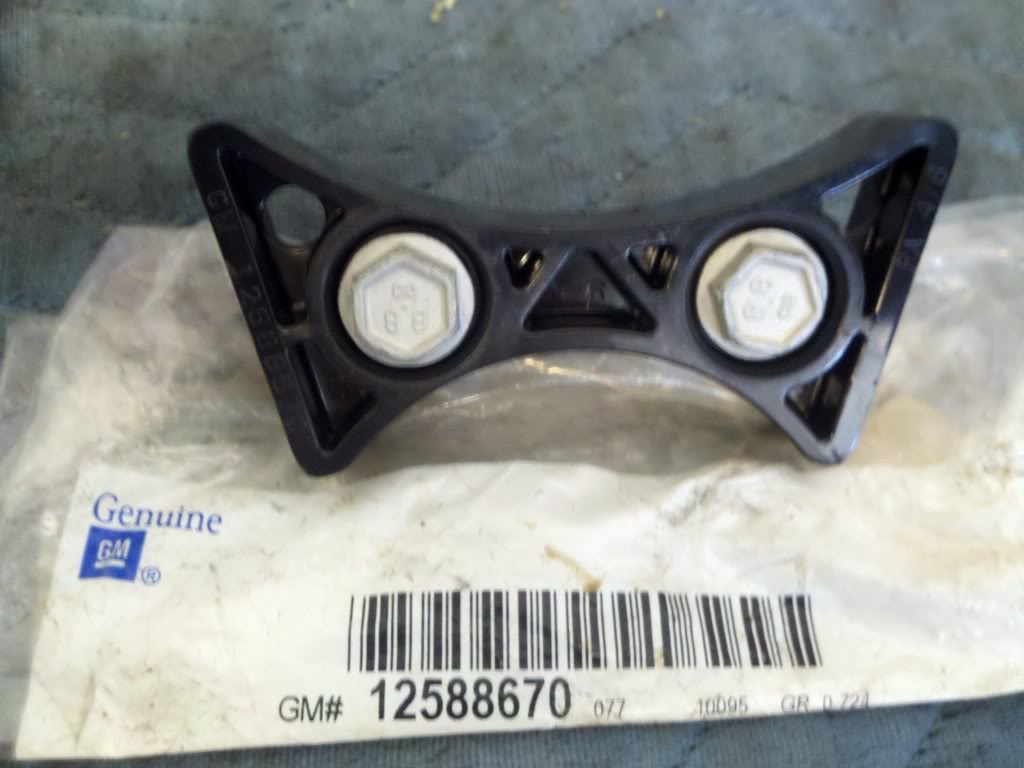

little bad discovery when the front cover was removed . . . . lots of extra work now.
Stock timing chain dampener BROKE ! . . . plastic and the spring plate, timing chain has lots of slack.
Dropping the oil pan, pulling the pump, swapping out the timing chain, timing chain dampener. . . .
I'm fighting the oil pan, taking a break to post these.

Yep, put the ls2 dampener when i did my dod delete/cam swap... heard about too many of those breaking...
Same here...
I had "heard/read" about them breaking, but this was the first that I've seen
