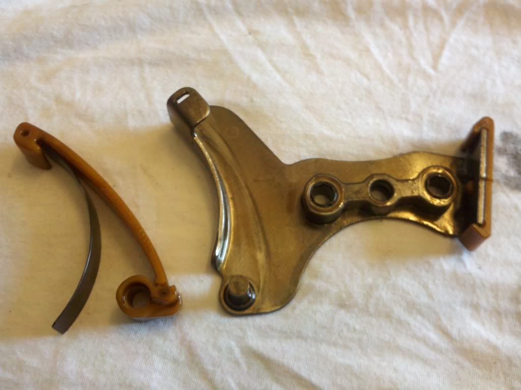

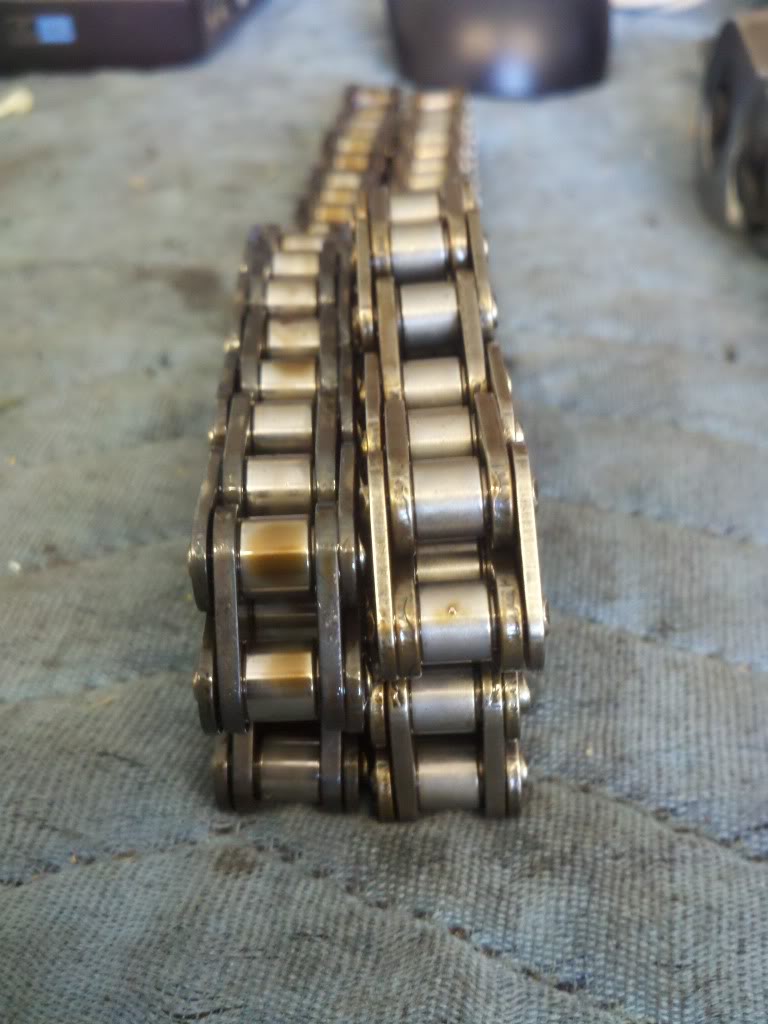

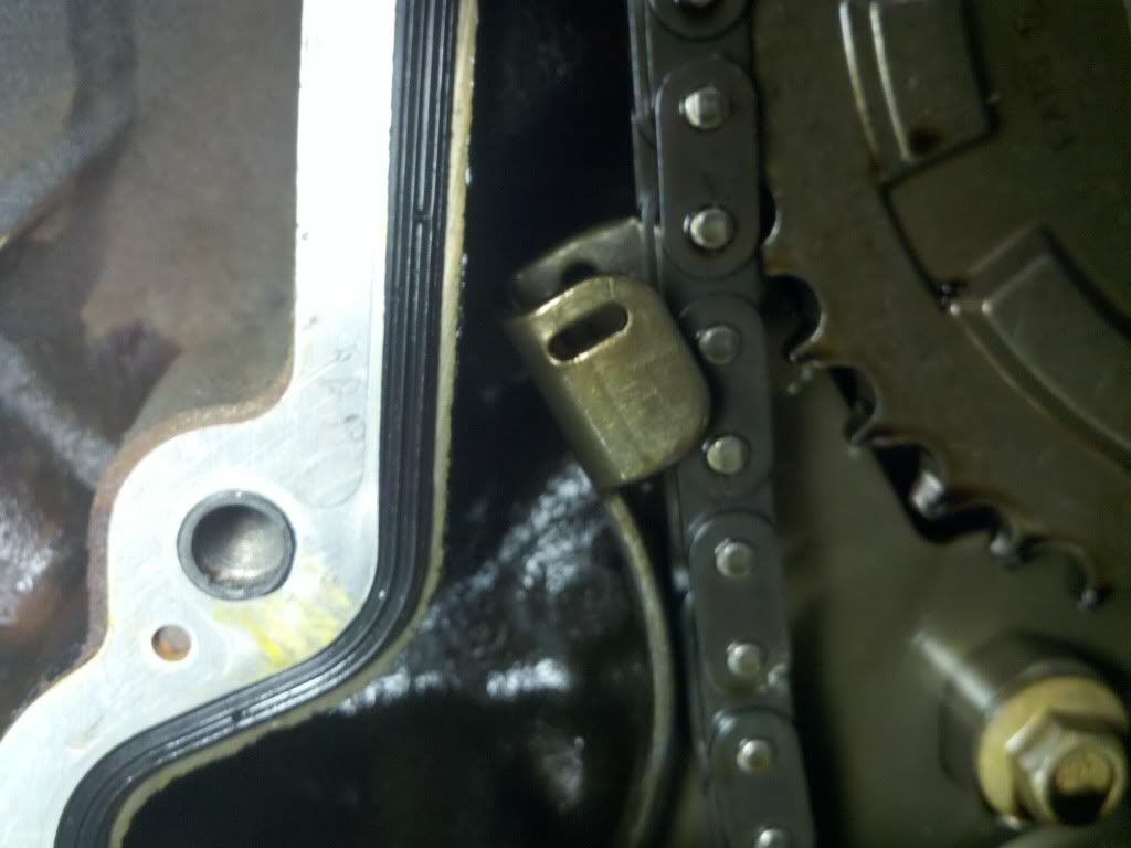

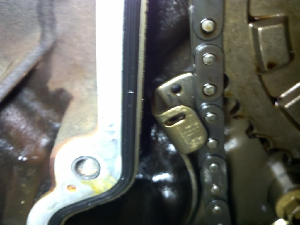

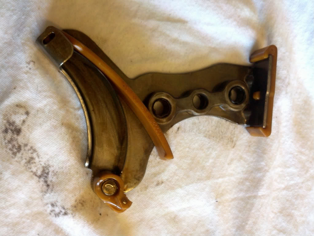

here's some more pics. I'll get a vid uploaded later on tonight on the slack in the timing chain.
I ended up replacing the tentioner, timing chain, and oil pump oring
the stock chain is the dark one on the left. Stock shinny LS2 chain is on the right.
