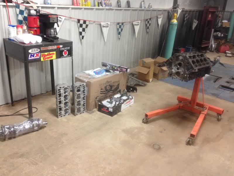

Seems like everyone is going turbo anymore, so I'll stick with nitrous.
Block is a 6.0 bored 4.030

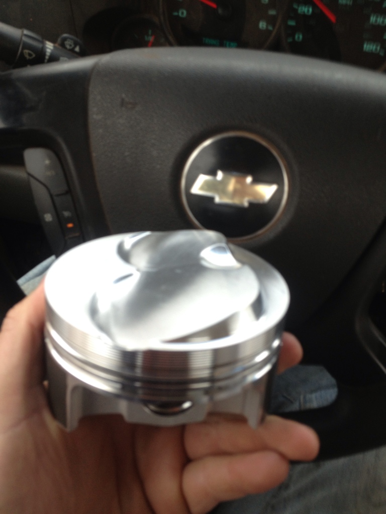

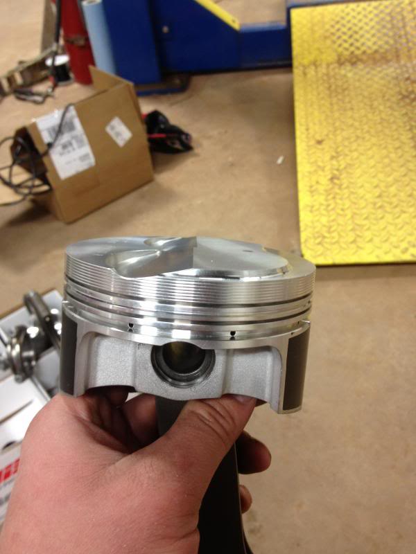

Pistons are Wiseco 12+cc dome pistons that have been milled down to 5+cc dome. 11.8:1 compression

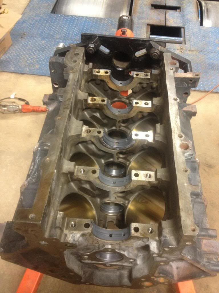

King Main and Rod Bearings

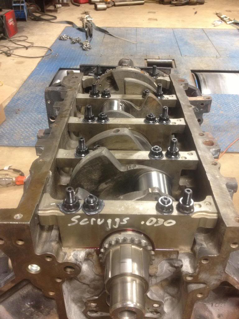

Stock crank with ARP Main Studs

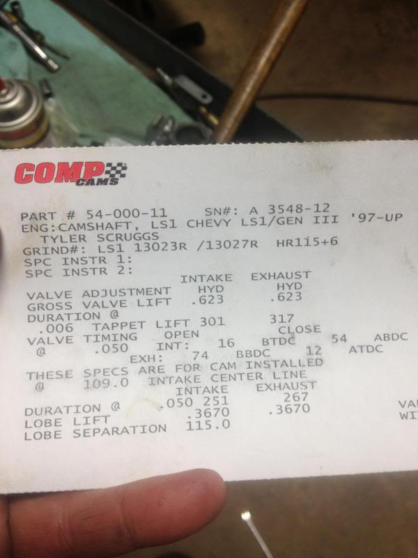

Just a baby cam

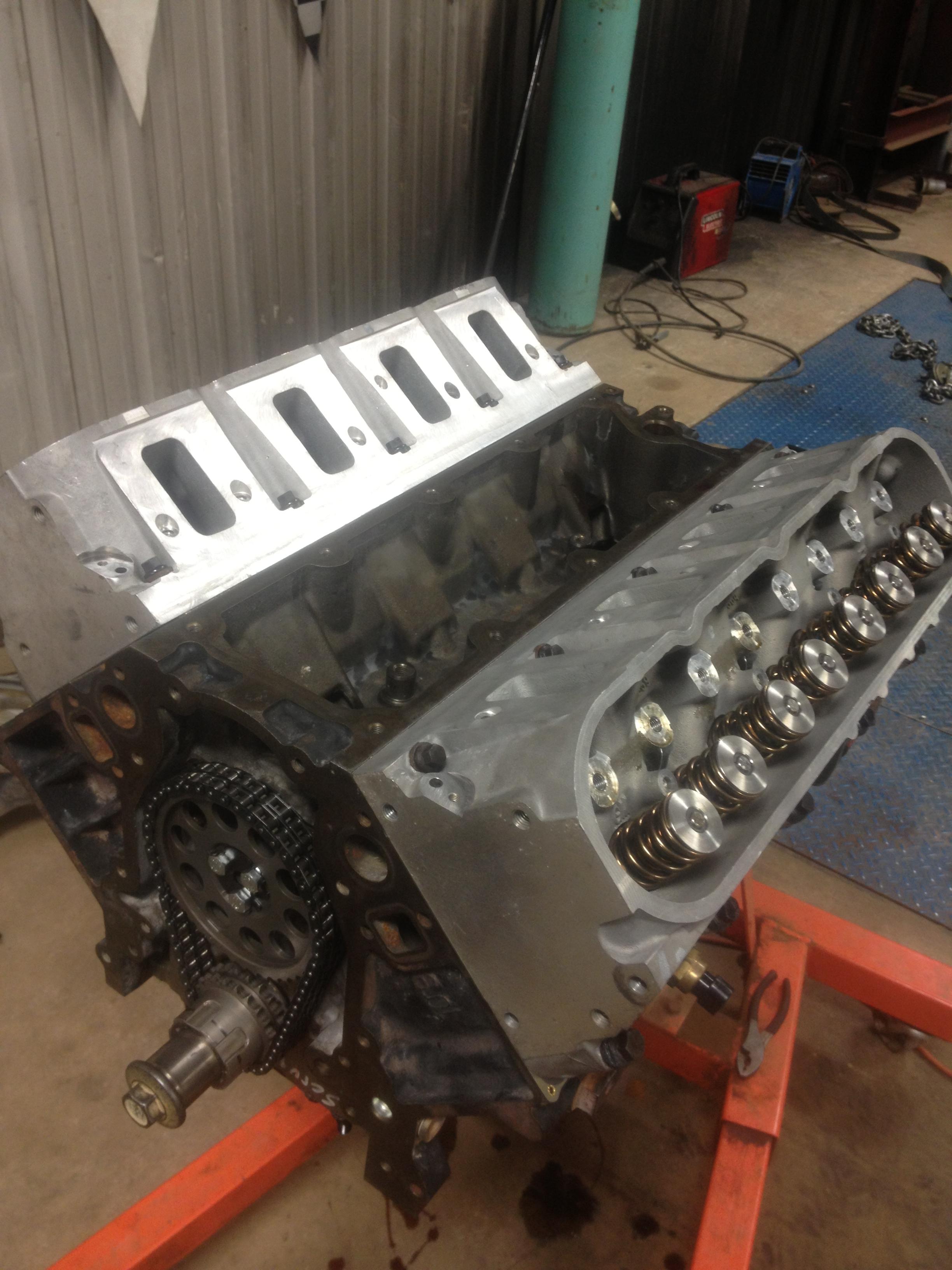

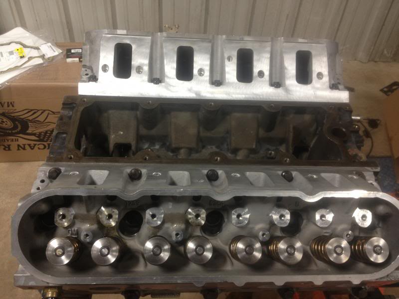

Double Roller Timing Chain, L92 Head Milled to 64cc chambers, also put some Titanium Retainers on the Lunati .660 lift springs.

Ooooo Should be good. Can't beat the King bearings for the money. Cheap and have a great track record.
Old Mar 17, 2013 | 11:08 PM
dirt track racer 81's Avatar
iTrader: (45)
Joined: Jun 2005
Posts: 9,439
Likes: 13
From: Hennessey, Oklahoma
Considering they were free, I damn sure couldnt pass them up. They are really nice bearings and I might just start using these from now on.
Old Mar 17, 2013 | 11:10 PM
Mangled03gmc's Avatar
Baltimore Whore
iTrader: (95)
Joined: Apr 2004
Posts: 16,820
Hell thats even better. How much smack you gona hit it with ? also what rods you using ?
Old Mar 17, 2013 | 11:16 PM
iTrader: (45)
Joined: Jun 2005
Posts: 9,439
Likes: 13
250-300 depends on what we make on the jets thats in it now. Right now it has 225hp jets but we made 275 more hp. Rods are the same rods I've had, they are just cheap ebay hbeam rods with arp 2000 bolts.. Had them checked out and they didn't see anything wrong with them and didn't need resized..
