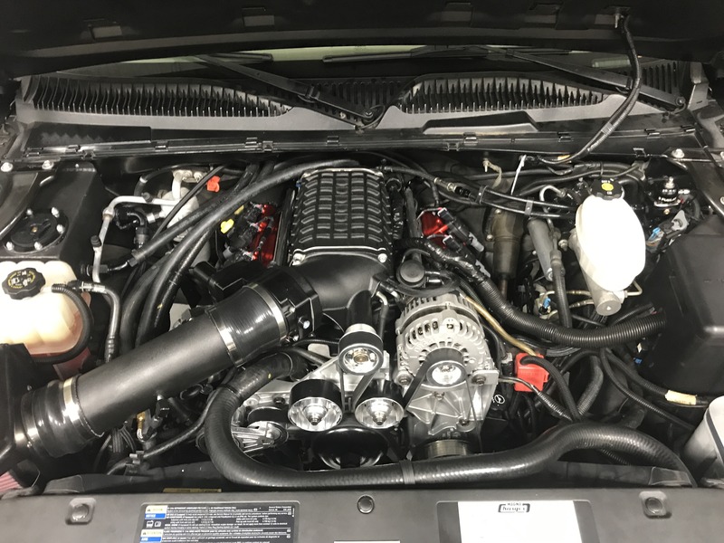

Looks awesome.

I like that. Looks good man.
