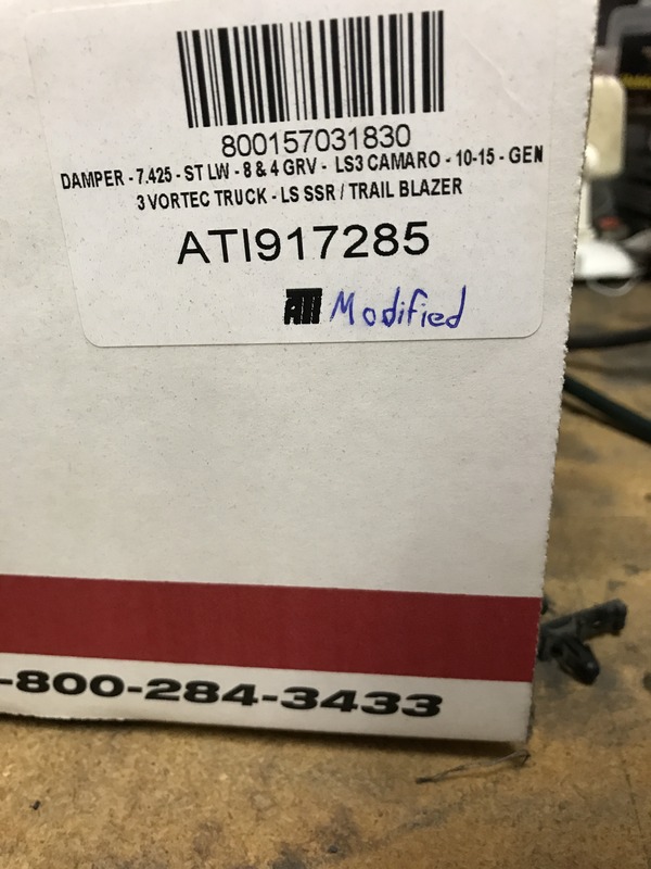

Pat, could you explain the process of buying that balancer and pullies? I found out that my new balancer wasn't compatible with my Whipple 2-belt pulley and bent the unobtainable Whipple part. I was looking at the website for your super damper, and I was overwhelmed. Do you think that they can reproduce my pulley configuration? Did you call them, or was your setup pretty cut and dried?
This is the part info, I have an ATI account so I just called my rep and told him what I wanted. They actually take a standard pulley I believe and swap on the OD hub as they don't specifically list it from what I've seen. Yes I hear ya on their catalog, I've drank some beer and stared at it and gave up. Lol.
I had them cut mine for dual keys also as that's what my crank has.

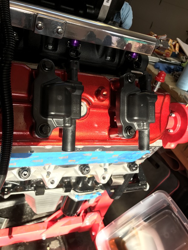

Looks great! Love that color red in there​.
Coming from someone who likes blacked out that says a lot. Thank you, I really like how the color turned out, it looks awesome in the sunlight. The picture doesn't do it justice.

Old Apr 23, 2017 | 10:13 AM
  #196
Atomic's Avatar
I have a gauge for that
Posts: 16,282
Likes: 438
If it didn't do black a dark cherry red would be my next choice. Black is just so much easier and cheaper though.
I'll look into that, trouble is there just isn't much room the way the factory mounts work.

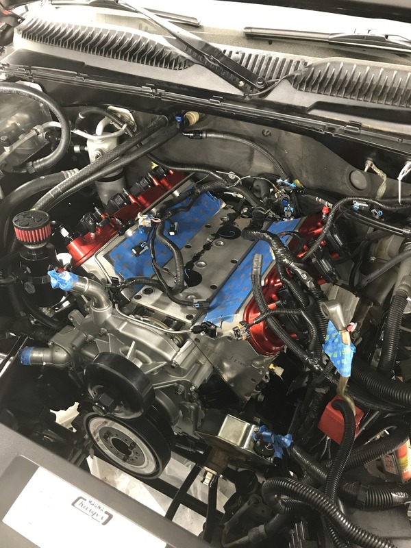

Small progress, not much new. Been really busy with other stuff. Engine wise basically it just needs pre lubed and the blower installed. Still have to get trans together.

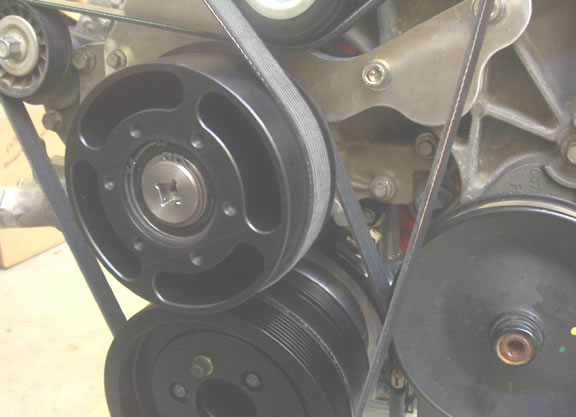

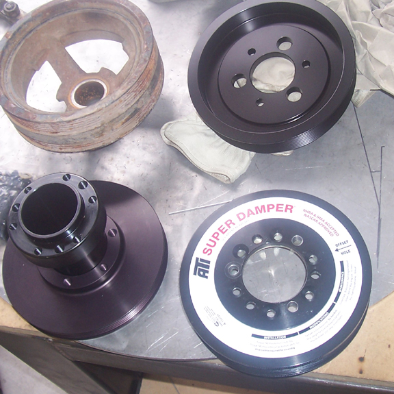

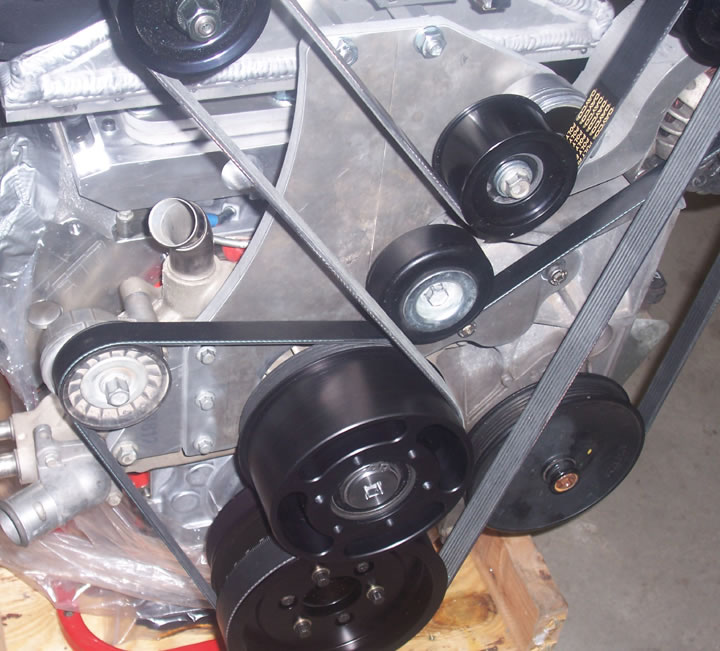

Sounds like what I am using. These are old pics. I have since replaced the 8 rib blower pulley with a 12 rib. Not sure what offset you need for the blower belt. This is basically a Procharger setup. So.... hub + 4 rib AC + 6 rib Super Damper + 12 rib blower pulley. Guess you could get a custom offset blower pulley if necessary...just bolts to the front of the Super Damper. Just lookup the standard truck hub, AC pulley and 6 rib damper, then add whatever you need for the blower pulley.
