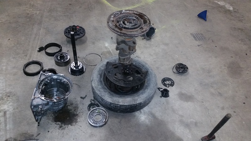

Tomorrow will be the big day for the powerglide.
It is getting a complete rebuild with Kevlar band, trans brake valve body,
JW Ultra Bell front bell housing, and the guy doing the rebuild is also giving
me a scatter shield but I will need to either buy or fabricate the brackets to mount it to the transmission.

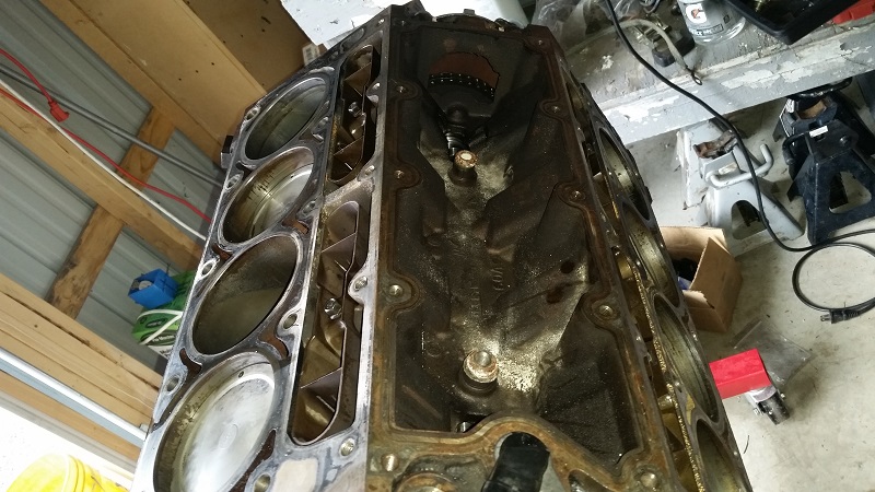

#45

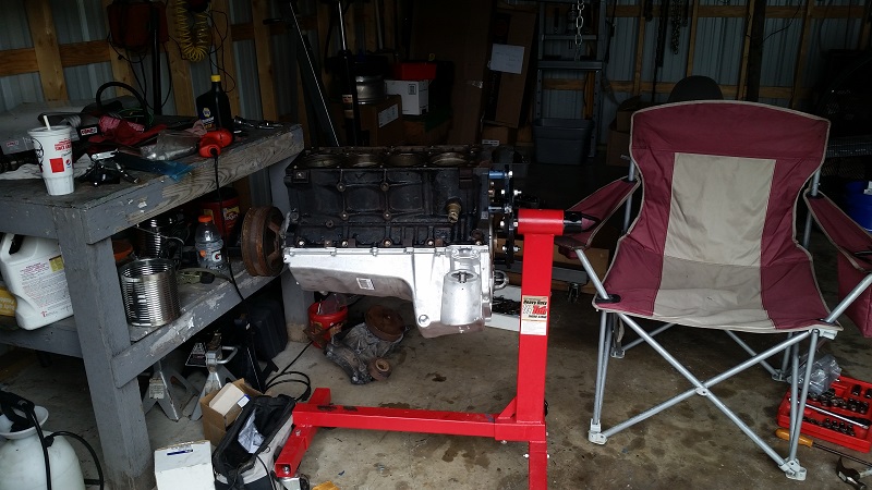

I have the engine as far together as I can get it without having head gaskets and other significant items, such as 6LS box, intake, head gaskets, carb, long tube headers, radiator hoses, electric fan, and all the small stuff along the way..
I did get the oil pan put on, got the bad harmonic balancer removed and another installed, got the cam swapped, and have everything ready for some ARP head studs to be inserted and then put on the head gasket and then the 243 heads.
I am going to swap the plugs in Mom's F150 in the morning before moving some stuff around and getting the S15 back in the garage for some significant teardown work.
I am hoping to get the driveshaft out, the motor mounts swapped, the engine set on the mounts, the entire dash out, seats removed, carpet removed, wiring harness removed, and the panel from the driver door removed. I would like to get the passenger window replaced with plexiglass but no money to do that this time around. Maybe in a few weeks once I am back to work.
I have a couple pics below.

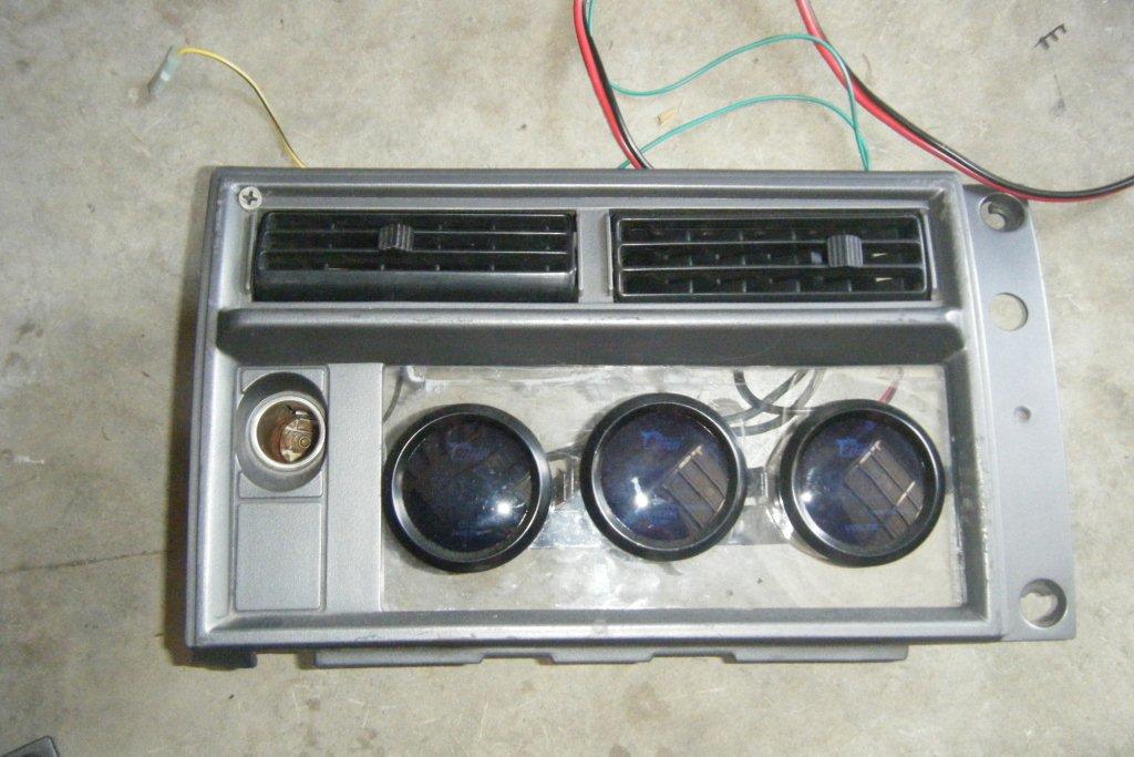

Ordered head gaskets and transmission filter spacer for the deep transmission pan..
Didn't get to do much to the S15 itself except this afternoon before I left
I went through and cleaned all the stuff out of the interior. Got the cheap
tach out also.
I was seriously tempted to dig into removing the whole dash and cluster out
of the truck, but time just was not on my side for being able to get anything
done but make a mess. So I opted to not make the mess.

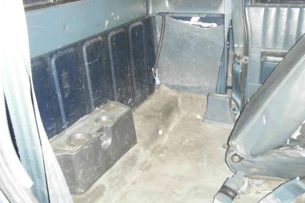

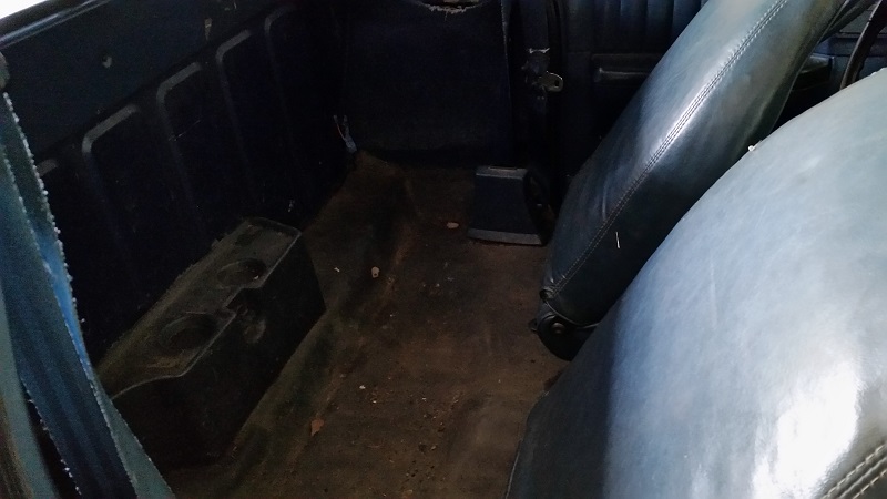

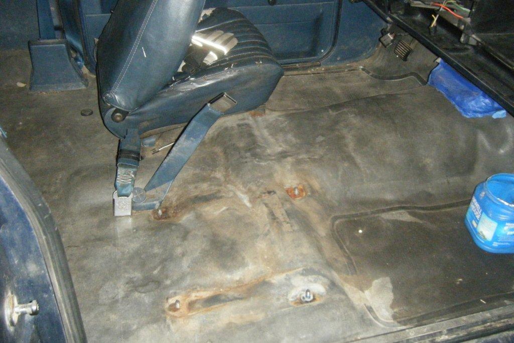

Well I have officially decided to gut the interior of everything non-essential,
such as passenger seat, vinyl floor, dash, instrument cluster, and all ducting and wiring.
I intend to put it all up for sale pretty soon, but I want to get it ALL out first.
I am keeping the seats for now until I can find a wide racing seat that will work for my big ***.
I already have a heat gun to remove the insulation that uses the glued up tar **** if there is any.
For now, the steering column will stay, although I may try to move it forward some if I can.
Will have to do some checking and see. If I can move it forward about 3 to 5 inches, I will be happy.
