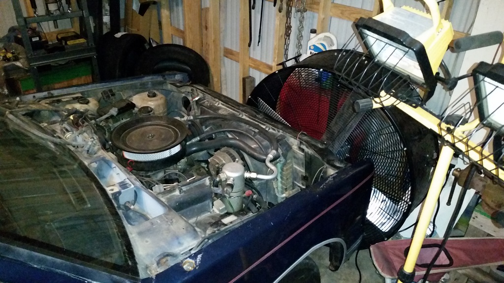

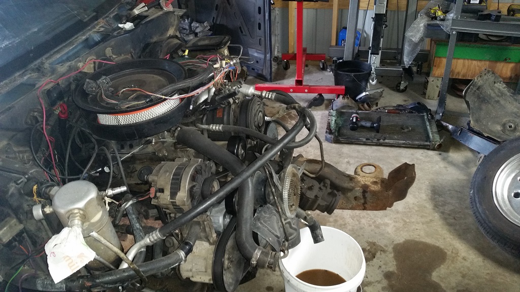

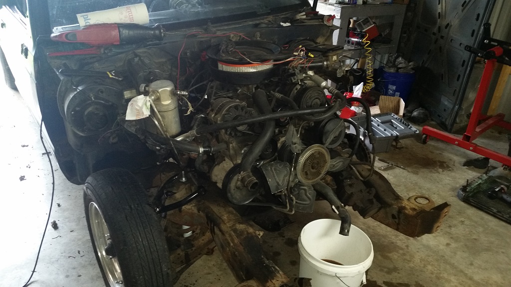

I am just kidding. Although the truck is actually in that state right now.
I started the part of the project where it involves removing the whole front
clip to be able to easily access everything necessary to remove the engine
and trans together. I still have to remove the transmission mount bolts,
power steering pump lines, and any miscellaneous wiring/lines that are
necessary to get it to come out. I also plan to remove the fuel tank when
I get home next weekend and start the process of installing the fuel cell
and some of the fuel lines once I get the original lines out of the way.

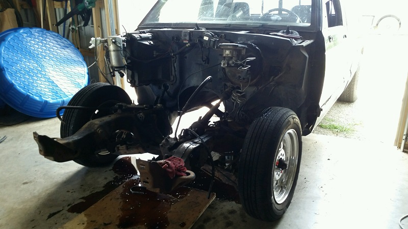

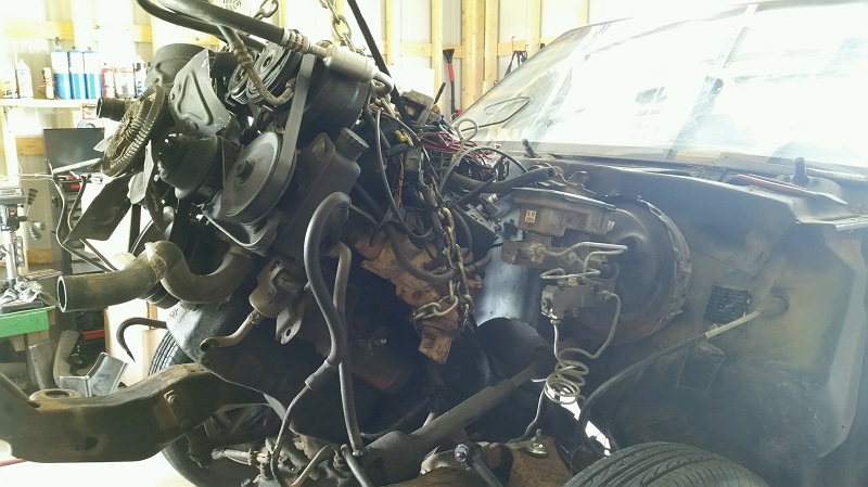

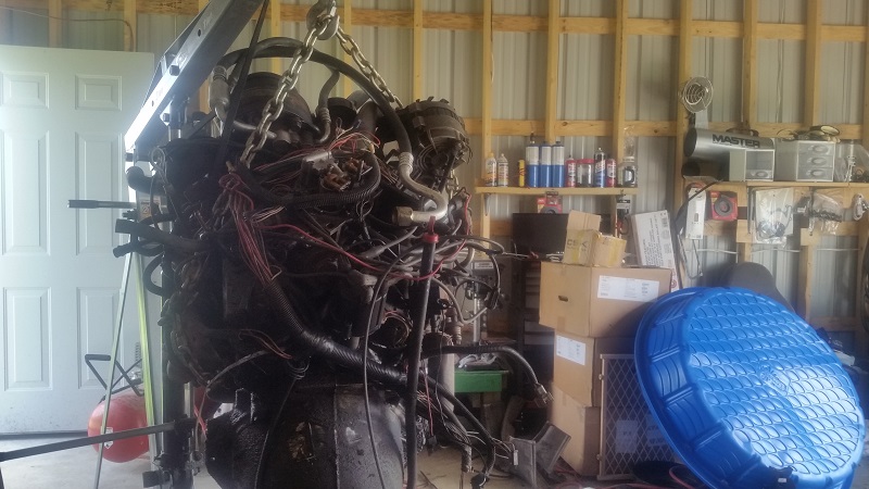

Well today was quite productive.
Got out the motor and trans.
Got majority of the engine bay power washed.
Still have a LONG way to go because of the work needed to be done
on the front end as far as ball joints and tie rod ends.
It cleaned up pretty good but not perfect.
Maybe one more trip around the engine bay with a good soaking of
whitewall cleaner, and the pressure washer will get the job done.
Still have to remove the original 2.8 engine mounts.
The transmission wasn't even bolted to the cross member... figures!!
Also found a missing bell housing bolt, 2 loose bell housing bolts,
and an absolute **** ton of oil and grease and transmission fluid all over this combo.
Between the missing bolt, the loose bolts, and the missing bolts in the trans mount,
I figure my grinding sound was coming from there.

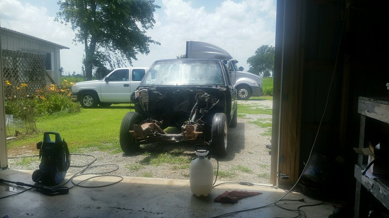

Once I got done pulling the engine and trans, I put the truck down on the
front tires so I could roll it backwards out of my way. I let the jack down and
started to push, that damn truck would NOT move!! I am looking around
trying to figure out why and then I realize it!! FORGOT ABOUT THE DROP
SPINDLES!! I had set the drivers lower control arm down on top of the
engine hoist!!
SMOOTH MOVE EX-LAX!!!
As you can tell I got it off the control arm and outside to start the pressure
washing. Wish I had taken before and after pictures of that front frame clip.
Cant call it an engine bay cause its wide open. LOL That thing was just plain
old NASTY... It will still need a really good soak before it gets pressure
washed again.
