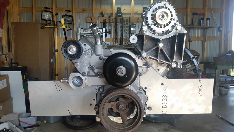

Today was a day of putting what I have where it belongs and knocking off a couple things that don't need to be around..
I put the water pump on, cut down the alternator bracket, put the tensioner on, and put the alternator on.
Now all I have left to do is put the gaskets that go between the water pump and the motor plate on when they come in.

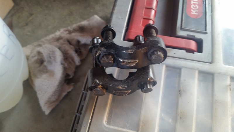

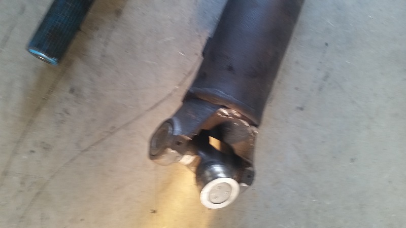

Also took the driveshaft out of the truck and realized what was causing the awful grinding noise under the truck when I would drive at steady speeds...
the front part of the original driveshaft was in a carrier bearing and apparently it came apart.
Because the driveshaft was NOT where it was supposed to be..
Ruined my brand new Moroso 1350 Ujoint caps also...
Cutting the alternator bracket down was an absolute bitch of a job.
Gave me blisters from using the sawzall, it pulled the skin off because it kept getting hung up...

Good part is the Strange pinion is undamaged.

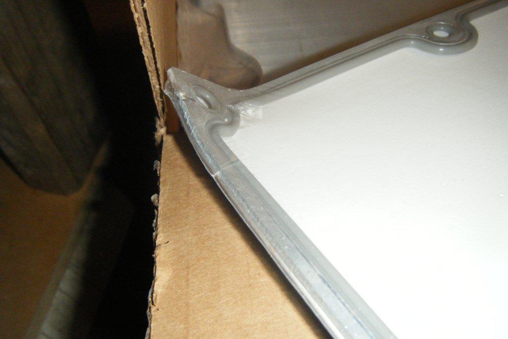

Well ****. Mom got home and checked the lifter valley cover plate to discover that the corner was bent and the new gasket was broken.
Contacted the shipper. No clue how that is gonna work out.
