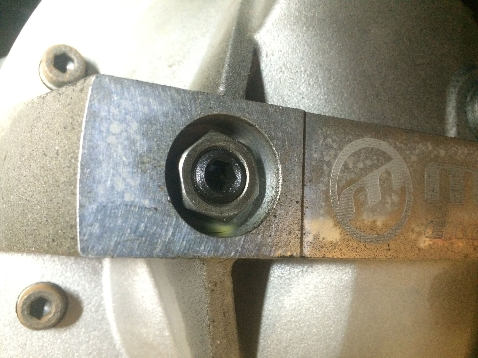

I also had a chance to fix my diff leak. The Moser preload studs were leaking pretty good. Lesson learned, use thread sealant on the preload studs as well as the fill/ drain plugs.

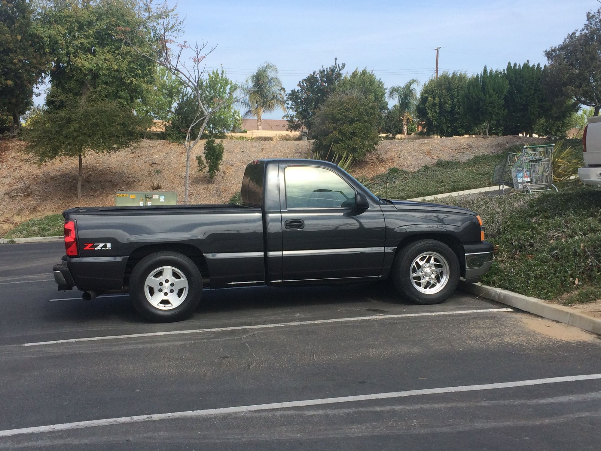

I did install some eBay 1" lift blocks to bring the *** end up just a bit. Next up I need to get tires for the 18" Centerlines I found on Craigslist. Wheels are an individual preference, although I know most on the site will not like the wheels I chose. I like the old man look: 18" Centerlines with nice big sidewalls. Going to go with 275/60/18, 285/55/18, or 285/60/18 when the wheels come back from polishing. I have not decided. The pic below is the fronts just bolted on so I could cruise around and make sure 285's clear (wheels came with junk 285/60/18 tires, 1 of which doesn't even hold air so I only bolted the fronts on). They clear perfect with not an ounce of rubbing, but I do have Atomic's coilovers so no more torsion bars. Btw - on my truck I found the perfect QA1 shock setting to be 12. Here is the truck as of this morning.

Also what kind of thread sealer did you use on the rearend girdle bolts?

Thread sealant is Permatex high-temp #59235. I use it on a lot of small stuff like the Autometer sending unit on the fuel pressure regulator, or any NPT thread where teflon tape would be used. I've never waited for it to dry and it never leaks.
