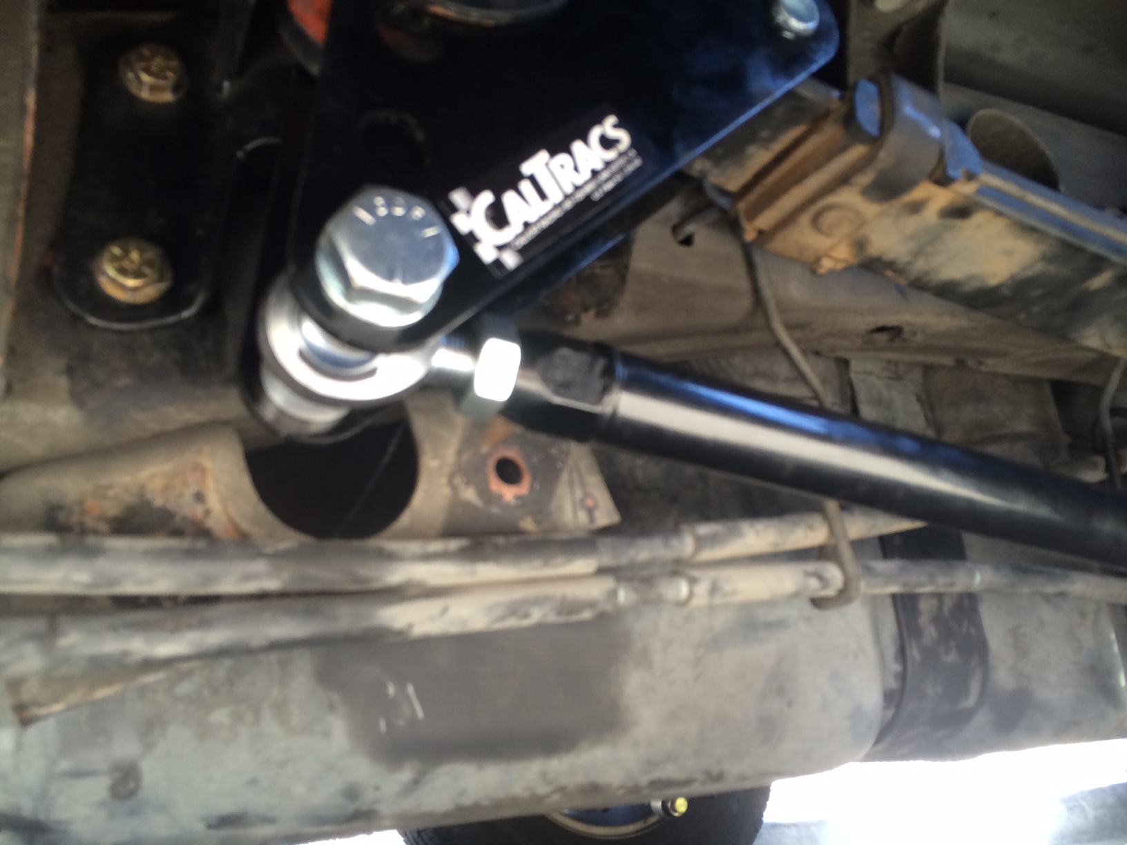

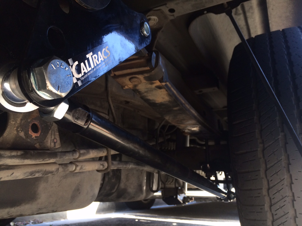

Ok guys a small update. Got the Cal Tracs in last night. It's been hard to find an afternoon here or an evening there as the truck is my dd and has to run. The cal tracs weren't too bad but the fact that I have Belltech hangers made the job take a lot longer. I had to unstrap the tank and shove it to the side so I could access the hanger bolts. I used my press to push out the rubber insides of the leaf spring bushings, then my air hammer to slowly get the shell out. Not too bad but I would put it in the pita category for sure. One really cool thing about the Belltech hangers is that the cal trac bars are completely invisible. Adds to the sleeper effect I'm going for. And unlike the cal tracs I put on my 6.4 super duty or my brothers Colorado 5.3 swap, the ones for my Silverado came with urethane sleeves so they are 100% silent. I'm running 1 full turn of preload but I'll likely back it down to 1/2" turn for daily driving. I will say the truck rides noticeably better with the overload spring removed, and the cal tracs in place. I'm super stoked on that. Tomorrow I'm installing the Trutrac and Moser cover. Sometime this week I will rebuild the front suspension with new inners and outers, rough country sleeves, pitman arm, and idler arm as the steering is a bit loose for my liking and will for sure make itself more apparent with the turbo.
I also got my downpipe back from Trick as he modified it for a 46mm gate. I wanted to eliminate and possibility of boost creep.
I also carefully removed the Z71 stickers from the rear. You can still see the outline a little bit, I still need to clay that area.
Once the steering is freshened up I'll pull the heads and have them surfaced and a valve job done. I'll do the turbo at the same time, hoping to start that next weekend. Here is a pic of the cal tracs (honestly hard to take a pic of them since they're so hidden lol) and how the truck sits as of today:

Very nice. Mine supposed to arrive tuesday and I will also be removing the overload spring as I see no point for it and also less unsprung weight.
I am also unsure about removing the front bushing, but I'm going to see if it can be done with a ball joint press and some creativity.

Truck is lookin good. I love that color.
I have used a ball joint press a couple of times on leaf springs. Works fine.
