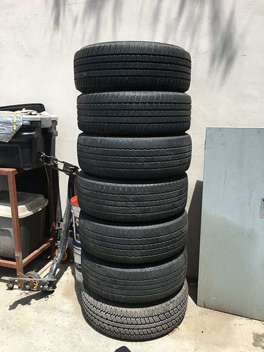

All these summer time project updates everyone is posting have really made me excited to hit the track. In the meantime, I've been taking care of some much needed maintenance items. Other than that, I've just been DD'ing the truck as usual and keeping my eye on Craigslist for 265/60/18 tires as they don't seen to last very long. I did score a sweet set of Michelins (one had a patch but holds air fine) for the unbelievable price of $40 for the set of 4. Used tire shop where I get my tires mounted says he usually gets $100 per tire for Michelin's since they're an OEM size and everyone wants them. Here is my growing stack of used tires I collect, along with my spare that I took off:
