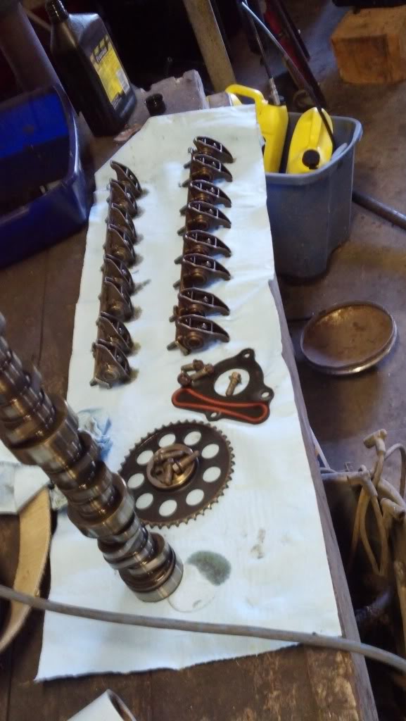

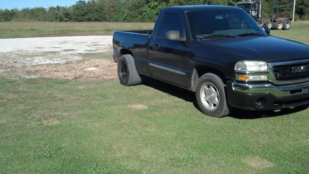

Figured I'd do a little update for everyone.
Lifted the truck up to stock height.

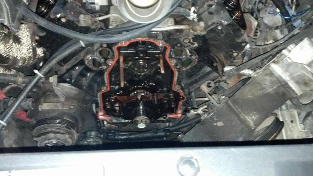

Swapped back to a stock cam to better match my stock converter. I'm sure I'll swap cams again. This is just for the mean time until I get a decide on what converter.
I don't know if people would consider switching to stock as a mod lol. But I figure I'd update y'all.

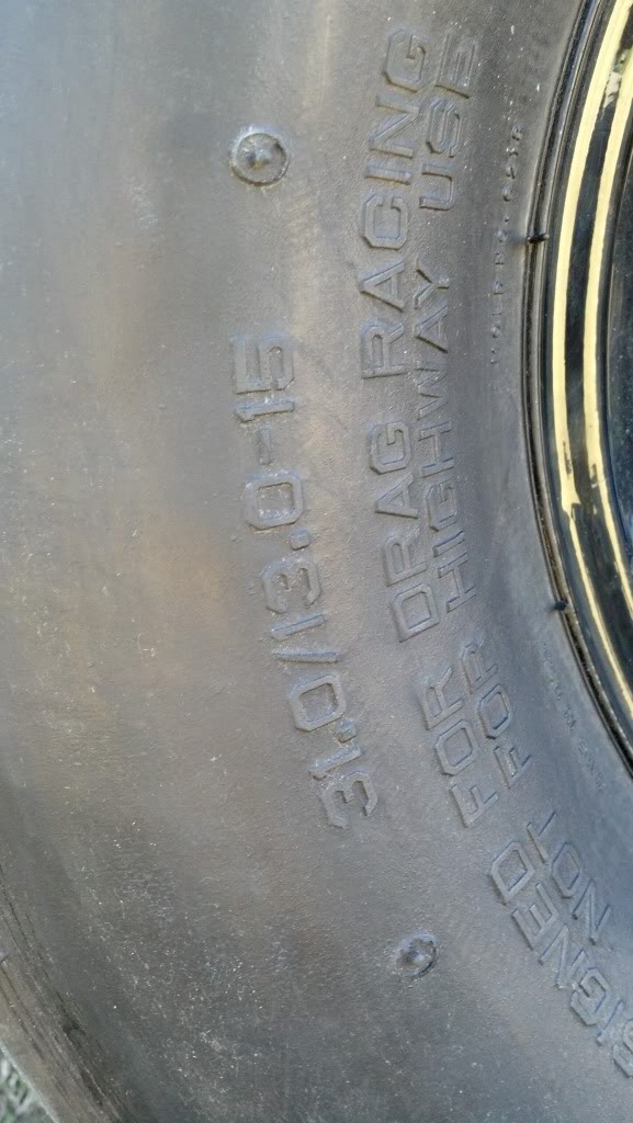

Also, I order some cheap summit wheels to mount my slicks on, a and bought a aem try boost and a bov from a member.

Ugly budget drag wheels? Count me in.

Out of boost it made the truck much more drivable with my stock converter, but I do believe it lost a little up top. Drivability = good upgrade, dig launches = good upgrade, wot power = not so much. That was to be expect though.
