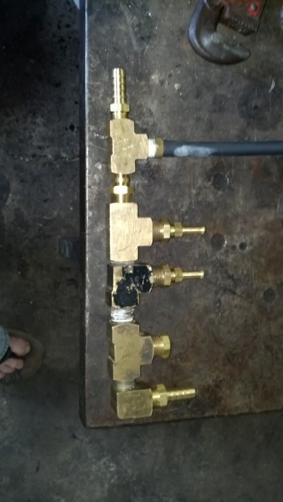

Also, built me a vacuum manifold with some leftover brass I had. Doesn't look to pretty, but should work well.

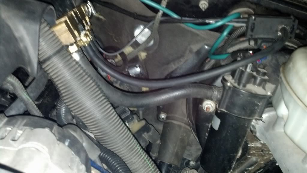

Interested to see the vids! Where are you going to mount that vacuum block?

Snapped a quick pic for you. Its just zip tied there, along with my map. Intend to clean up the wiring and make a nice mount for both, but you get the general idea.

Ok this might sound really dumb but I am new to turbo's and was wondering what the purpose of a vacuum block is?

Its just a good source of manifold vacuum if you have a lot of vacuum accessories. You just run the large vacuum port on the back of the intake to the block and then you can hook up your boost controller, boost gauge, ect to it.
