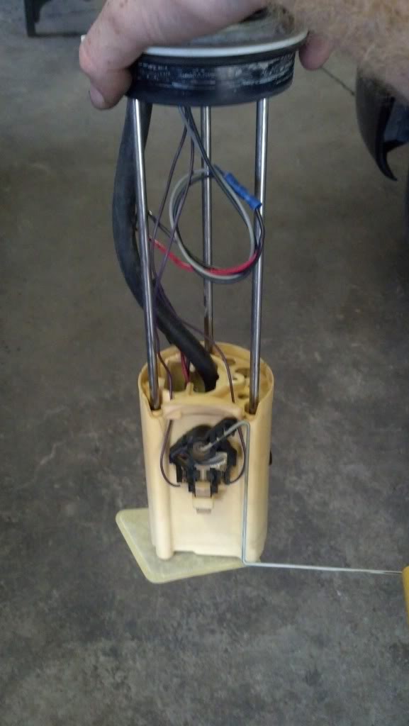

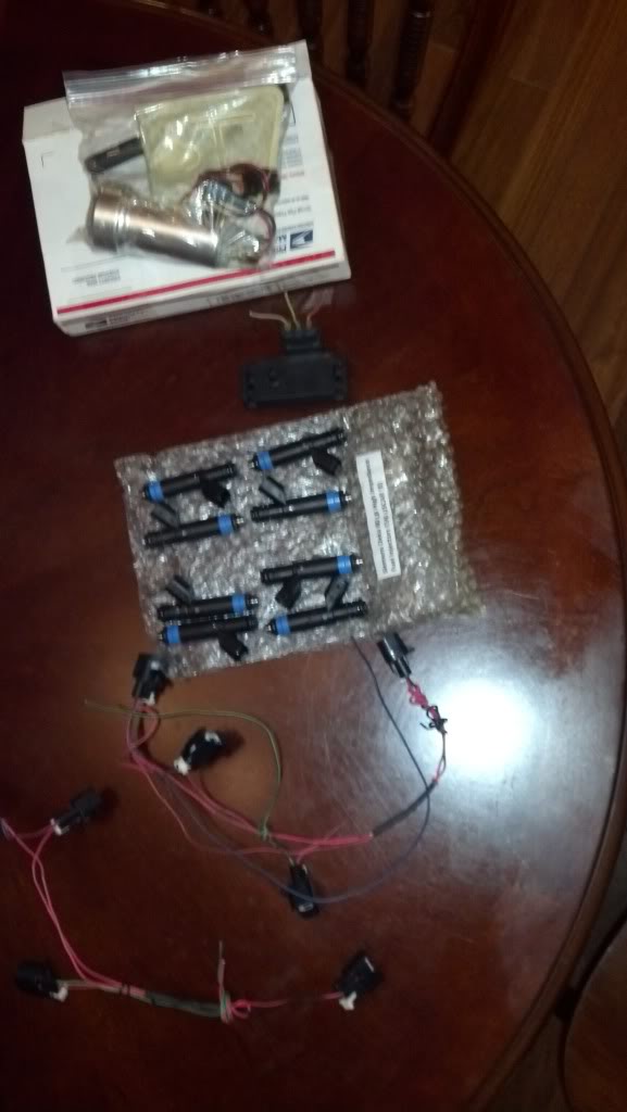

Walbro 400, deka 80s, 3 bar map, ev6 pig tails
Got the 400 in, but forgot the safety clip on the inside of the pump bucket. Where it hold the connector to the bulkhead on the top. I'll have to fix it tomorrow.

Injectors, map, and tuning to be done soon
