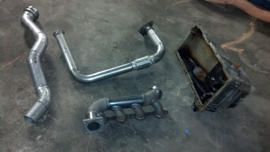

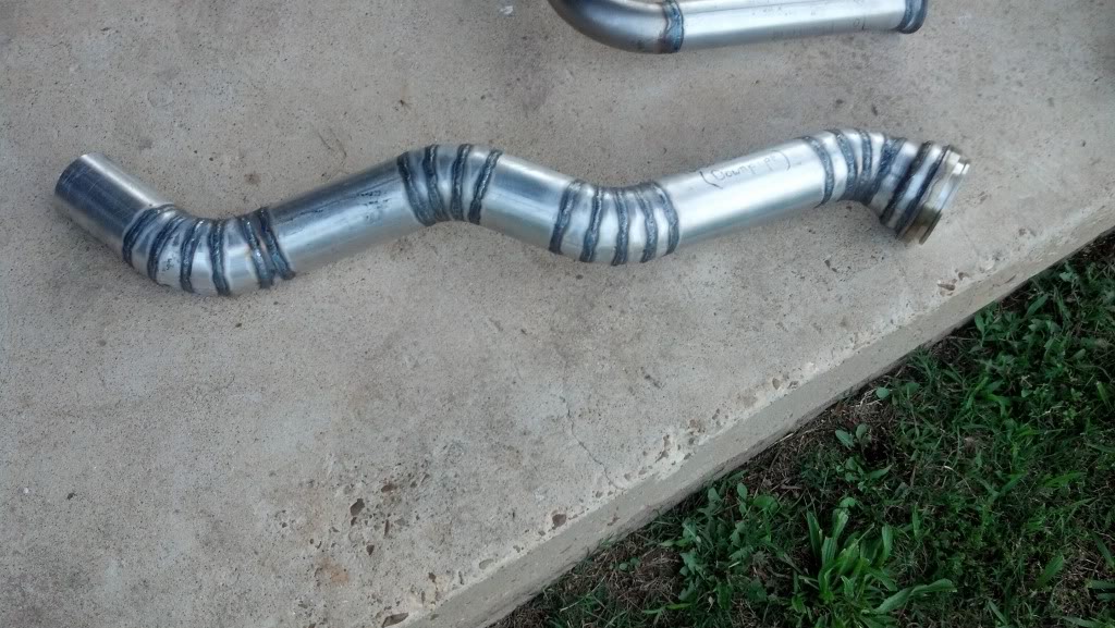

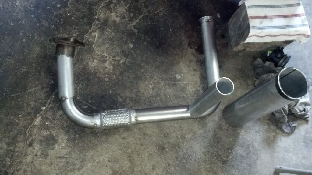

Got everything tacked up, its going to the welder tomorrow. Still have to plumb in the waste gate and o2 bungs, but I'll do that later. The welder was available tomorrow, so I'm just going to send it as is. Never again will I make pie cuts for something. I will just buy the bends the next time. I've prlly got 10hours in the downpipe.

Looks great!!! What did you cut the pipe with?
Thanks.
Old May 24, 2013 | 12:16 AM
  #44
kelsey_canard's Avatar
Joined: Nov 2010
Posts: 959
From: Arkansas
Thanks.
Thanks man. I cut it with a 4 inch grinder and a bunch of patience. Never again

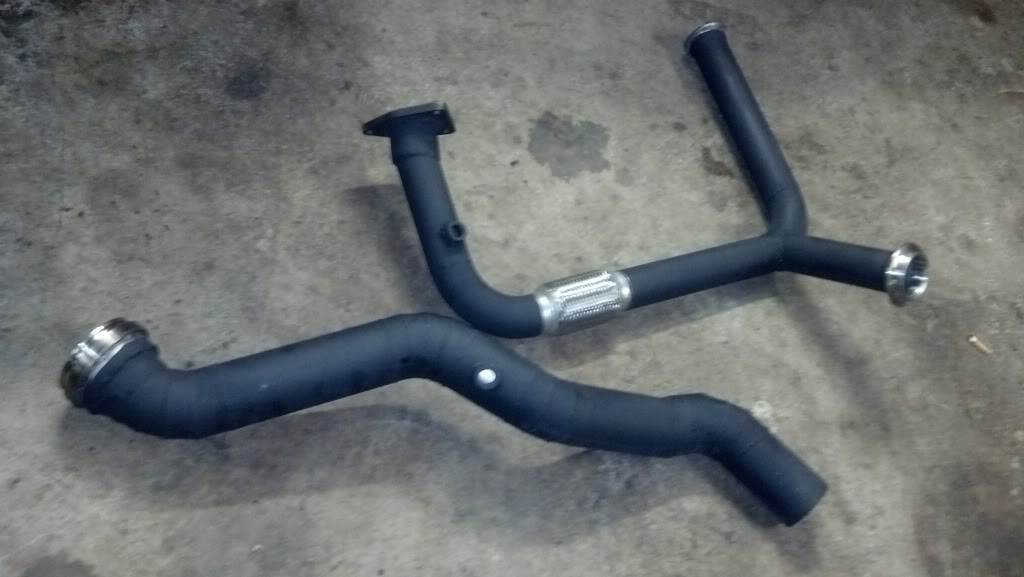

A little update. Got my waste gate plumbed, exhaust made, and o2 bungs in. Waiting on an oil dipstic tube from gm. Also picked up a walbro 400 from a member here. I did paint my hotpipes with some BBQ grill paint.

Another little update:
Got set back from my previous startup date, because I broke my oil dipstick. Should have one from the junkyard this afternoon. I'm going to jump on everything tonight. I'm a little worried about my waste gate dragging. Its above the tranny cross member, but I'm afraid it might drag on gravel or something of the like. Any ideas would be welcome. I'm kind of thinking about building a skid plate.
