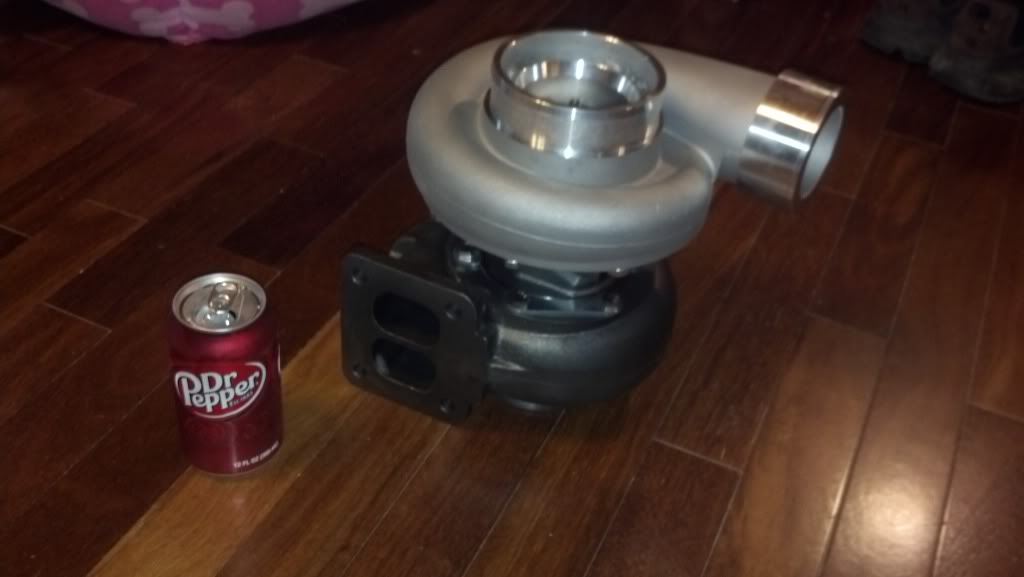

Got it tore down the best I could. Got the oil pan off to be fitted for the oil drain. I'm probably going to take it to my welder to have a bung welded up. Also got the headers/exhaust off and the turbo sitting in there. Still undeceided on final placement. I plan on running the hotpipes similar to what 03rcsb did on his home grown boost build. Heres some pics:
Oh, the ridiculious expensive turbo

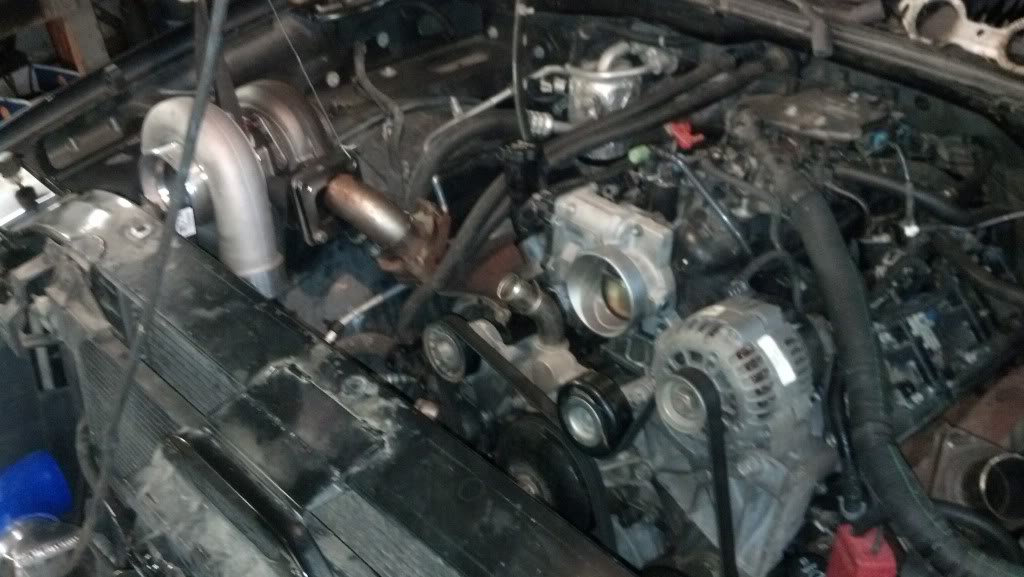

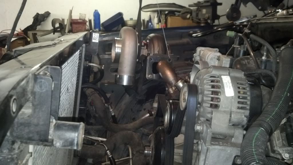

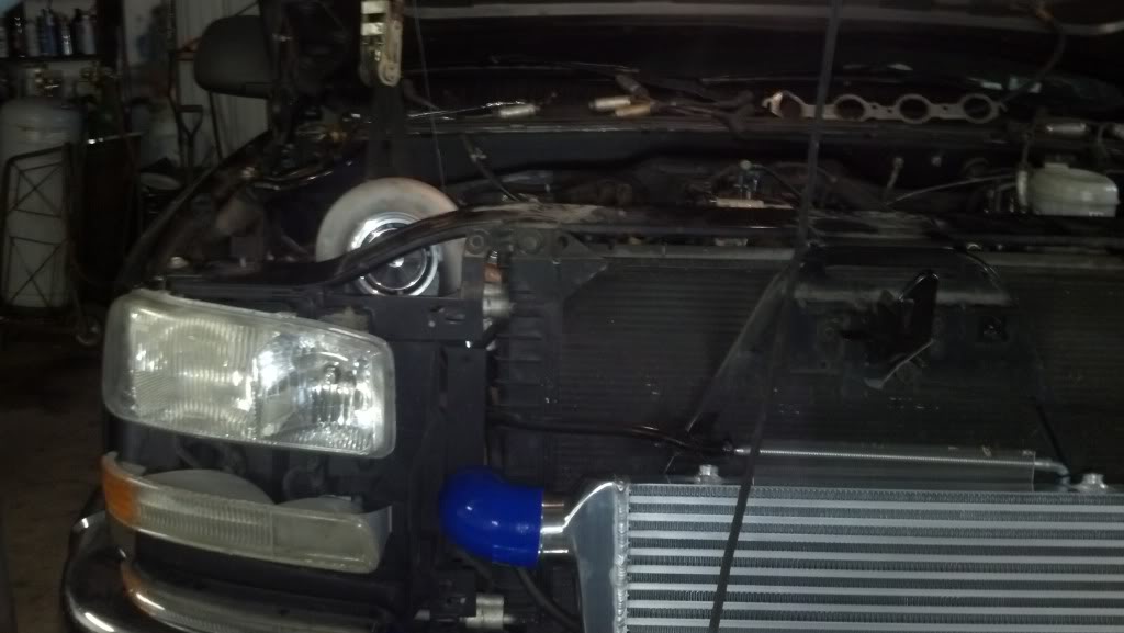

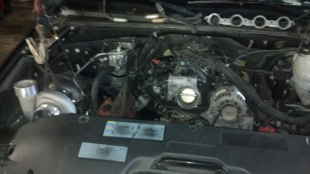

Well I'm running into a few fittmemt problems with the gt45.
PARTS UPDATE:
Intercooler arrived as did my silicon coupler for the throttle body. I'm still in need of oil lines and a weld in bung for my oil pan. Anyone know any inexpensive options for this?
I guess I underestimated the size of the gt45 compared to mp70. I cant fit it under the hood with the turbo being any above the manifold. I may just have to man up and spend the coin on the kbracing log. It would save me from having to buy efans, plug wires, and having to relocate my overflow.

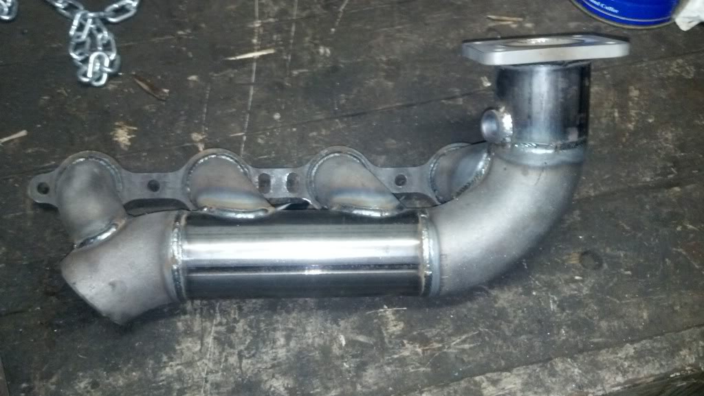

[Got the KB manifold in. This is an excellent piece.
Also got my crossover tacked up. I went with 2.25 because I wanted the most ground clearance I could get since my truck drags on everything. I also offset the flex pipe so I could tuck the crossover up closer to my dust shield. Got the pipe coped for the waste gate, but I'm going to wait until I get my downpipe built before I put the waste gate in its final location.
