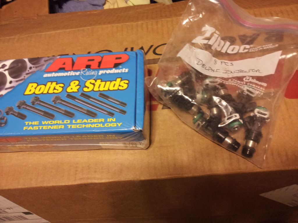

I have gotten a few goodies in so far
Haven't ordered any of the small goodies, because the girlfriend said she wants to get it for christmas
Geoff at EPS had spec'd me a 230/234.607/609 112+4 for the 370,and went that way. Orders been placed about 2 weeks now, no rush.
