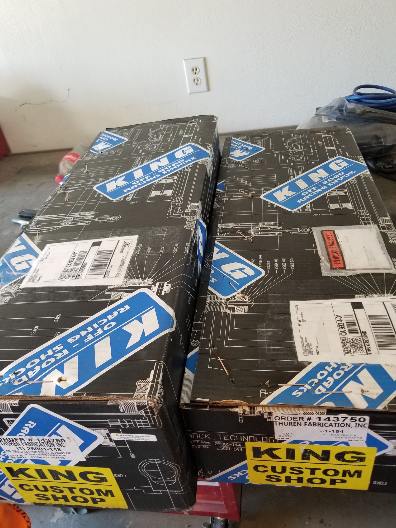

Dont know if Christmas is early or late, but these came in the other day
hope to install today after work

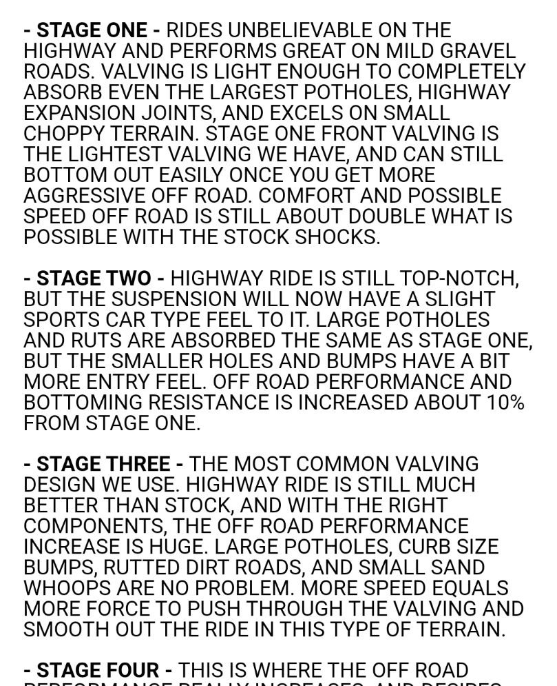

Installed front and rear. Excited to test out.
Install was stupid easy. Took 1½ hour, hardest part was getting stock spring out since it had the 2" spacer. Worked out well since these are built with a 2" lift also, I took measurements before and after I installed and drove it a min. 1 side was 1/16 higher.
I went with the stage 2 but they go all the way up to a stage 6. I do worry a bit that I should have went with a stage 1 though.

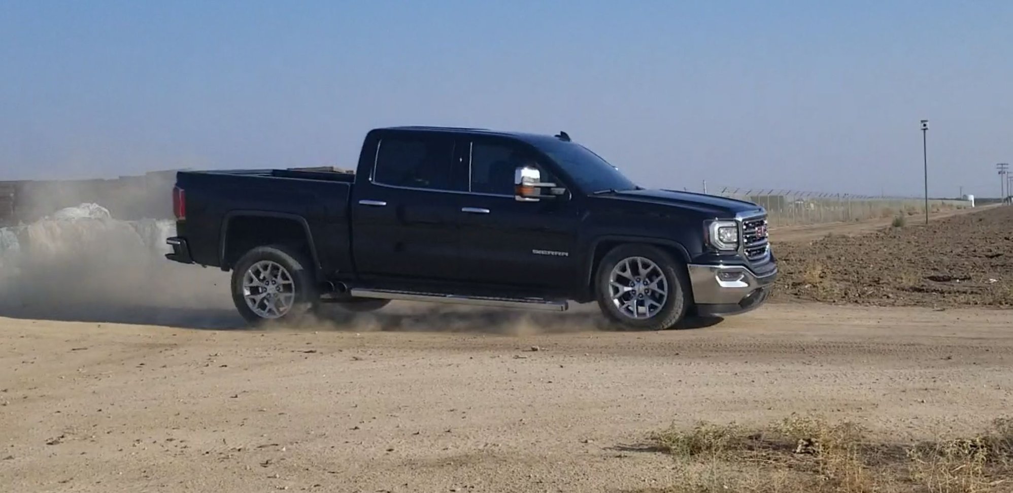

From: So Cal
Little back road roller going about 40mph. Now I really need to get a video of going over the railroad tracks.

Originally Posted by tjmath
Probably only get like 8" of air really tho lol.
Probably only 8"?!? Lol. I will have to see if I can get someone to record over the RR tracks.
Originally Posted by arthursc2
Needs a tube bumper with a bikini plate if you're keep mobbing like that!
How did she feel in the dirt and in the air? Happy with the valving or wish you had done something different?
No tube bumper, only messing around. It's not a parking lot princess but I dont plan to be too stupid with it.
The valving seems good too me. I work and live on a farm and do a far amount of driving, so it has worked out great for me so far. If I was to get more off road or desert I would have definitely wished I gone to a stage 3 or maybe 4.
I do have a video that I took those clips from. It almost looks boring, you cant even see coming off the ground or the landing. In the cab was even smoother. Once I get a few clips I'll make a short video.
