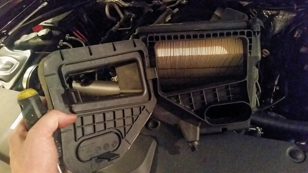

Been doing this set up for the guys that want a little more bump without spending $$$. Replace oem filter with green filter or k&n and then do this mod. Very easy and MUCH more air coming in.
Remove stock intake box and you have this small entry for air flow
get a screwdriver and pop off the front lidName:  20160331_205218.jpg
Then your left with this and you can see how much is blocked off on cover and box.

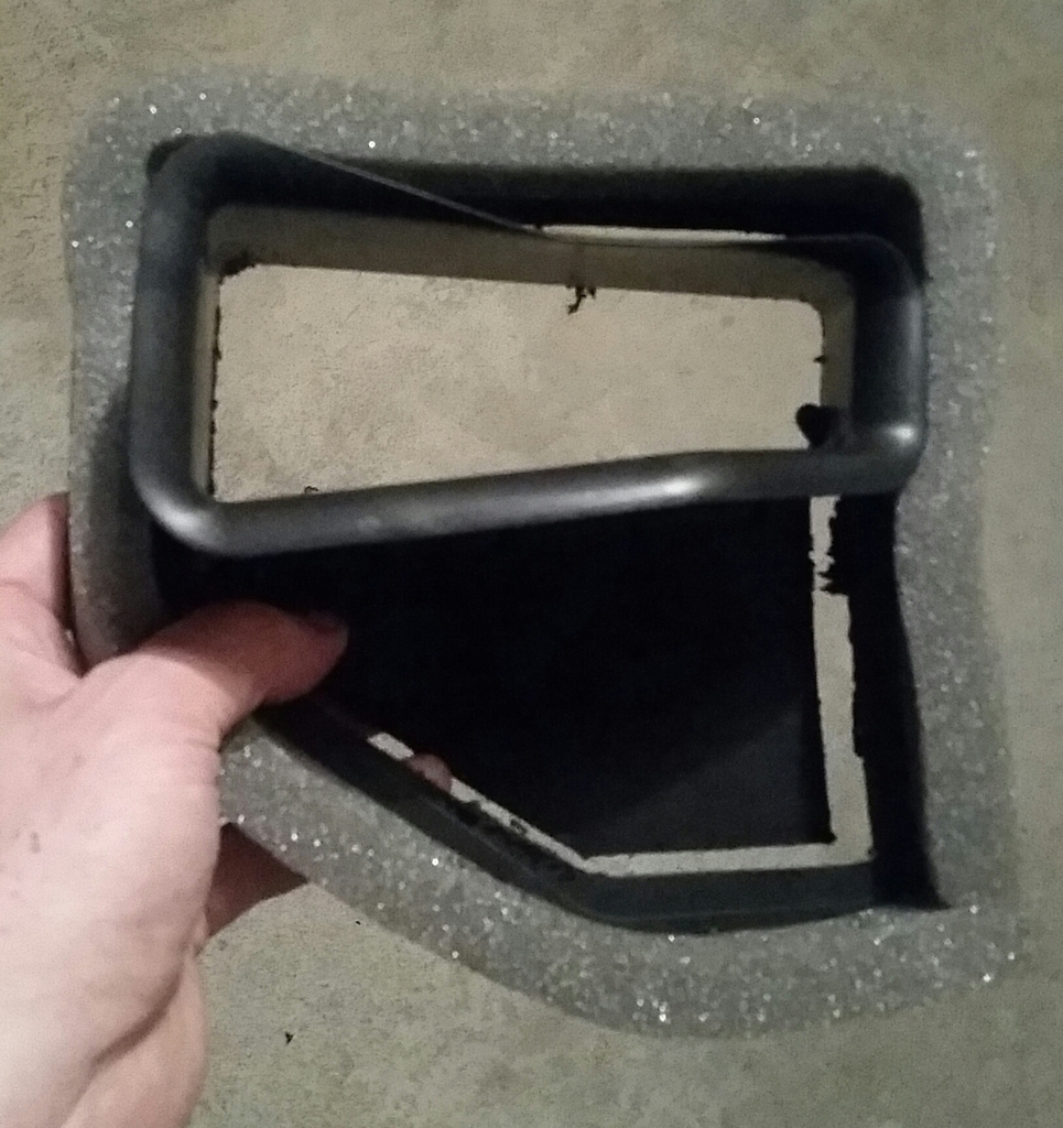

4 inch cut off wheel cut the cover but do not cut the locking tabs on it

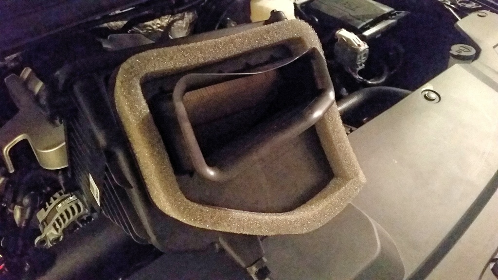

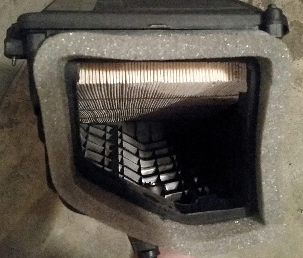

Left with this. Ill clean it up with a dremmel
cut the box plastic and then clip the cover back on

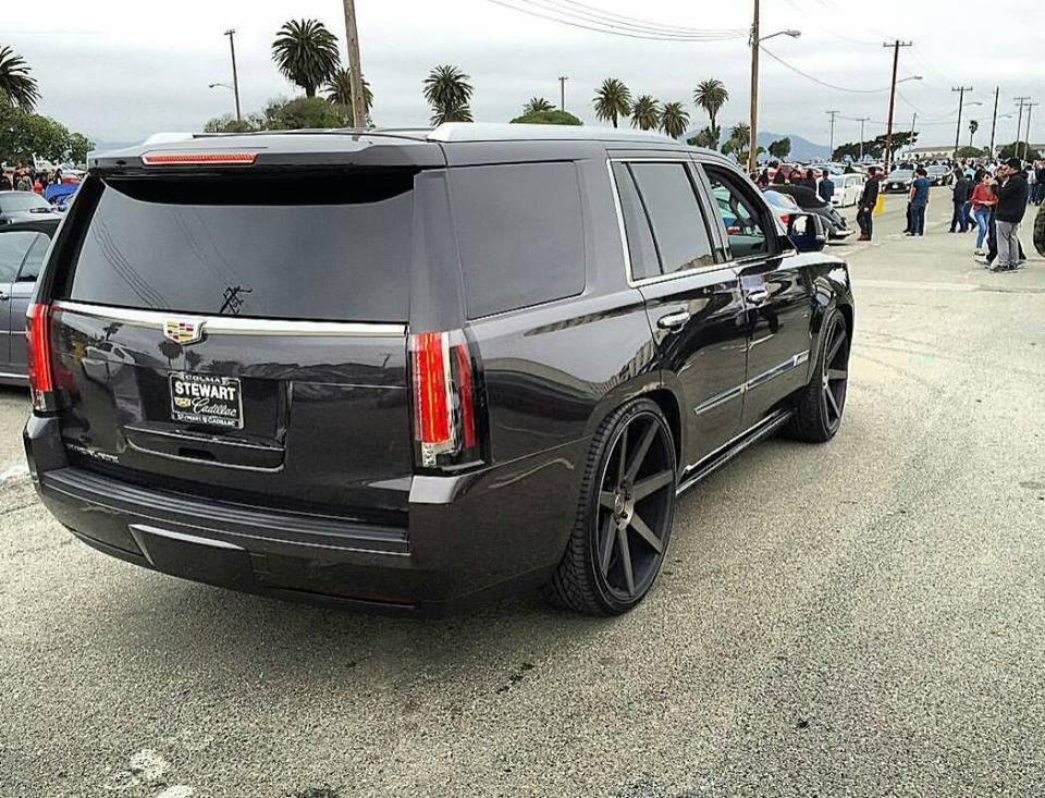

shot from cars and coffee yesterday. I do like the wrapped rear lights

Old Apr 3, 2016 | 08:04 PM
  #67
zeake's Avatar
Posts: 924
Jesus that looks amazing. I need to work harder. . . .Really. well done sir

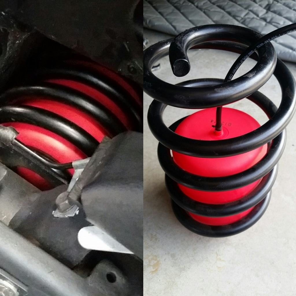

Time to get the suspension ready for the BIG WHIPPLE 2.9 and got the helper bags in rear going. My custom 6 inch springs
