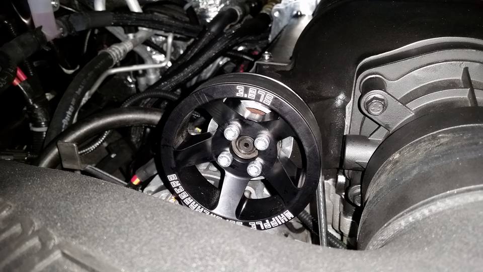

let the fun begin. 3.875 pulley/z06 pump/fuel line upgrade all in. Dyno friday hoping gains 15 at wheels we shall see. BLower is louder for sure now

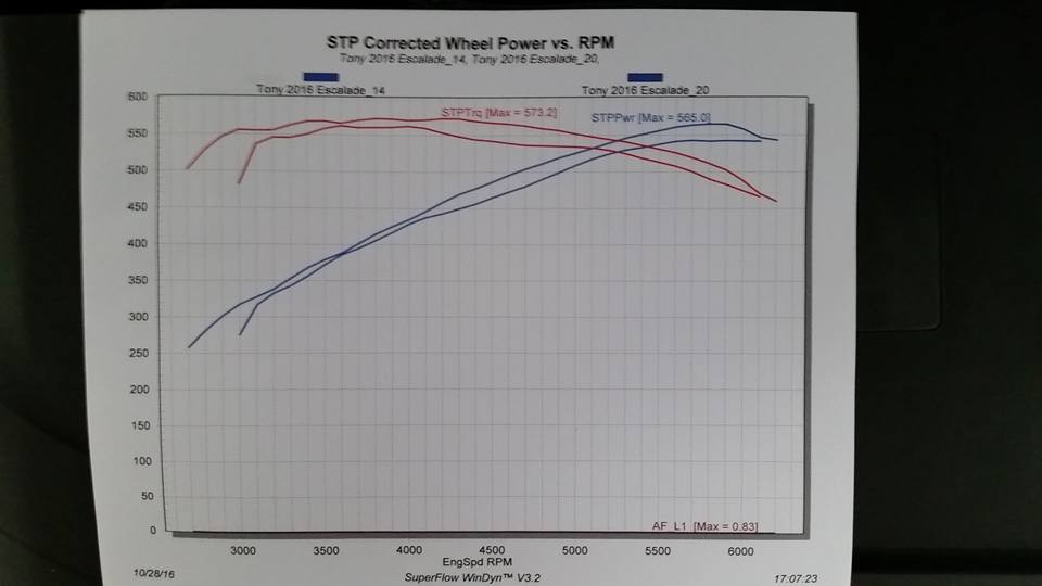

WELLLLLLLL my Whipple 2.9 Escalade making more power Very happy with numbers. 7.5 psi/91 pump gas/ARH Headers/3.5 MagnaFlow cat back/z06 fuel pump/fuel line mod and a gptuning tune. 565/573. Old run was 543/566 with 6.5 psi. What peak numbers don't show is mid to top end 20 to 30 rwhp/rwtq increase. We let off the run early that's the dip at end.
I have a meth kit coming. Goal is 600/600 at wheels at 7.5 psi with no internal mods....on 26s lol
I'm almost done with this project and its been fun.
