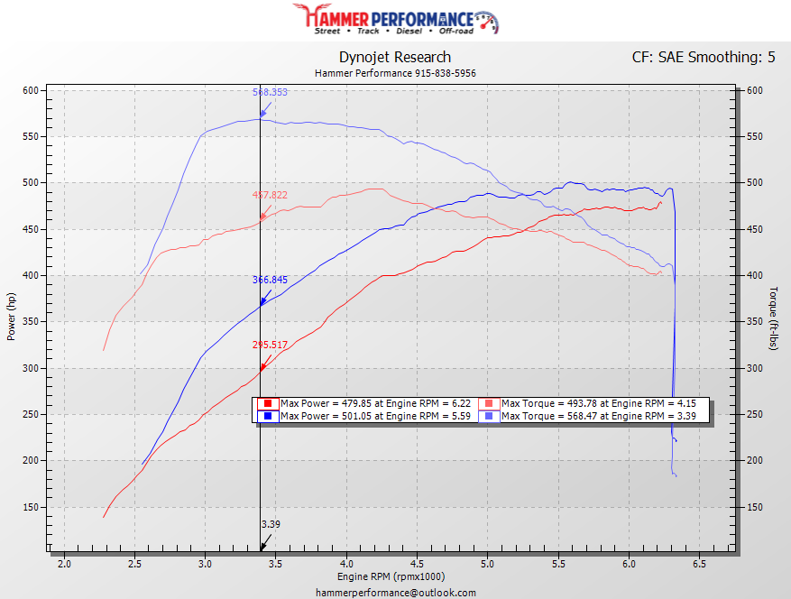

I lawed down 501rwhp/568rwtq with an e-force 2300,headers, high flow cats and stock catback. Only @ 7 psi, uncorrected numbers With an almost 7000DA.
Cool what it do before?
Old May 7, 2016 | 05:00 PM
  #86
TVS/HC's Avatar
Joined: Sep 2015
Posts: 53
The before was with headers, 3.5 blower pulley, and the canned tune from Edelbrock E-Force. After is with headers, high flow cats, 3.25 pulley and custom tune....stock air box,stock cat-back exhaust and these are uncorrected numbers with a density altitude of over 6500'.
What was pretty blower numbers sorry I should have specified
Not sure what ya mean. Typo I'm guessing. After was with 7psi
