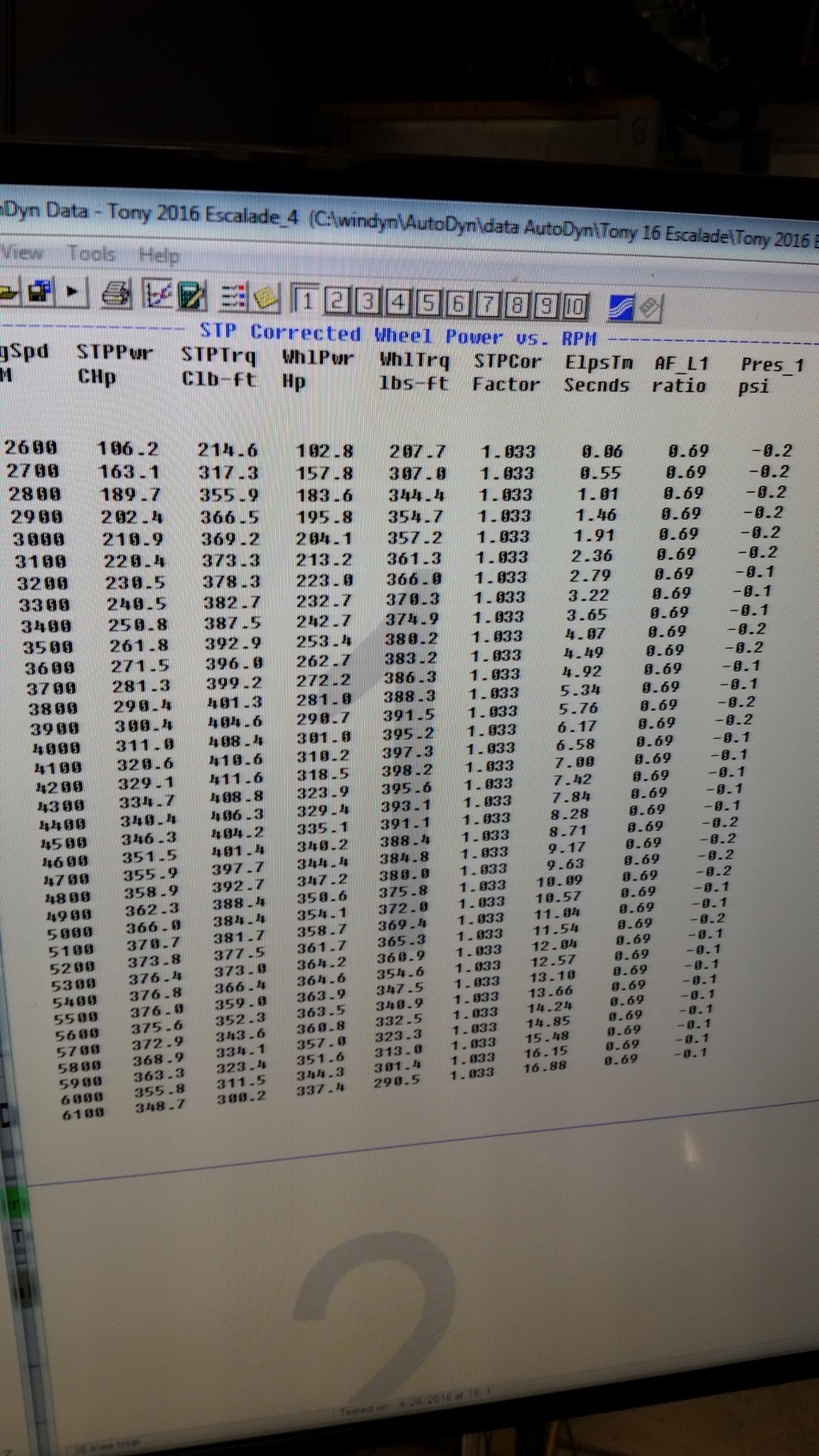

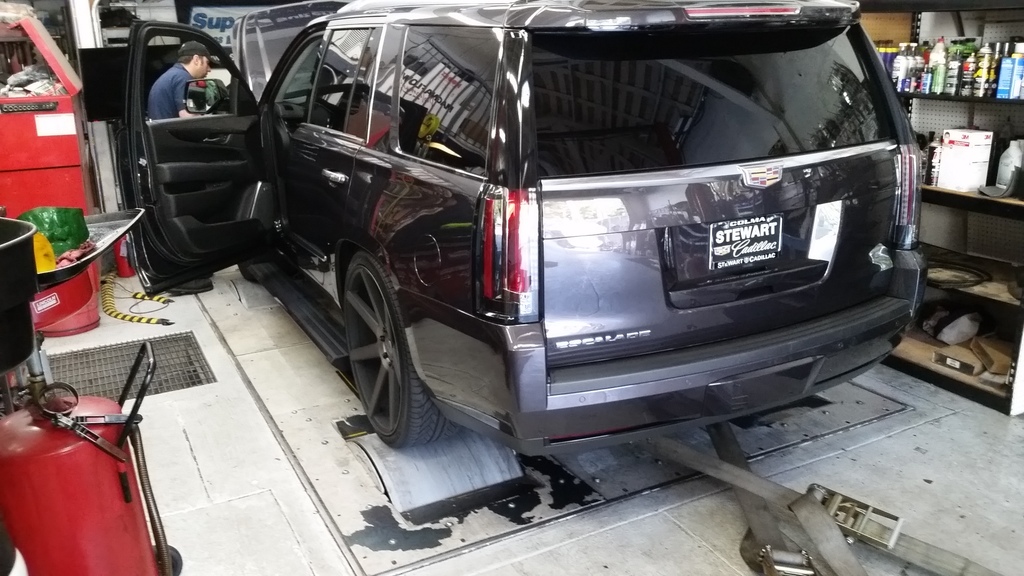

I ended up taking my escalade in to get pre WHIPPLE Supercharger numbers.
2016 ESCALADE
STOCK TUNE
5TH GEAR PULL
AFE INTAKE
MAGNAFLOW 3.5 CAT BACK
376 rwhp/411 rwtq
Did 3 other pulls and they were all 1 to 2 hp away from above results so consistant baseline
I'm very happy with the results. Stock 15 escalade dynoed 331/359 2 weeks ago which customer also bought a whipple kit from me so he wanted before/after numbers
I took time off work on the 8th so I'll be installing the blower. I'M AMPED. If truck makes 500/500 I'll be happy

And with the big *** wheels on there too.......
I am assuming the intake and exhaust help it breath a ton better over stock. Really good numbers for sure! If that Whipple won't make 124/89 you can send it to me

The 26s are lighter them the 22s.
I'm sure 91 tune they send is really safe. We will get a baseline then tune it and see how much more we get. I'll prob do a 10 psi pulley

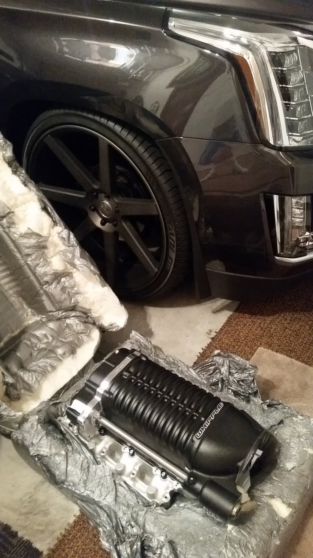

opened box 2 and one of the main reasons i ended up getting this kit was the 4.5 gallon hx tank they give you with the kit

How did you get it to go to redline without the computer enabling TCS or Stabiltrak? What kind of dyno was that?
