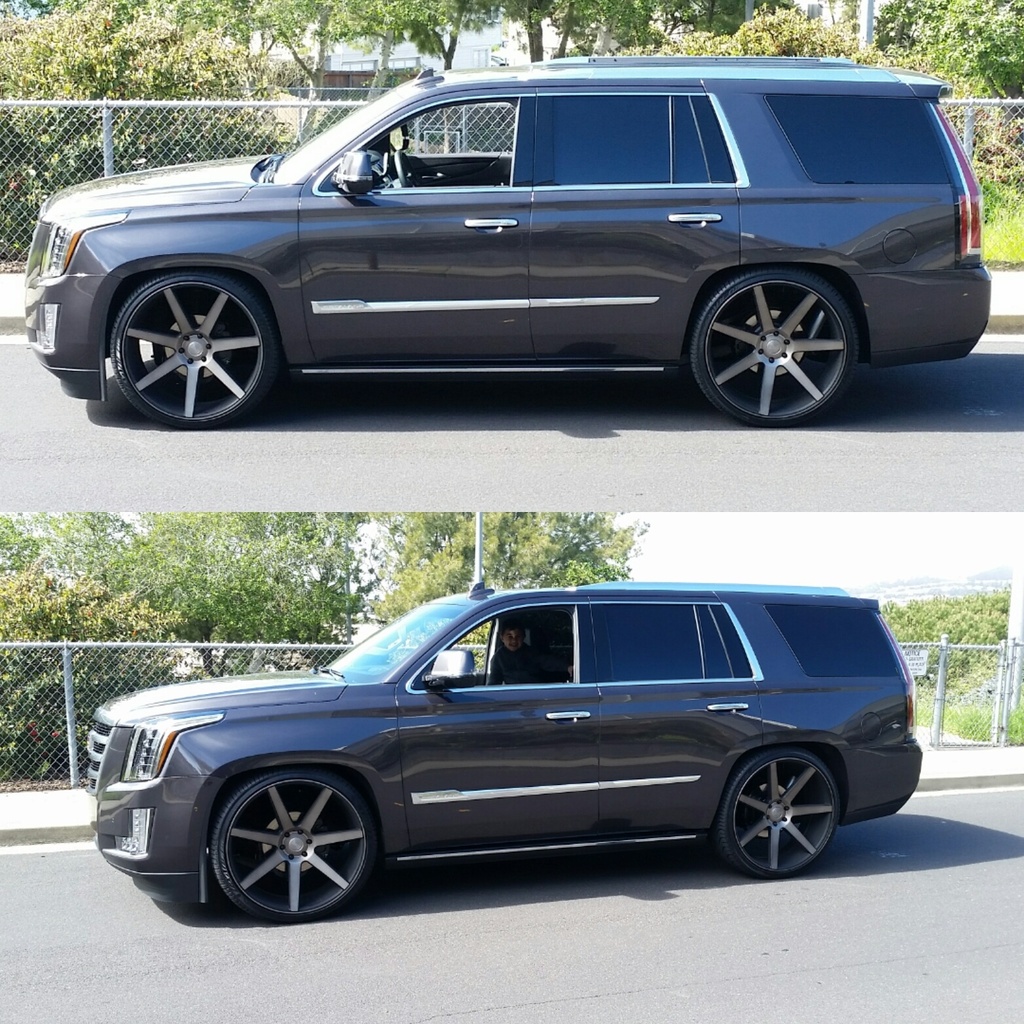

Bypassed rear autoride and replaced with belltech sp shocks. Truck came down perfect. Mated with my custom 6" springs rides smoother in rear then autoride shocks did. Front 33.25 ground to fenderlip and rear 33 5/8 ground to fenderlip on 295 30 26. DONE!! NORCAL SS has the lowest kit out for all 2015 gm suvs.

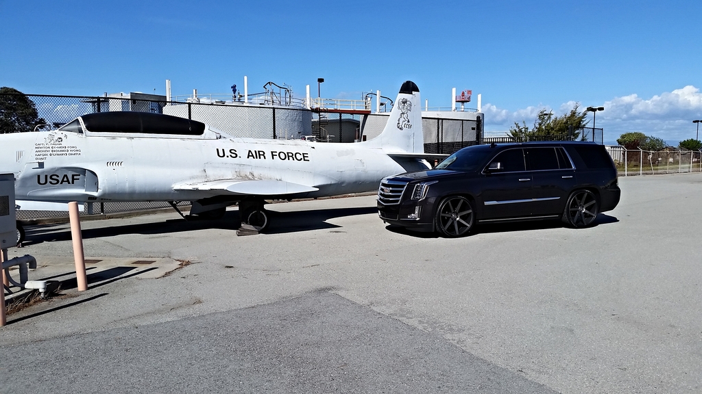

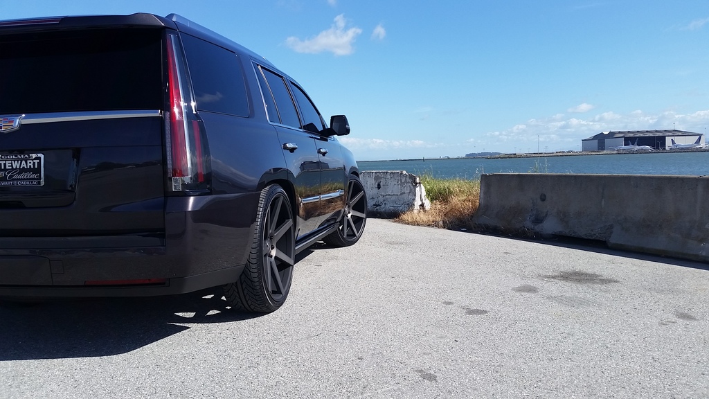

Few pics from today

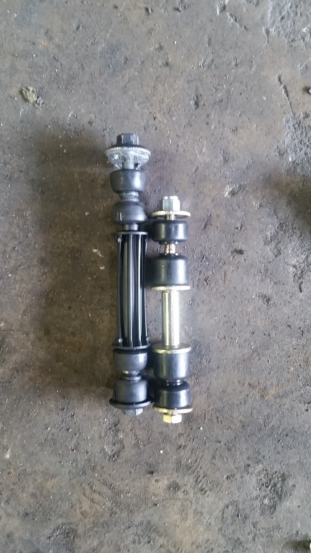

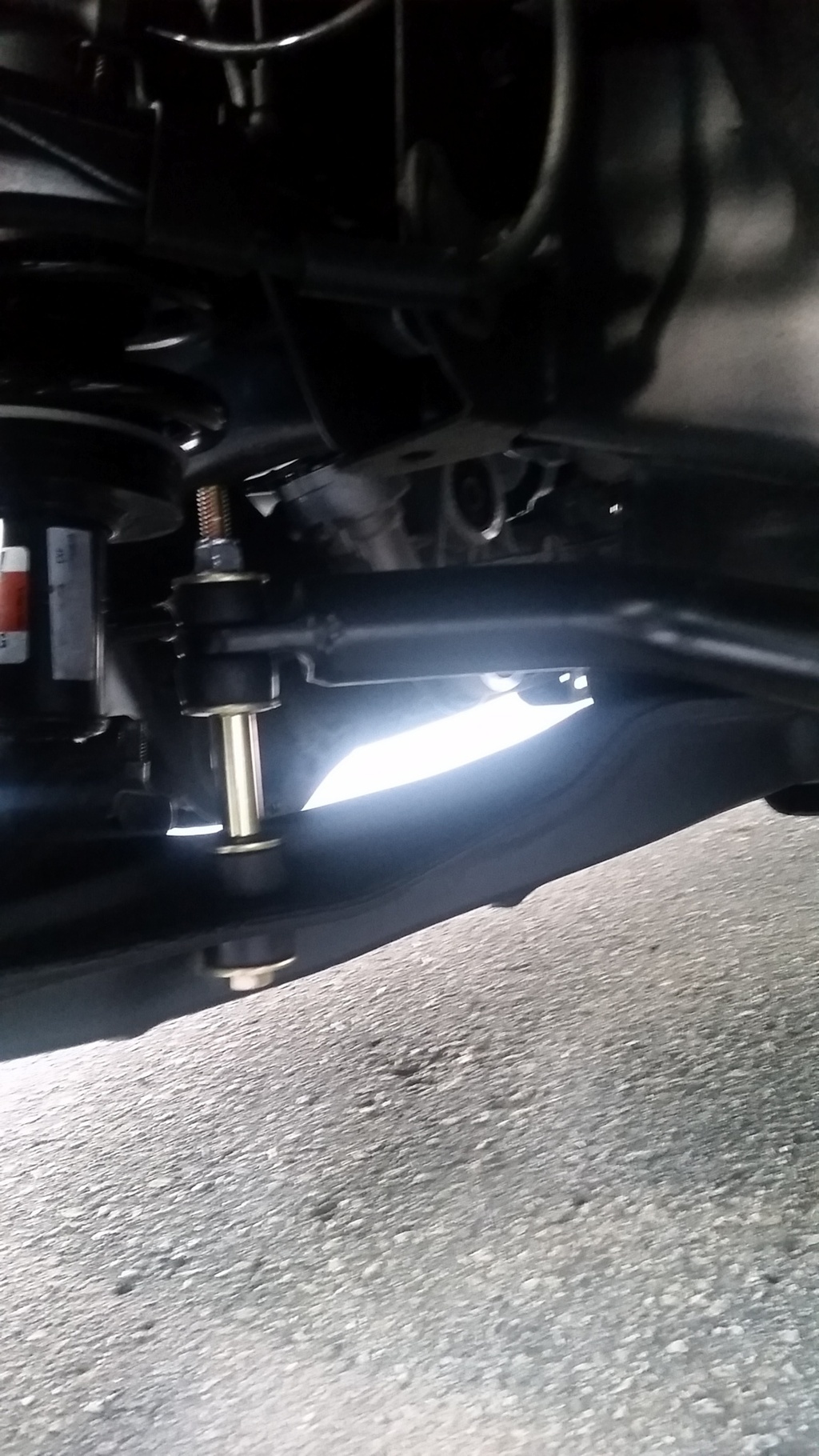

Swaybar was pointing up way to much and ended up getting the energy suspension endlinks. These are adjustable so also a great mod for the 08 up tbss guys here. Installed and very happy with results. Front end feels much more planted due to the endlinks and swaybar being parallel with ground
stock vs new one

Parallel with ground now

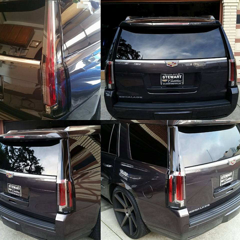

got the lights wrapped. Doesn't look to bad. Ill prob paint to match down the road.
