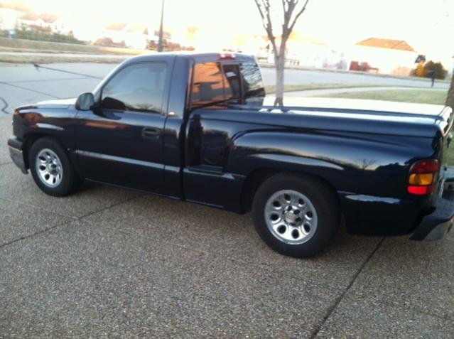

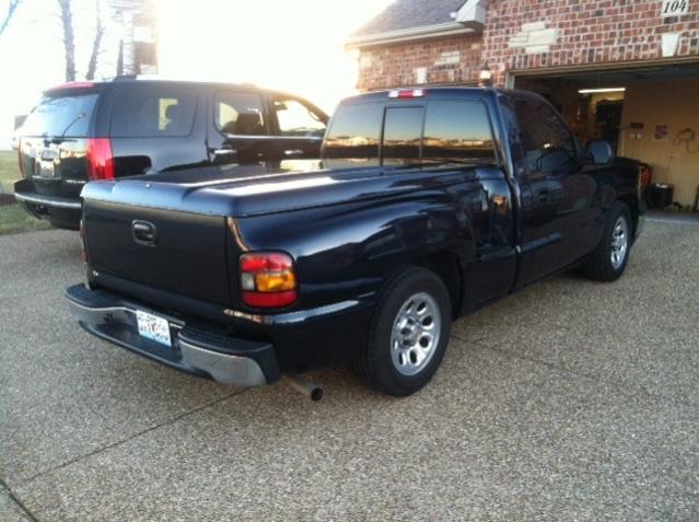

Starting a Build thread for my 2005 Silverado 4.8 RCSB. Picked it up from a buddy that had it on his lot in December with 98k miles. First pic is what it looked like when I got it home.

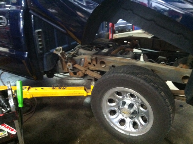

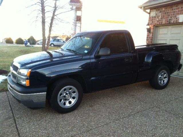

Figured I would Update some photos after this weekend. Friday I was able to lower the truck and get it realigned.

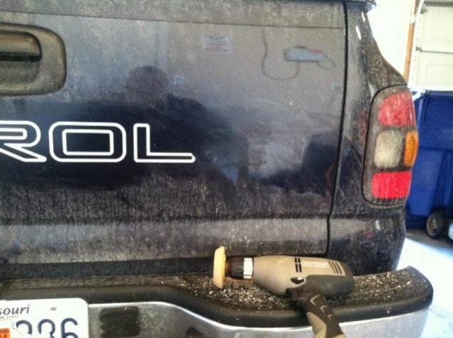

I also spent a few hours today with an eraser wheel, buffing and wax to get rid of the worn out pinstripe and chevy decal.
This week I hope to have my fuel system ordered and a new front bumper to replace the bent one.

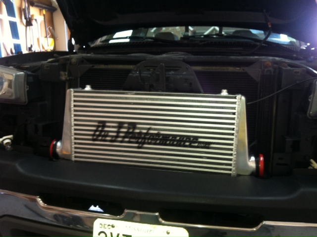

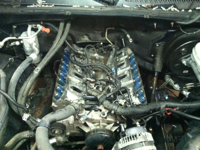

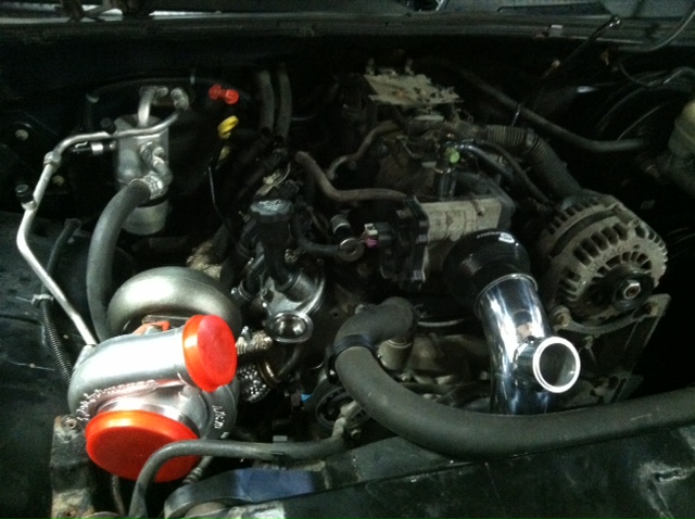

Haven't Posted any pictures but the past two days I got quite a bit of work done. I hope to eventually get a parts lists on here so that anyone searching a build like mine will know what a "bolt on" kit takes to "bolt on". I'm no where near complete, I still got a laundry list of things to do, but I hope to have that hashed out by this week sometime and then off for a tune where we can learn of more fun "bolt on" things. I definitely needed the help of my FSMT friend and his lift tools/expertise to tackle this in a timely manner.
Here's what I've done the past two days:
Felpro MLS head gaskets, ARP head bolts, LS6 springs, ARP manifold bolts, felpro manifold gaskets, NGK TR6 plugs (yes you can put them in with the On3 turbo manifold), On3 70mm turbo kit with WG, BOV, FMIC and all hot cold pipes *even though Chad NEVER answered my requests for pics of cold kits*, Sealed Catch can with check valve, Down pipe and exhaust connected, heater lines extended, oil return/in.
Lessons learned with the On3 kit installation:
1. No instructions/Pictures other than what is here on pt.
2. Front mount brackets need to be rebuilt, unusable. FMIC sits too high.

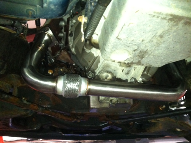

3. WG is a PITA to connect to the recirculated downpipe, seems to be about 1/2" off, we eventually got it to connect by loosening everything up and prying up on the downpipe from beneath.
4. Downpipe HAS to be cut, no way that thing would work without it, needs to be changed.
5. Yes, You can change plugs on On3 manifold, but you can not use stock length LS wires, they touch, will build custom length with 90* boot and go around manifold.
Once I get it tuned and running then I'll give a pro's and con's I think its still too early to measure.
Whats left for me: Fuel pump (dropped and broke my first one LOL) hot wire kit, coolant reservoir, TruBoost gauge/controller, Build ur own Spark plugs, sd tune, ls9 inj, MAP sensor.
*the pic of the FMIC is incorrect, we had to lower that around 3 inches and make new brackets for mounting.
Attached Thumbnails Midwest 4.8 new member project.-photo-17-.jpg   Midwest 4.8 new member project.-photo-8-.jpg   Midwest 4.8 new member project.-photo-16-.jpg   Midwest 4.8 new member project.-photo-18-.jpg   Midwest 4.8 new member project.-photo-11-.jpg
