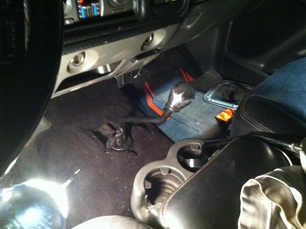

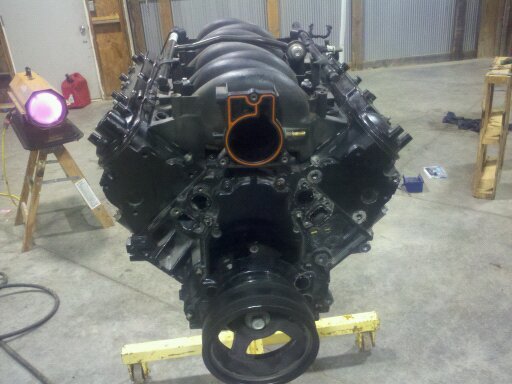

Alright, so i have a 2002 spec Ls6 5.7 with 243 heads (405hp) im running Ls1 intake though so I lost a little there. Motor has Ross forged pistons, CompCam 224/230 113 Lsa .581 .598 lift, Comp 918 Behive springs, balanced crank, and pretty much everything ARP, using truck oil pan, and truck accessories, using ls1 water pump with 3/4 spacers. Tranny is out of 02 WS6 with a Keisler front shift conversion kit installed. With the front shift conversion it sits about 3" back from where the stock 5 spd set so i get to keep my jupmseat. Bolted right up with my tranny x-member, driveshaft had to be shortened 3" from 61" down to 58" and had to swap yolks. I had to make a custom hydraulic line bc the connectors are different between the 5 spd and 6 spd. Cut both conector ends off of hydraulic line that went into tranny off of the truck line and f-body line and had a hydraulic /hose shop crimp on the f-body connector onto the truck line. Has stock 3.73's with G80, looking into Eaton Detroit TrueTrac locker. Also have Hooker Super Competition Lt's ready to installl once the electrical gets done. Still debating on what kinda exhaust to run after the headers though. Hope u guys like my setup so far, ill post more pics and vids once i get her all done.

sweet. that truck gonna be fun with that 6 speed. does the tranny already have a shirt throw shifter? what size tires are you running. you can probably get away with a 4.56 rear gear, your tires look like 31ish inches.

(Pewterliftedz)Yea it's pretty short as it is, an I got 275 45 r20's they're still stock wheels. I'm Gona buy a set of 16-17" weels and some slicks for when I run it at the track

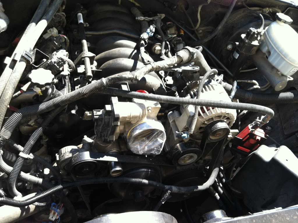

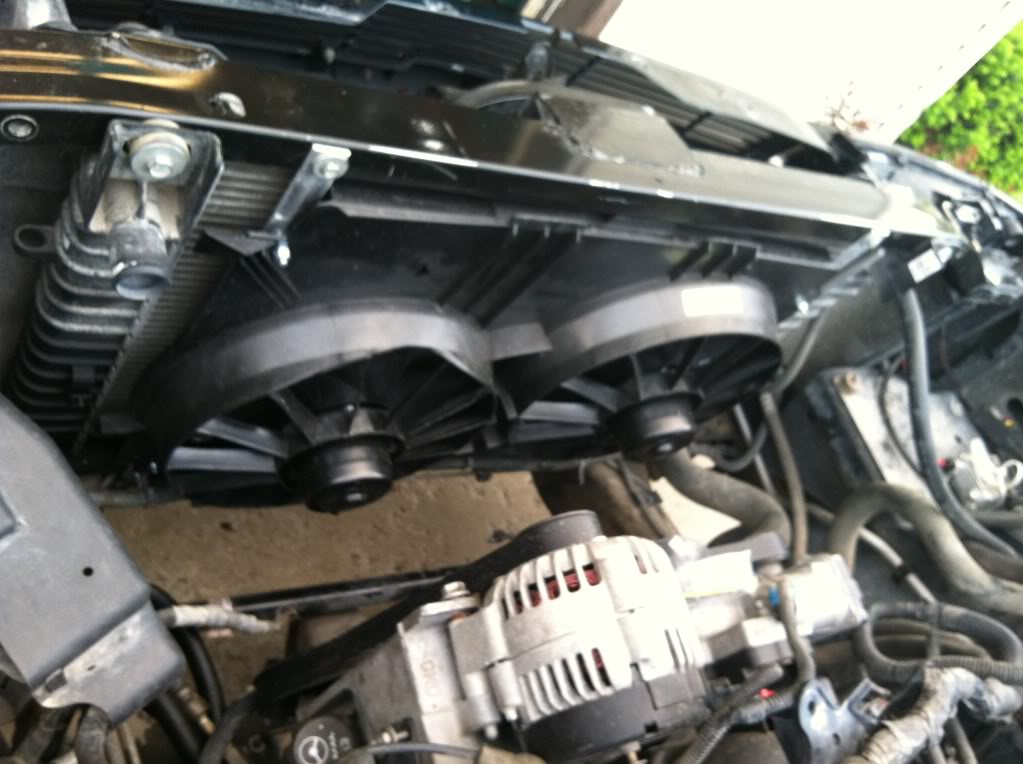

Got e-fans, idler relocation bracket, and Ls1 intake installed this weekend

Im soooo ready to have her back!!! Got everything done but electrical.. which should be done by this weekend!! Gota dress up harness to make it look nice, re-connect everything, rewire pigtails to injectors, and then tune it and its ready to go!!
