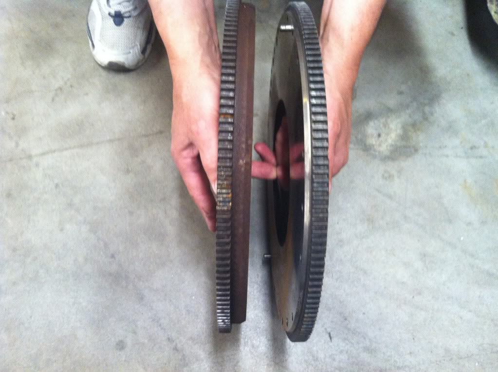

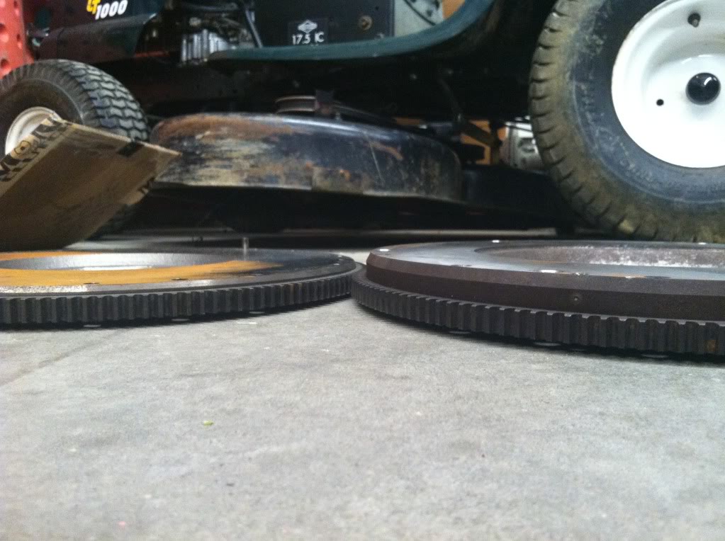

Figured it out lastnight, pulled tranny so I could see Wat the starter was doing.. For one the truck flywheel has a deeper bowl to it( about 1/4") deeper.. So my starter couldn't reach the flywheel teeth, I swapped out flywheel lastnight with Ls1 lightweight aluminum one, but it still isn't lining up all the way, it's about 1/8" off so I'm Gona try an shim the starter this weekend

Here is what my truck was doing when i try to start it
and here is the difference between flywheels
