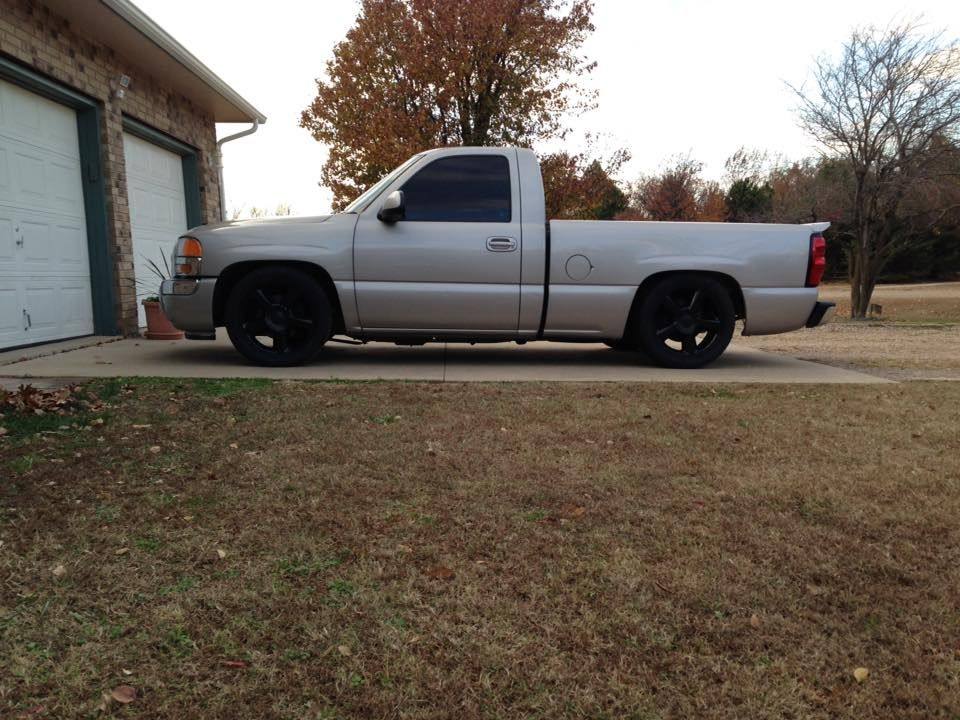

Update:
Been a long while since I've been on here to update the thread and since then there has been a few different parts gathered as well as some changes in the original plans.
First things first, I finally got some new tread on my black LTZ's and got them back on the truck, looks much better than the stockers and should hold me off until I get a set of racestars for the truck.
I really like the way the truck looks now, next on the exterior will be getting my roll pan and new front bumper painted and but on.
Now for some real updates; I was having a tough time deciding which traction bars to go with, between caltracs and assassin bars. I wasn't a fan of the metal bushing used for the leafs springs that came with the caltracs. I talked to multiple people and everyone had equally good things to say about both, so it was pretty much just personal preference. So.... I went with the assassin bars, and after 10 WEEKS, they finally showed up at my door. But it was worth the wait, directions provided in the box to help with install (if it already isn't simple enough) they seem to be very quailty made, and I look forward to putting them to the test in the spring. Don't have any poictures of them but if anyone really wants some, let me know and I can send you some.

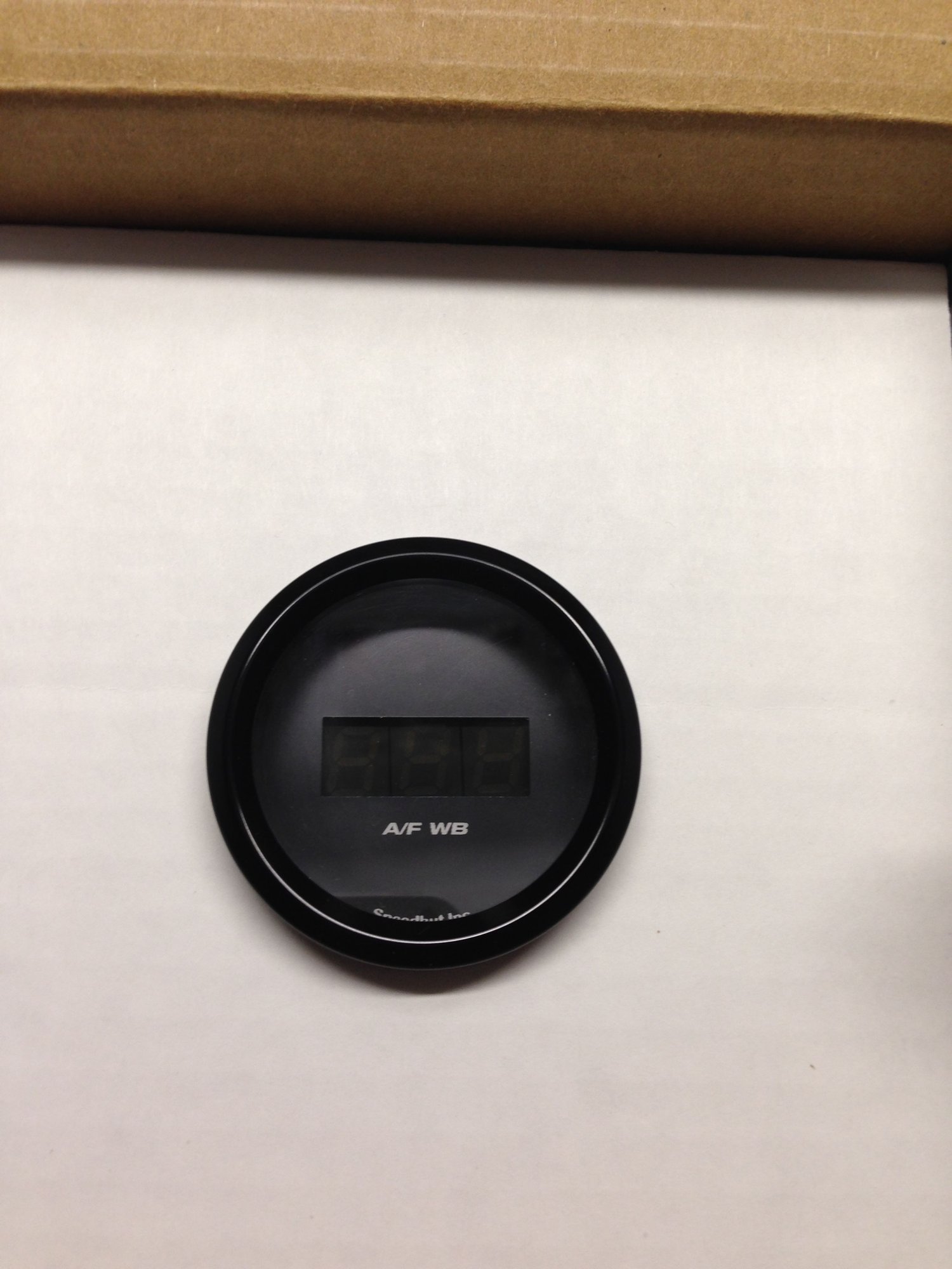

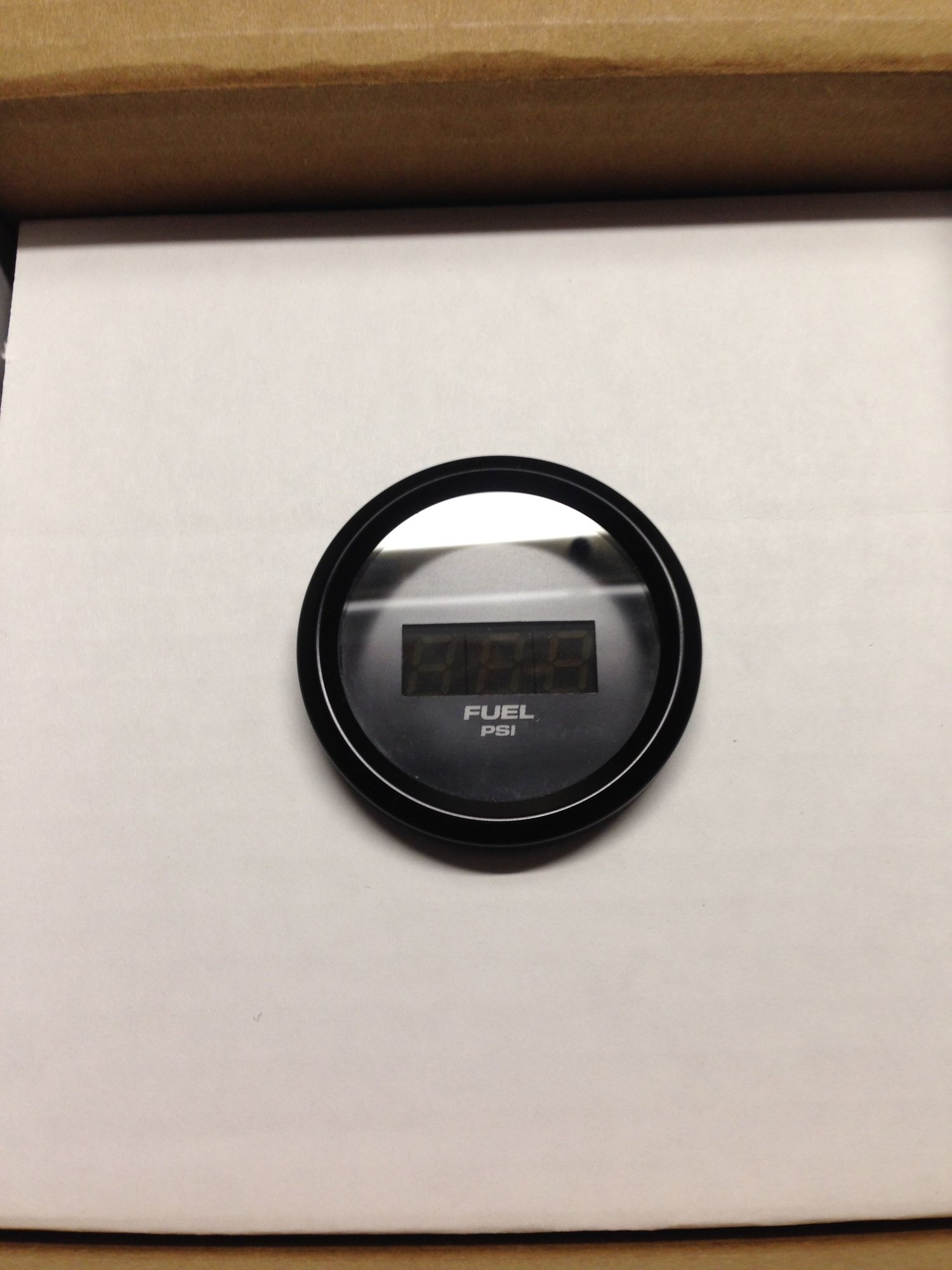

Next on the list was getting the gauges all lined out to read everything going on with the truck and I can say I am very pleased with my purchase. I went with a set of Speedhut gauges, Air/Fuel Wideband, as well as Fuel Pressure gauge. I was able to customize the gauges any way I want, so I chose all digital gauges and made them so they all glow white at night. The Speedhut wideband runs off of Innovate's wideband controller, so along with those gauges I picked up an Innovate LC-2 wideband controller.
I'll get some pictures up when everything is installed, I purchased a 3 gauge pillar pod for these gauges so I'll have two gauges in the pillar pod and my trans temp gauge in my cubby hole gauge mount.

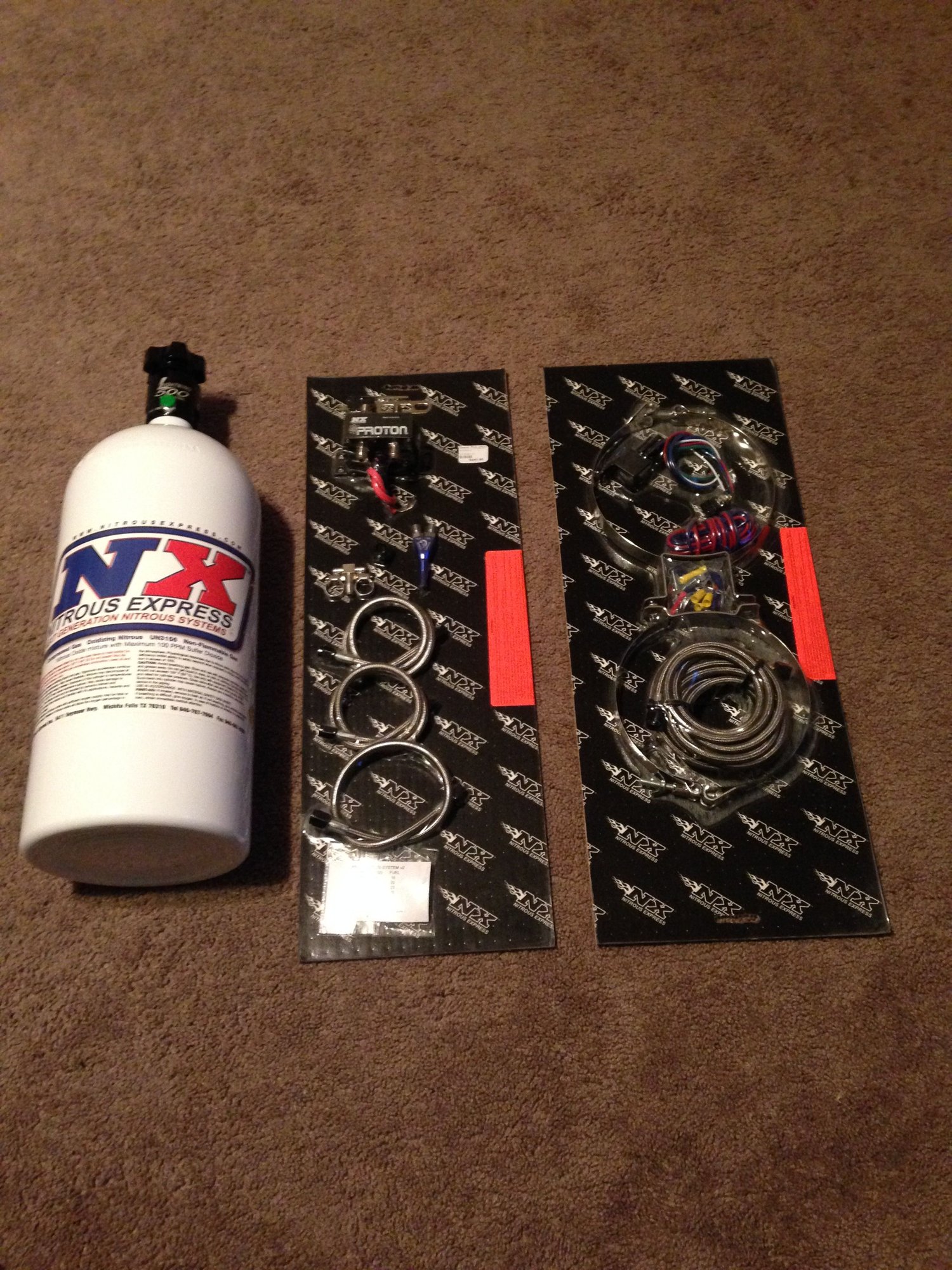

Nitrous! It's no turbo, but it will for sure do for now! Due to being in school and only working when I'm home and can I'm trying to go fast on somewhat of a budget. But really just looking forward to seeing what the truck can do on Nitrous, I would like to get a low 12- mid/high 11 out of it once I get a tranny and stall under it on 150 shot. Which I think are very realistic goals, and still plan on it being a daily driven truck.

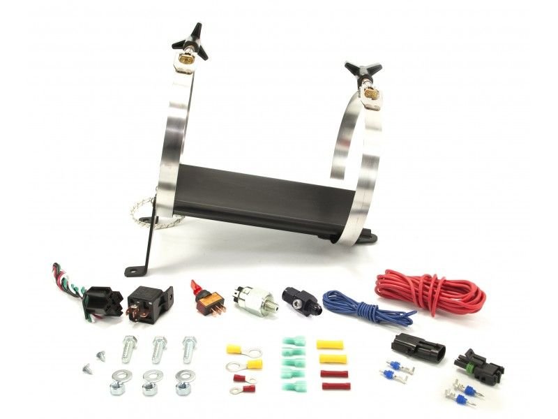

Along with the nitrous kit I have purchased everything needed to go along with it, bottle pressure gauge, and bottler heater. I went with the Nitrous Outlet bottle heater, I like how I can just set the bottle on it and don't have to wrap the bottle, just think it looks cleaner than the other heaters I can across.
I haven't ordered a purge kit and not sure I'm going to, I know some people like them to clear the line right before they run, but I've also read it's more or less for people looking to get that extra 10th of a second or less off of the line, now not saying that's 100% true, but as of right now I don't plan on using a purge kit.

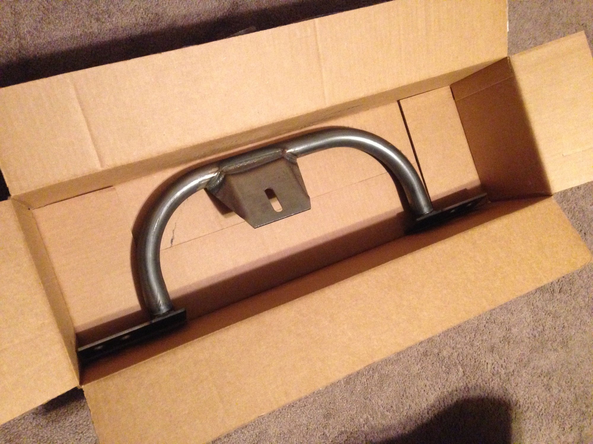

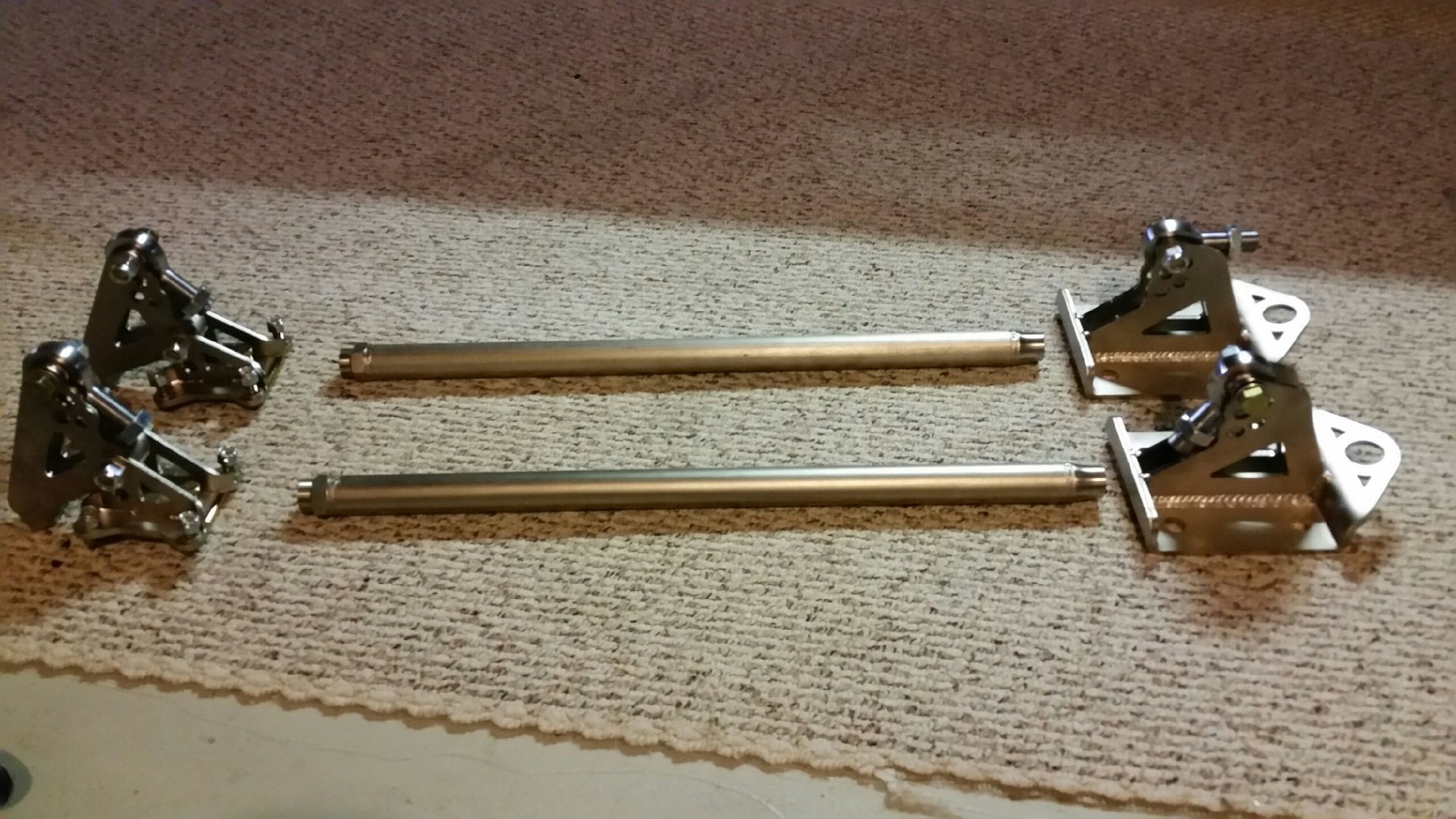

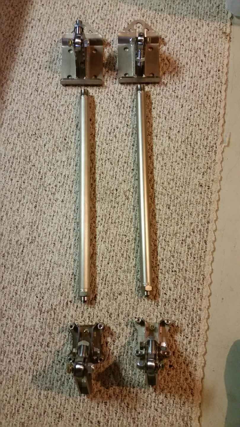

For anybody wanting any pictures of Assassin Bars..
Also got my 80e crossmember in from Dirt Track Racer, very nice piece.

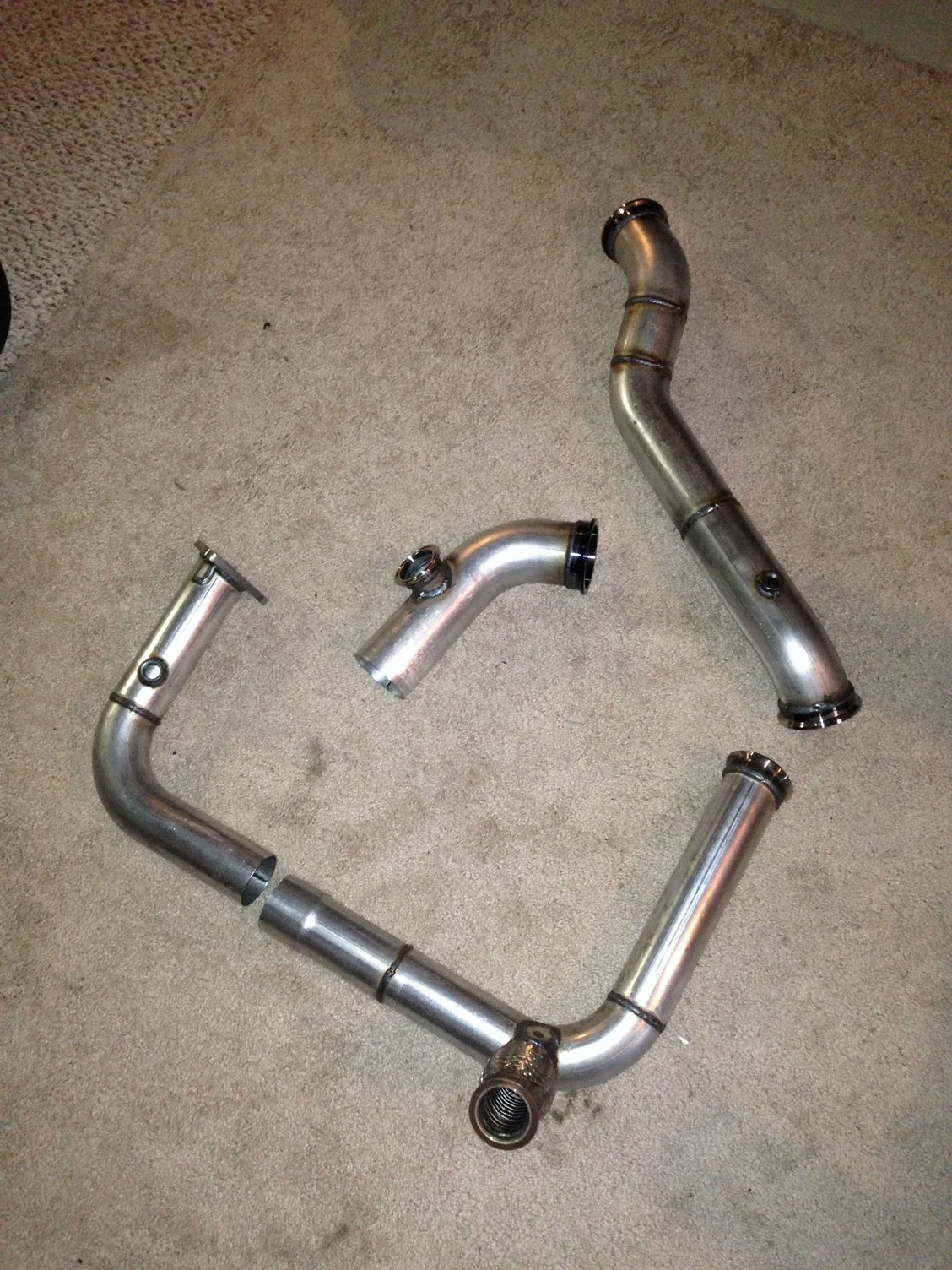

- Going to fab up my own intercooler pipes to the hot and cold side.

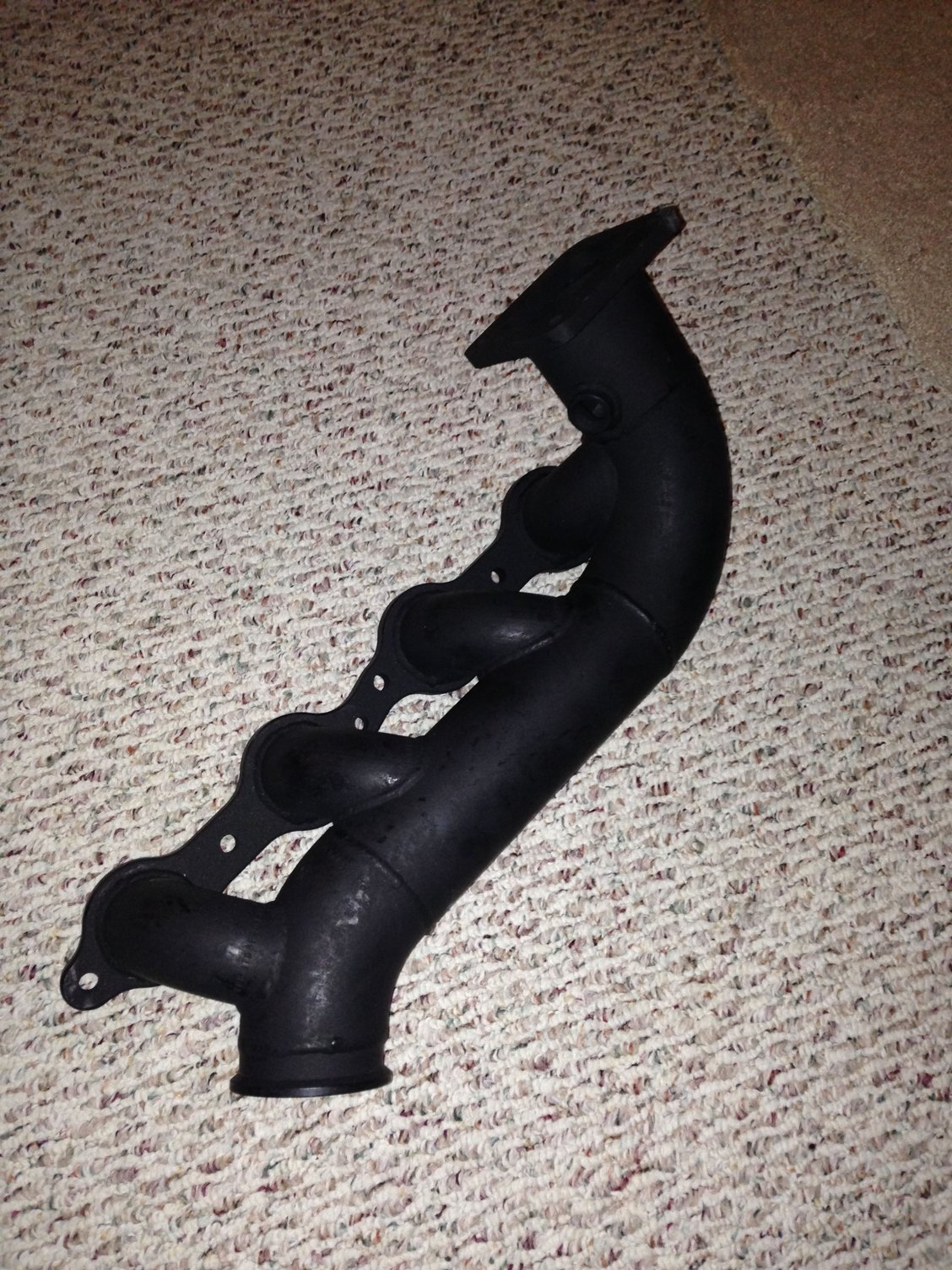

KB's hot side parts have arrived!
Log manifold is very nice.

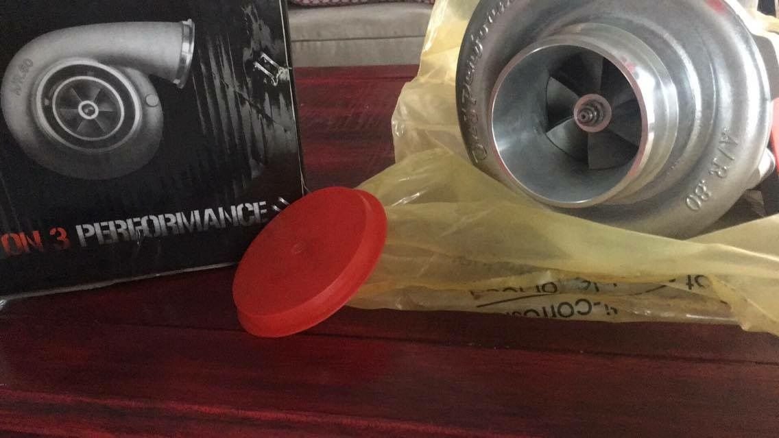

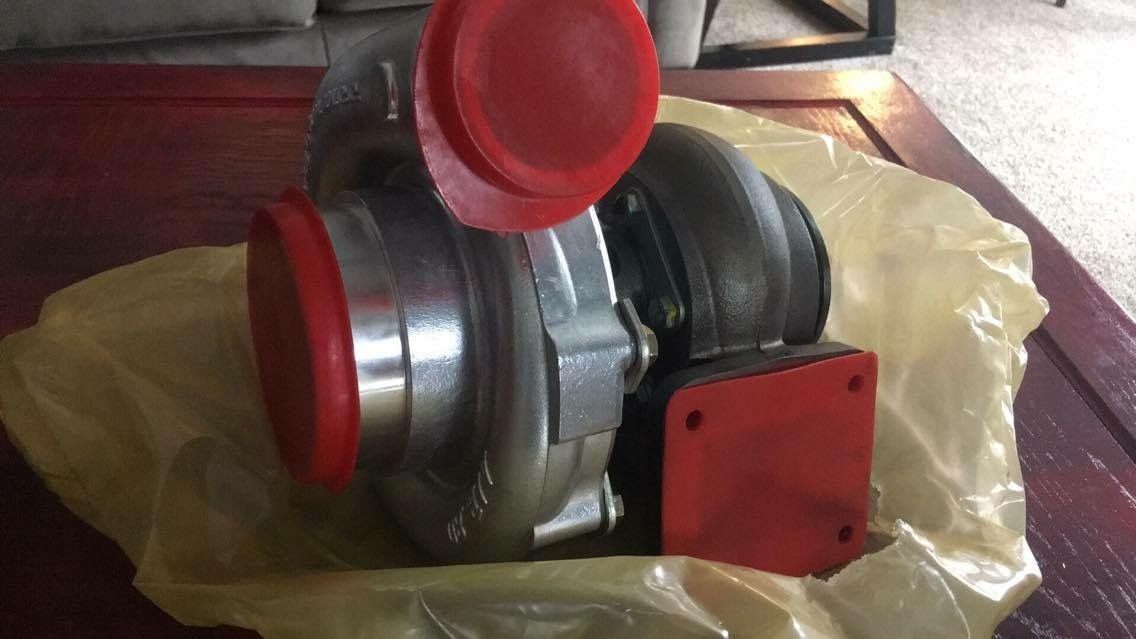

On3 76mm turbo
