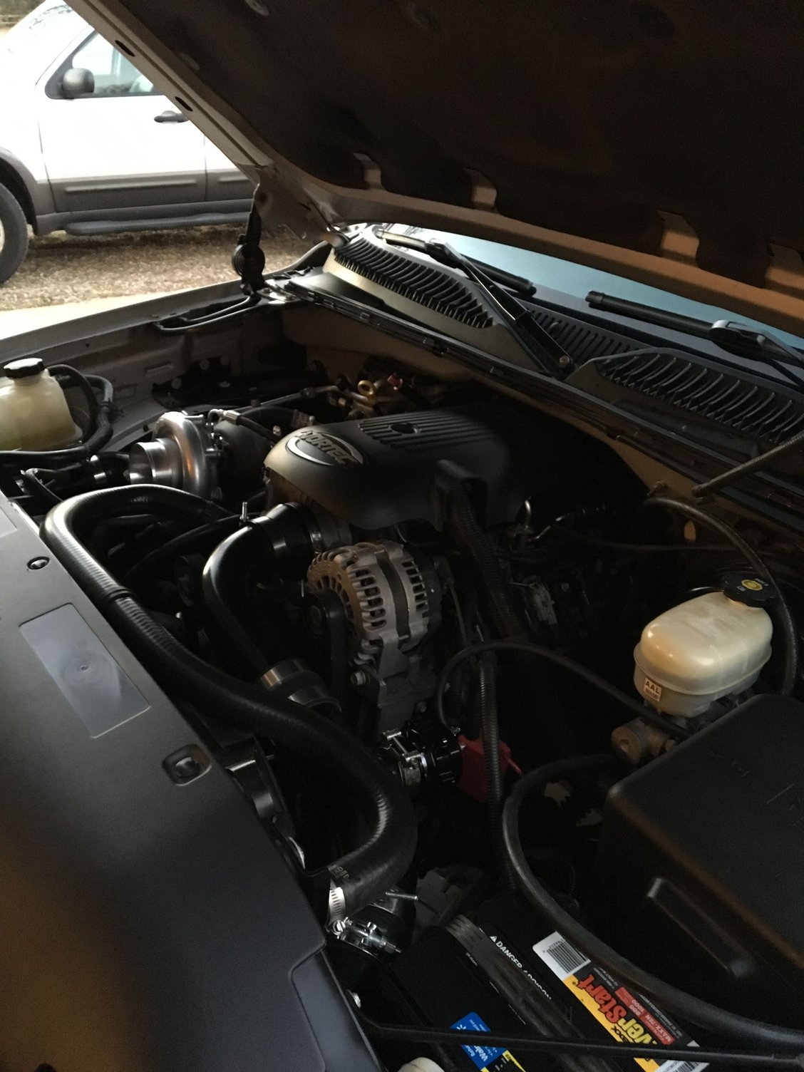

Back October or November of 2016 I picked up a set of racestars.
Update:
Been a long time since I've been on here and updated anything about the truck.
So for those that are interested here we go....
Back in December of 16' the turbo kit was installed, it needed a few tuning issues worked out, but also needed a new cam (the cam in the truck was speced for a nitrous build) and a converter. But, the truck was running and driving and on 9lbs.
Took the truck out about a week after the turbo kit install and decided to give it a few small pulls. Welll.... even with the trucool 40k the stock 60e wasn't a fan and after only a short lived 74,000 miles trans started slipping. Parked the truck in a friends garage for awhile as I had just moved for my job about 3 hours away.
Fast forward to July and the 80e I acquired back in April was finished being built and installed.
The trans still needed the wiring done and new cam installed to help it run like needed and to prepare it for the dyno.
Fast forward to a few weeks ago and truck had made it to the dyno to be tuned. When on the dyno is was getting warm rather quickly. Installed a new thermostat and same issue arose.
Started to think a head gasket had blown. Ran a compression test just to be safe and low and behold all but one cylinder passed. Cylinder is getting tons of blow by.
But, there is no coolant in the oil or anything else going on.
Looks like the motor will be coming out and getting rebuilt or swapped for whatever I find and decide to build.
Been working on this thing forever trying to get it driving again and it's just one issue after another. But that's part of the game.
I still live 3 hours away from the truck so that also doesn't help in the process of trying to build it when I have spare time.
Enough rambling.
For those interested in the current setup;
SBE 5.3
Isky Triple 12
Milled 243 heads
TBSS Intake
KB Racing hot pipes
On 3 76/65 (9#)
Custom intercooler piping
Bosch 1000cc injectors
Walbro 450 in tank
Built 80e and Circle D 3200 convertor
74,000 original miles
