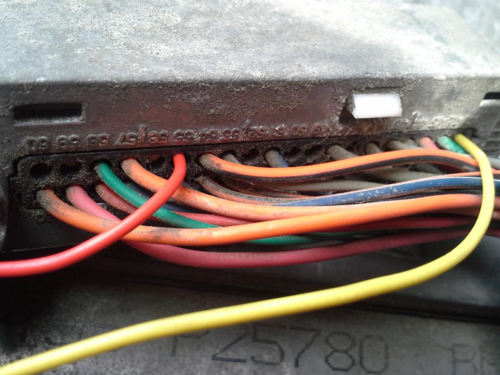

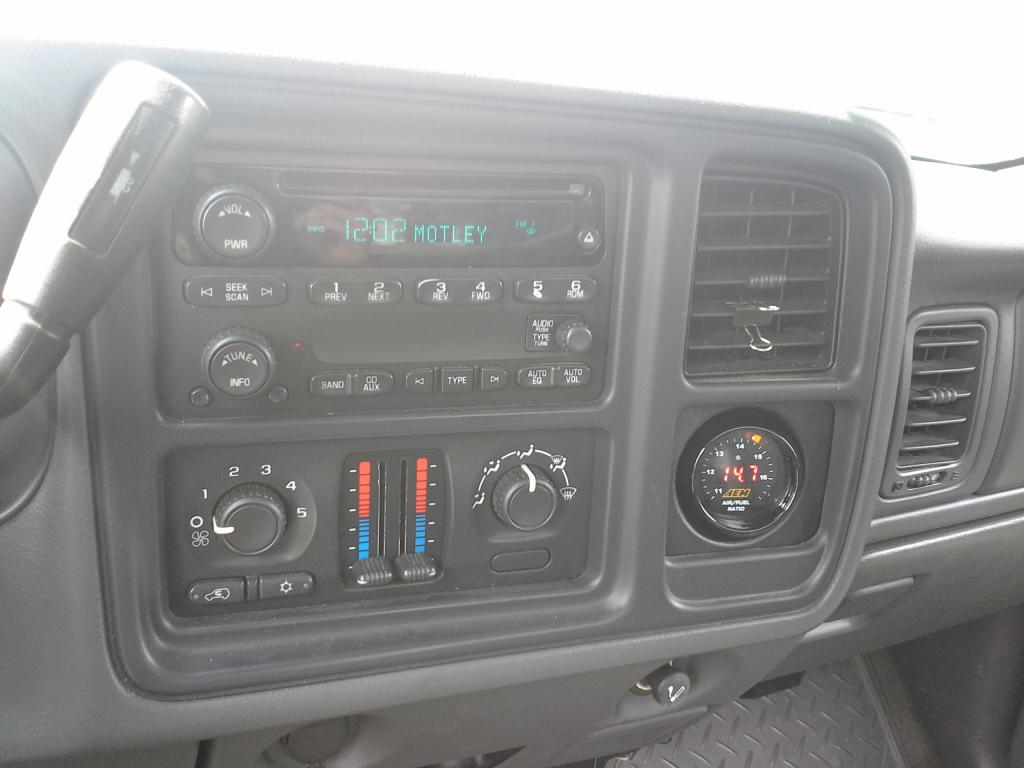

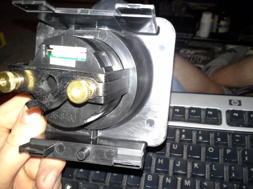

Just a couple updates.
Got the wideband and gauge pod mounted up a little while ago, ran wire to the PCM and make the stuff up for HPT to log it.
Red and yellow wire leading away are for the EGR, Red is volts/power from pin 55 and ground is 41 in yellow.

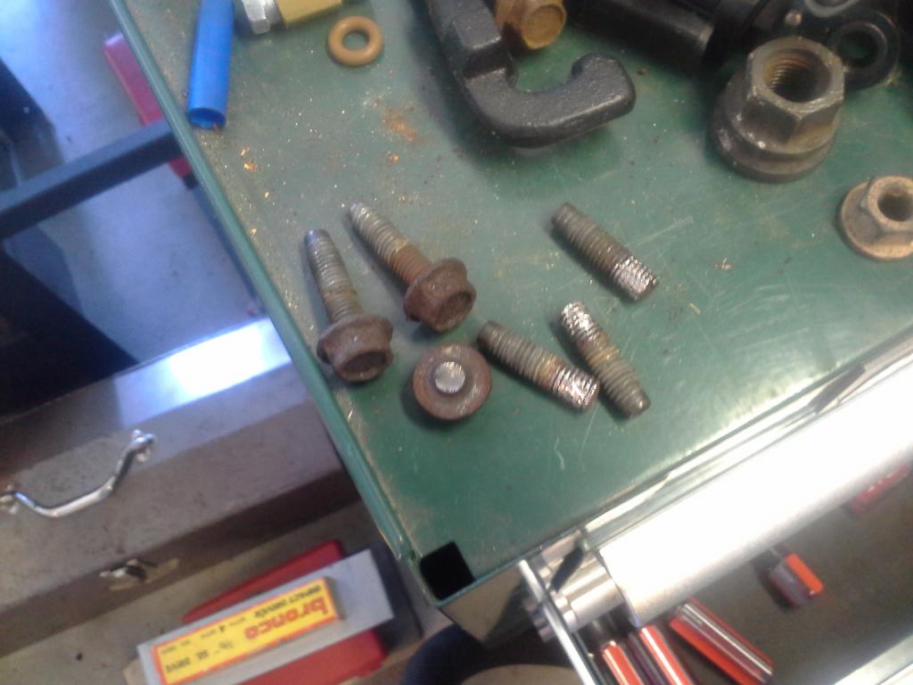

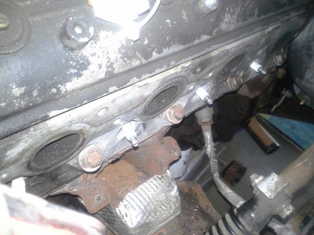

Next up was fixing 2 broken exhaust manifold bolts, and I ended up breaking a 3rd. Got them all out with a little heat and some vise grips, took awhile but it's all good.

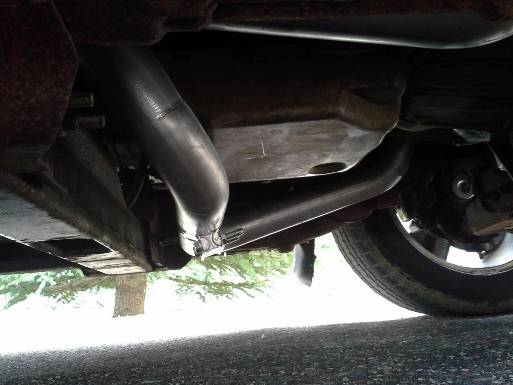

Then I bought a early year 4WD y-pipe but it didnt fit, trans crossmember would hit it. So after talking with another member and confiming fitment of JEGS offroad y-pipe I bought one and got that installed. Everything fit good except for the flange at the back connecting to the rest of the exhaust, it leaks pretty good there and I havent had time to figure some out yet.

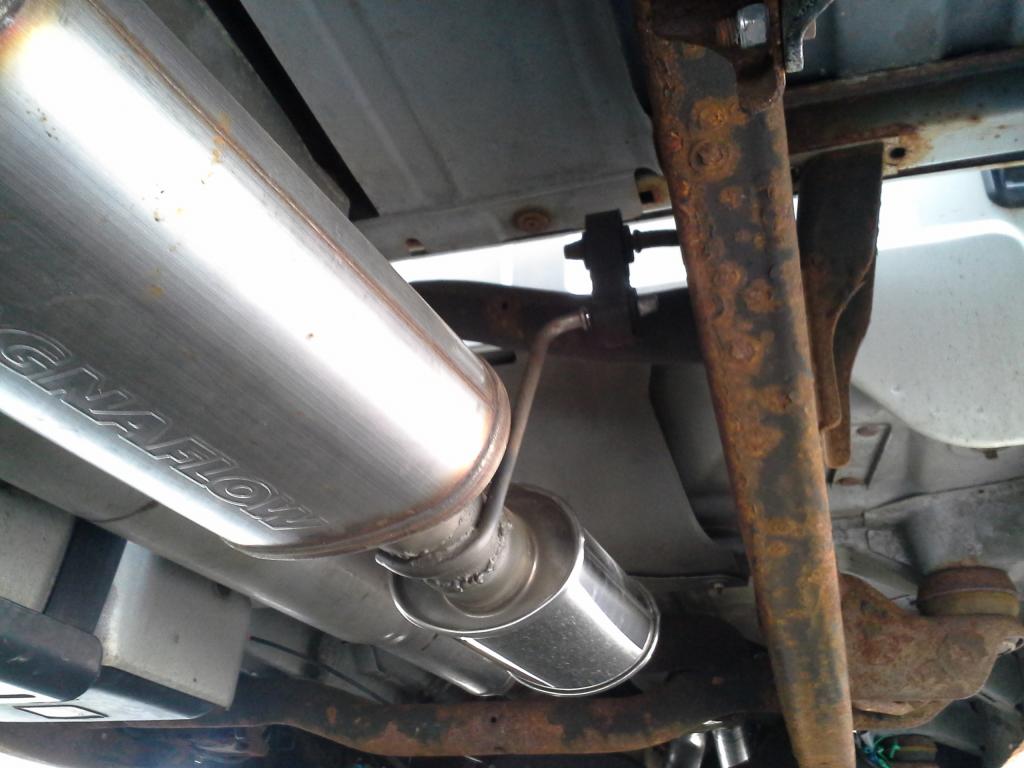

Going catless made everything louder and gave it more rasp and drone. I wasnt going to have that so I bought a Vibrant Ultra Quiet Resonator and installed it before the magnaflow muffler. Took away just about all rasp and drone it pretty much gone, very happy with the resonator.

whered you get that pod? i have a gauge mounted there and drilled a hole in the stock piece.
Old Aug 24, 2014 | 07:11 PM
  #36
FFDP's Avatar
Joined: May 2014
Posts: 5,282
Likes: 600
From: Rogers, MN
TTS Power Systems
Call them and order it. Was like 40 bucks after shipping.

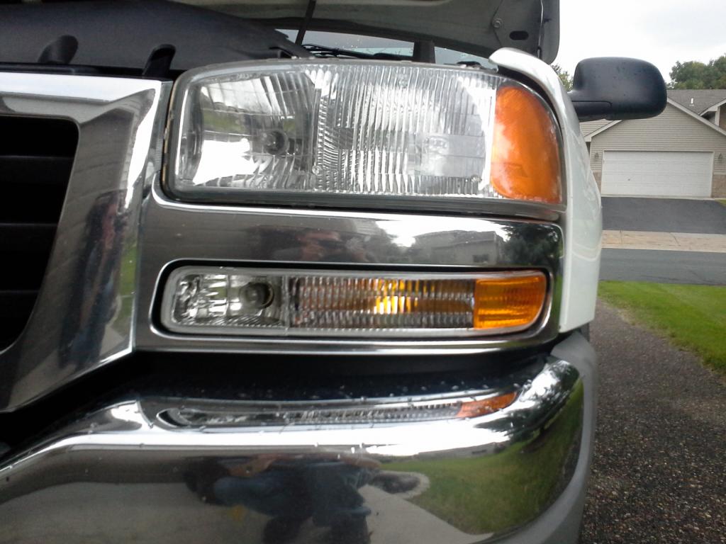

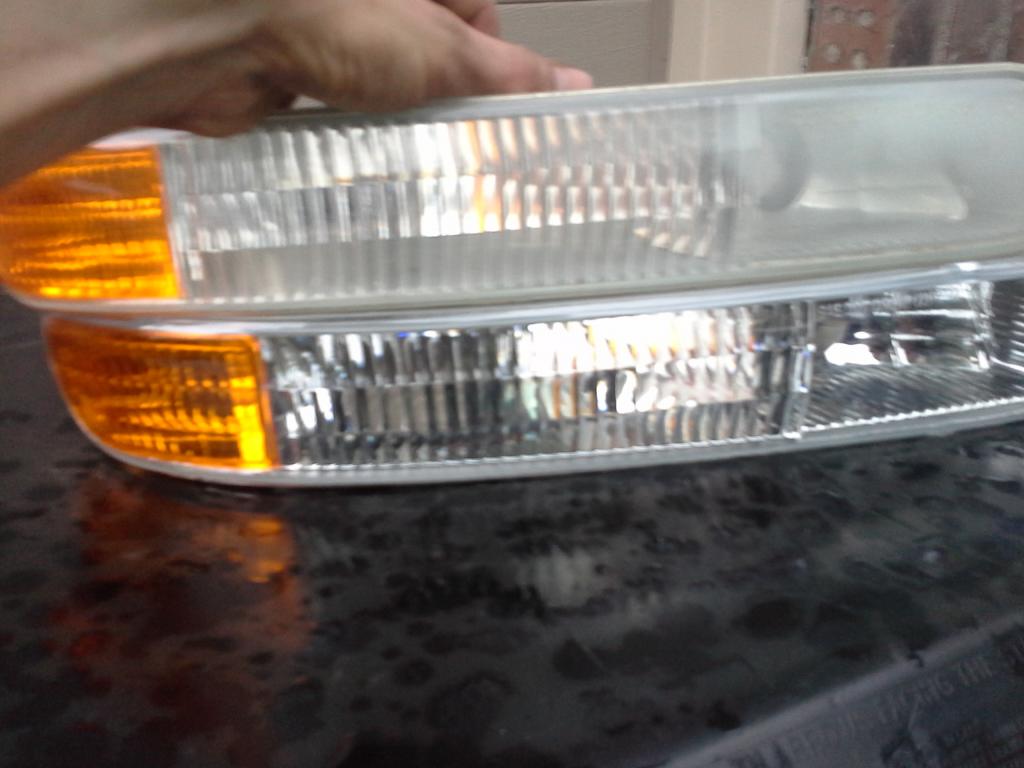

Got some new turn signal/daytime running lamp lights today. Only 7 bucks per side from rockauto.
Looks much better now.
