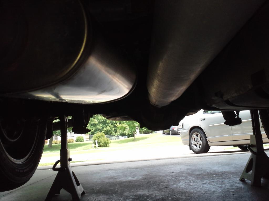

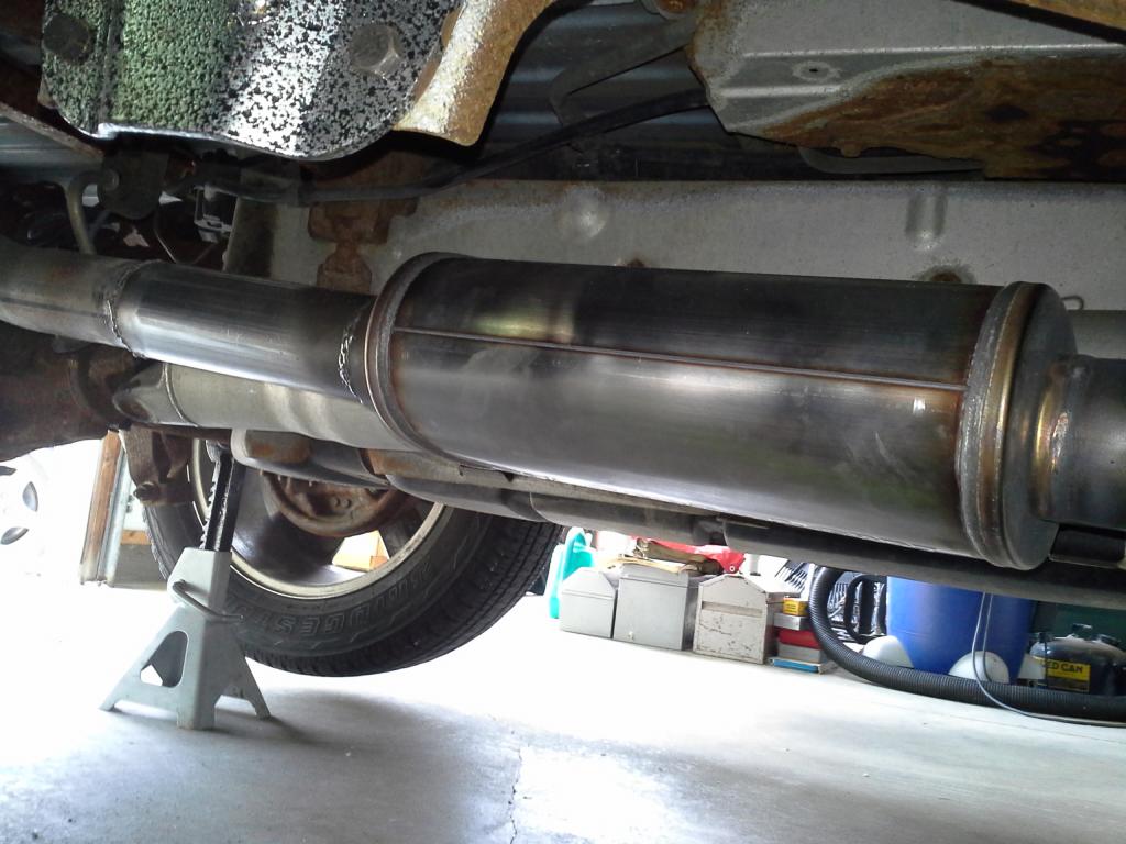

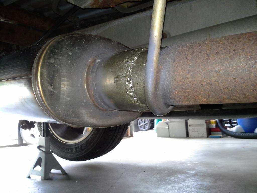

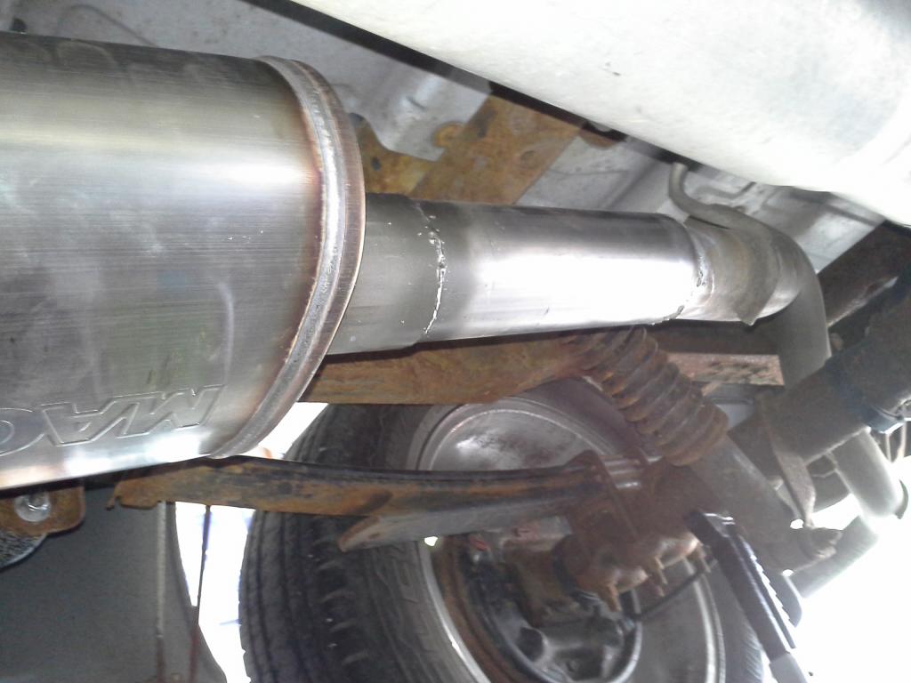

And to bring it up to today, got my new muffler installed.
Bought a Magnaflow 12219 3in/3out muffler, 14in body and 20in long overall with 9.5in of extra pipe added to make up the difference from the stock muffler.
My half assed welds, then coated in engine enamel to protect the welds. I hacked off the "L" behind the rear tire aswell, so it's just tipless and I prefer that.

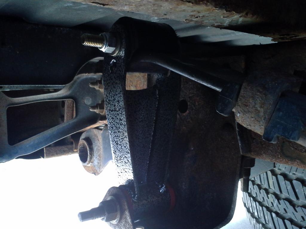

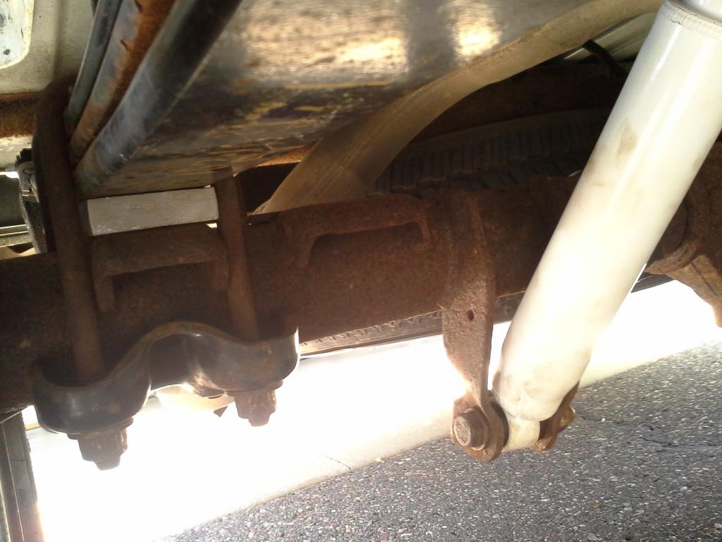

Rear drop in. New shackles, DJM 6º shims and new drop shocks.
We had to take the leaf springs off the truck one at a time and support it with a screw jack and tranny jack because the top shackle bolts would not come out. Took atleast 2 minutes of straight air hammering to get the bolts to push out of the bushing.
Good times.
Good times.

I had vibrations when I did just the hangers under heavy throttle and at odd speeds.
I figured with going another 2in lower and with the pinion already pointing mildy upwards I would need either a 4-6º shim atleast without doing any measuring. I bought the 6º shims on a whim and it seems to be right. I havent been above 60-65 mph since I installed them but I get nothing under heavy throttle.
Plus I researched alot and even though every vehicle is different, most guys ran between a 4-6º shim anyways. And nobody talks about long beds either, those were all short bed trucks.
