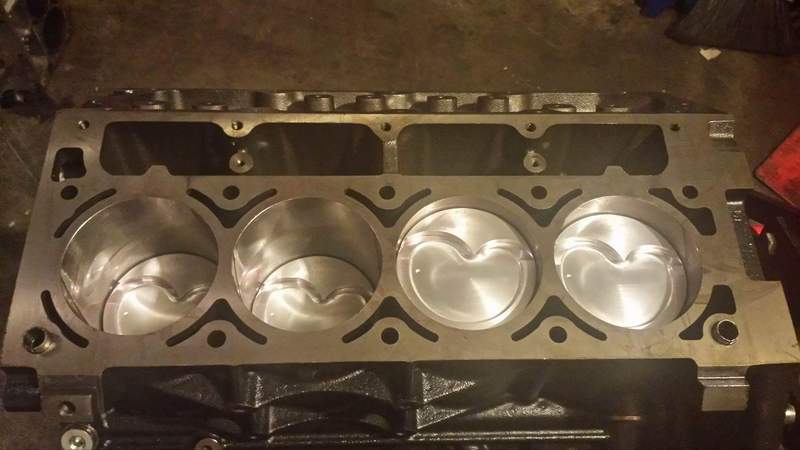

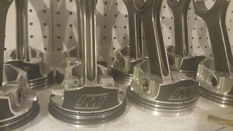

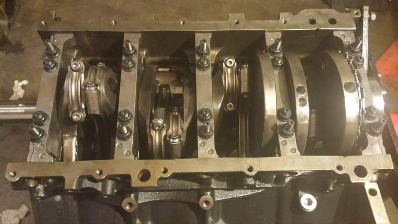

Motor will be home tomorrow! Here's a few pics. Block was decked, bored, line honed, all pins were fit, chamfered all oil holes pretty much everything that needed to be done for it to be right was done. I'll be pulling the old motor on Monday and putting this in Tuesday

HAHA! yea man this guy is good very through. I gotta say tho all the machine work was done on the block already all he had to do was pin fit the pistons and rods, chamfer the oil holes, measure and install new bearings
I also had him change the reluctor wheel so i don't have to run the signal converter box

Posting so I don't forget...ring gap 26 on top 36 on bottom will post bearing clearances in the morning

26/36. Damn, how much boost do you plan to run? What rings are they?
ALL OF IT!!!
na about 23-25 psi

That seems like a lot of gap, at least for the lower. Looks like wiseco pistons, right?
yessir
