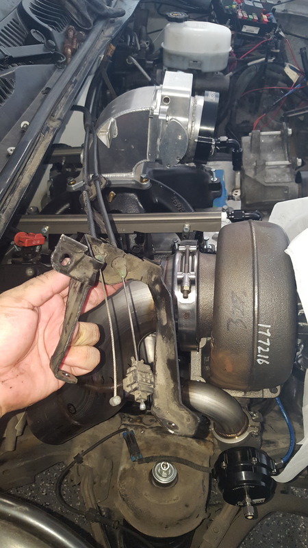

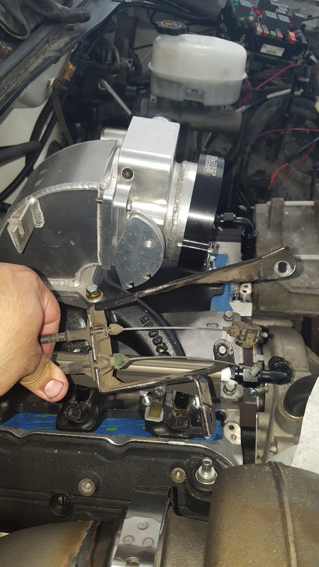

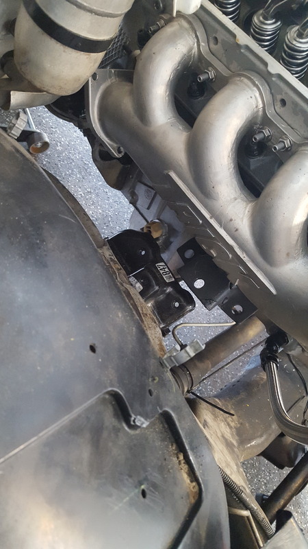

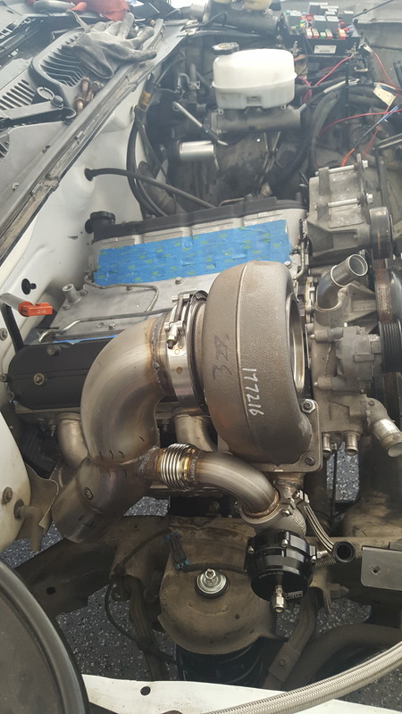

Today i got the new hydro boost in. Still need to get the pedal but everything else is done on it. (taking the front seat out made this a hell of a lot easier i was able to comfortably lay on my back in the cab and get all the bolts in.
I also bolted up the hot side cross over and the turbo with the first piece of the down pipe.
My next issue is being that I've never dealt with a drive by cable i don't know how to attach the cable to the throttle body. I know they simply clip in place but it seems like i have way too much slack in the cable.

Throttle body spacer maybe? I had a similar issue with my 99 with the l92 intake, made a bracket work!! Are f body throttle cables shorter at the tb end?

I got the main throttle cable connected today the other cable I would assume is for cruise control? I can connect it but I need something bigger on the end than what is there now to hold in place. Or totally do away with it?
Old Aug 31, 2016 | 04:43 PM
  #168
Wolftrk99's Avatar
Joined: Jun 2013
Posts: 5,492
Likes: 48
From: Virginia Beach,VA
Yeah its the cruise control cable...
