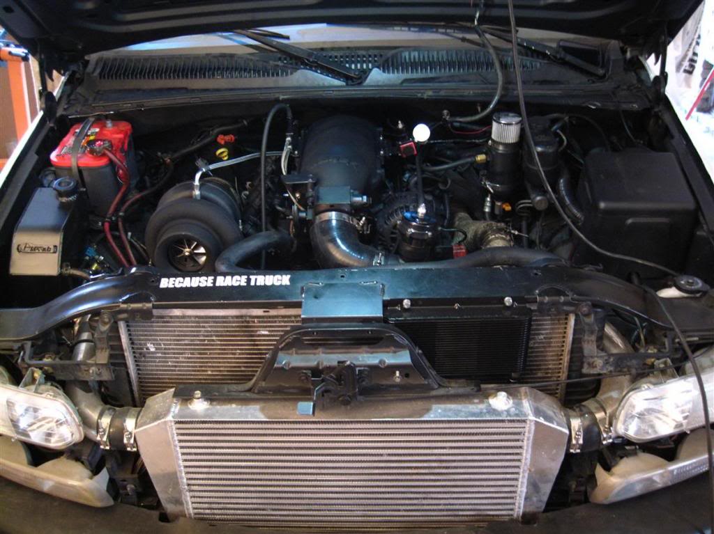

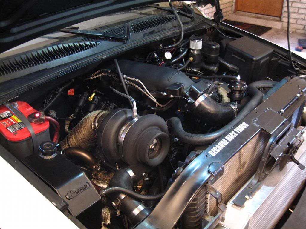

I know what thats like, I am tired of working on this thing, BUT I did finish assembly tonight!
First startup here shortly...
