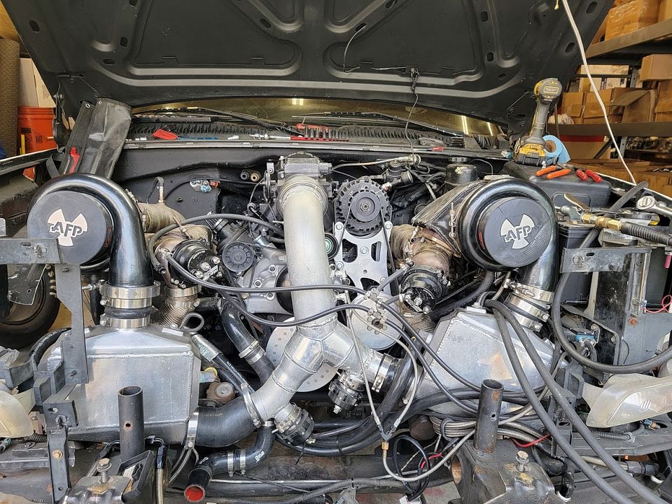

Yep, got tired of being frustrated with it so I took the blower off and sold it to the guy I have helping me part time with AFP. He really enjoys it so glad it went to a good home. Made some changes over the winter to hopefully blow up this ~8 year old engine this year.
  • Got a new set of injectors, same size, but maybe my old ones had something to do with my mystery misfire
  • new plug wires from firecore, maybe some of the ones I made were bad
  • new coilpacks and harness
  • holley hi ram intake
  • finally putting my nice viking crusader coilovers on ive had sitting on the shelf. Been rocking the worn out QA1s since 2011 even though I make the damn kits lol
  • replace window regulators so maybe they roll up nice now
  • gonna make my ladder rack out of aluminum instead of the steel to maybe save some weight (yea I know its dumb)
  • I have a data acquistion box Jake made me that I plan to use to monitor water/air temps and pressures from the intercoolers since im still on a stock ECU
I have another truck waiting for me to get it that will be a compound setup eventually. I havent said anything anywhere about it yet. GMT900 work truck...LONG BED because why the hell not, 4wd of course, gonna be a bad bitch

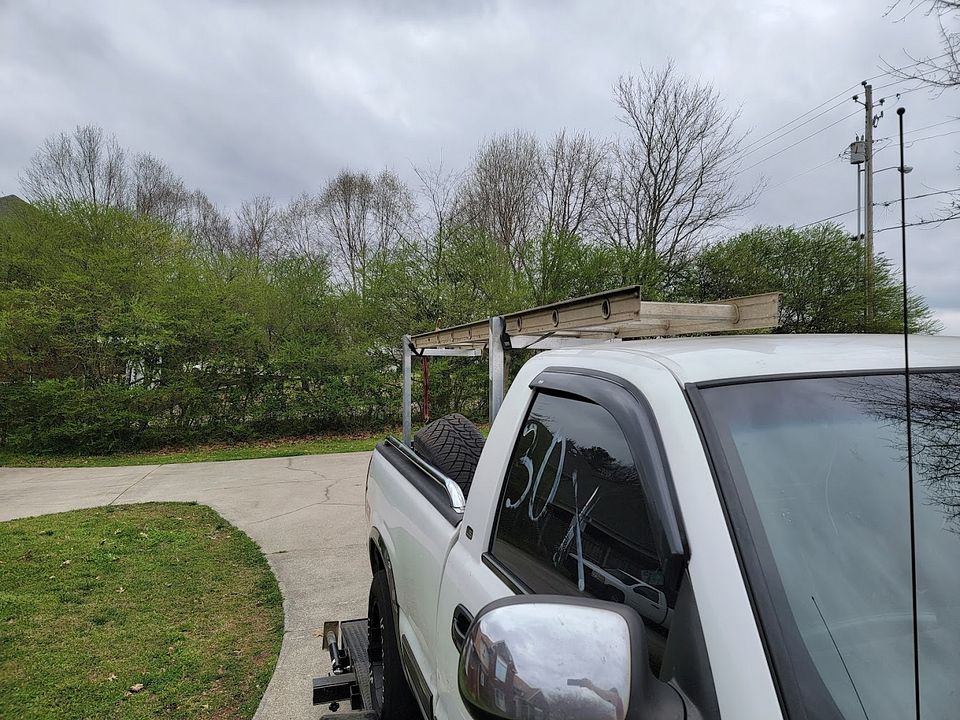

I guess this thread motivated me a little bit
Its actually pretty sturdy, not worried at all about putting a ladder on there

End up shortening the ladder rack so I wouldnt keep hitting my garage door when I forget its there -_-

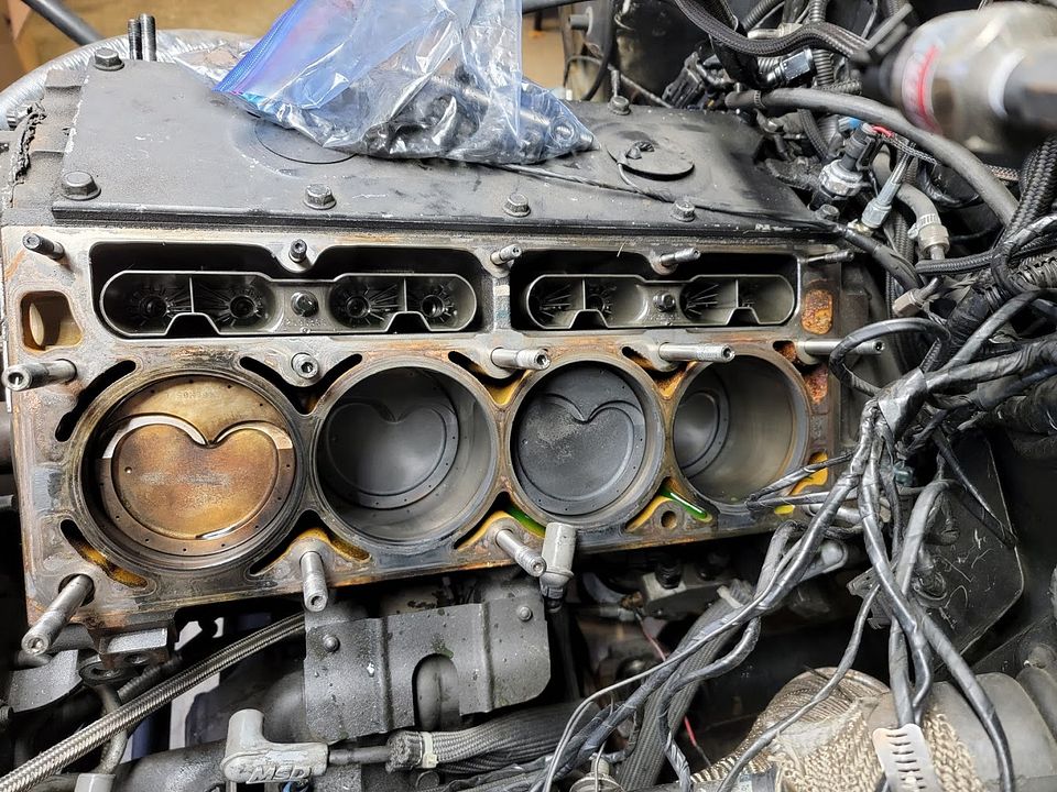

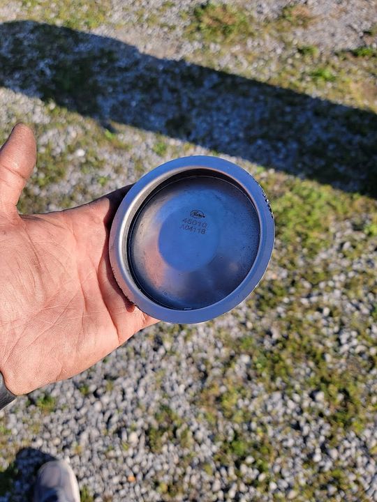

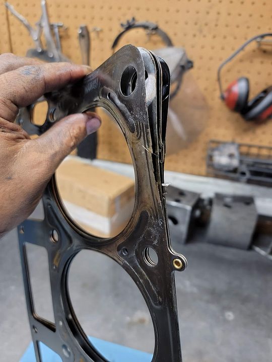

On the first and 2nd (final) run of the next weekend though I kept blowing up water pumps by blowing off the back cover,
Didnt have a chance to work on it for a long time (this race was middle of March and just took it apart in middle of June). Turns out was probably pushing water on all cylinders but ol number 2 gave up:
So I slapped it back together with some athena SCE cut ring fancy schmancy gaskets and just gonna keep sending it with some timing pulled out because why not on this 8 year motor that just keeps going

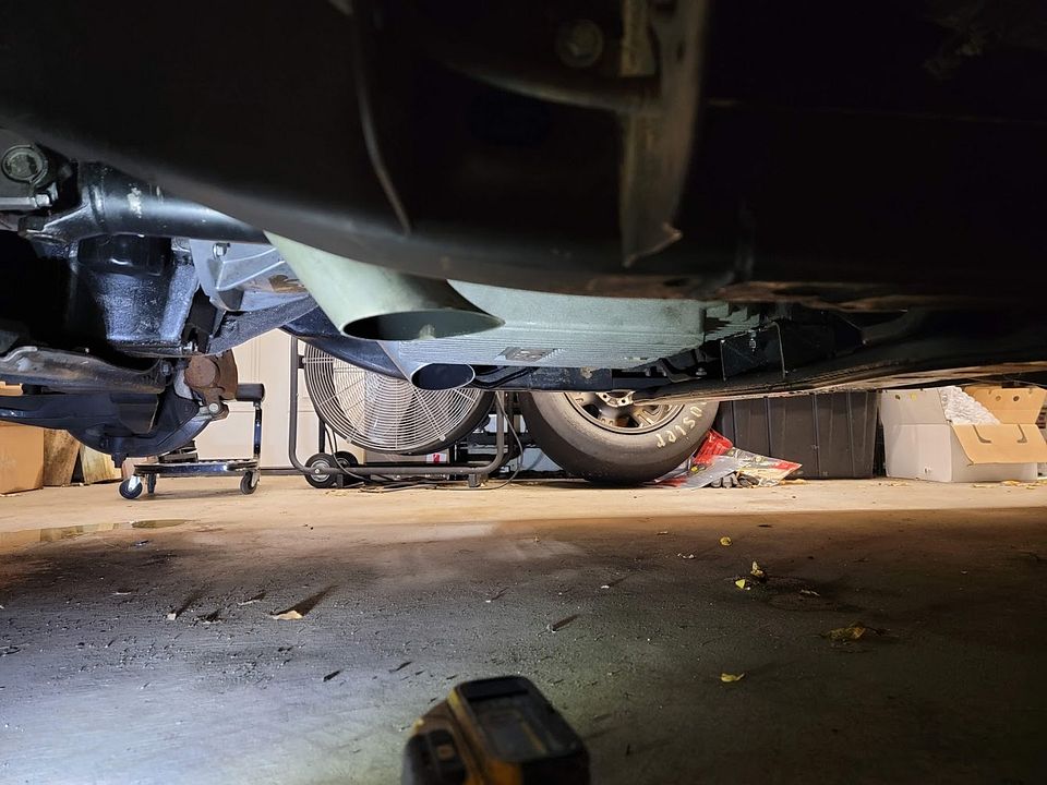

Also cut the downpipes so they would stop dragging on the trailer
