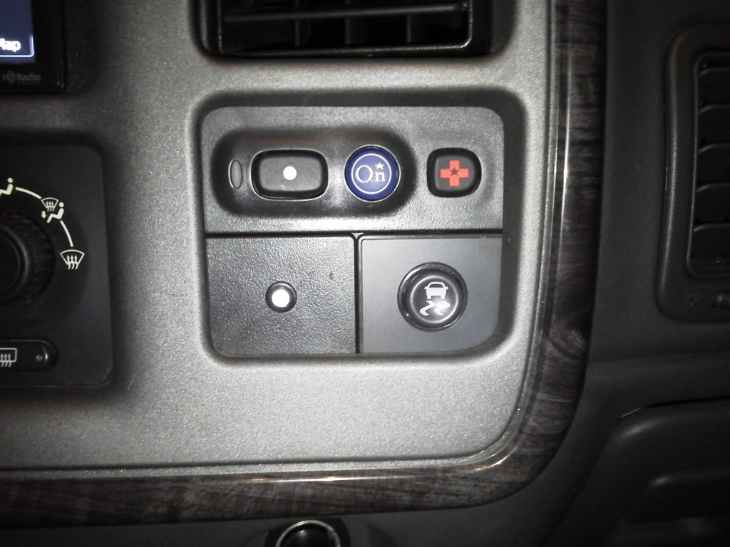

UPDATE:
Was going to attempt to work on the trans this weekend but got side tracked and didnt have the time so I tackled something less labor intensive.
It was too dark for a photo but I installed the line lock on the rear brakes. Before I went turbo, I was going to do nitrous and had a nitrous outlet switch panel in the cubby hole. 99silversled and I installed a harris speedworks kit on his truck and I gave him the panel, he brought over a box of random switches for my now empty cubby hole.
I grabbed the onstar buttons and the traction control button. I was able to meter out the traction control button and find two pins that were connected when the button was pressed.
Since the button is a momentary, I needed a momentary latching circuit, there are a few ways to do it but DEI makes a module for $20 so to avoid the hassle I just picked that up. I wired up the pins from the traction control button to send the trigger wire to ground when its pushed. The latching circuit sees the pulse and stays on until it sees the same pulse again. Turns the momentary switch, into an on/off switch.
I also added a super bright LED to the left of the button so I don't forget its on.
Traction control? Nah, Burnout control
Old Jun 3, 2012 | 06:36 AM
  #186
mitchellmade's Avatar
MASS seller approved
Joined: Apr 2011
Posts: 620
From: Trenton,nj
That's fkn cool

What do all the other switches do lol?
Old Jun 7, 2012 | 11:18 AM
  #189
03RCSB's Avatar
Joined: Mar 2007
Posts: 287
From: Central NJ
Right now nothing haha, I metered them out and it looks like I'm going to have to go to the board to use the buttons. I'll get to it some day, no rush. I cant wait for something that small to be a weekend project. Tired of being covered in different automotive fluids every weekend.
