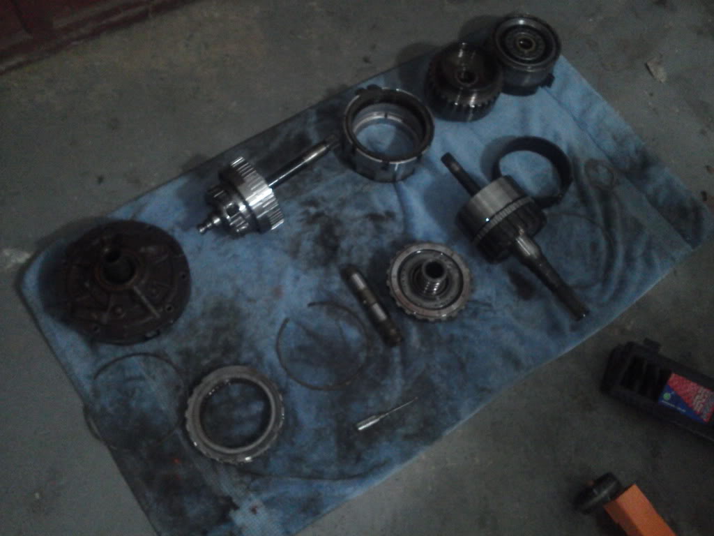

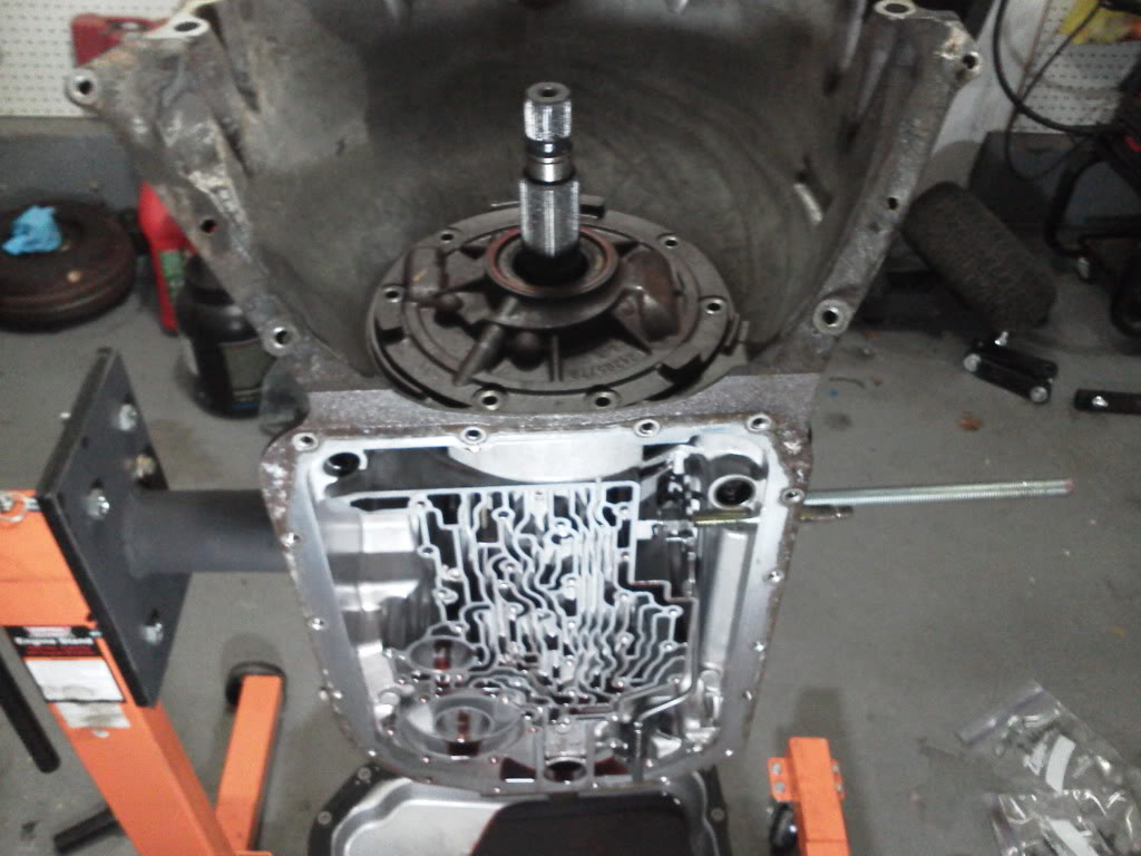

All apart
Some parts of the case look a little funky so i'm hoping they are normal and I just dont know what im looking at. Aside from the broken teeth on the overdrive planet everything else looked good so i'm hoping a basic rebuild kit will do the trick. Waiting for some guys in the drivetrain section to confirm.

Well after checking in the drivetrain section, the chunked teeth in the above pic are actually cast that way, learn something new everyday.
Dug a little deeper at the suggestion that the metal in the pan was the OD roller clutch springs and sure enough.
$15 part
Since I am in here though i'm going to go ahead and do a full rebuild, HD sprag and shift kit. Saw stock48 saying he has 4+ years of DD, 100 track passes with a best in the 9's on a similar build and its still holding strong.
Looking to go somewhat away from the normal transgo and calling up jakes performance to talk about their shift/rebuild kits, hope to start the rebuild next week.
