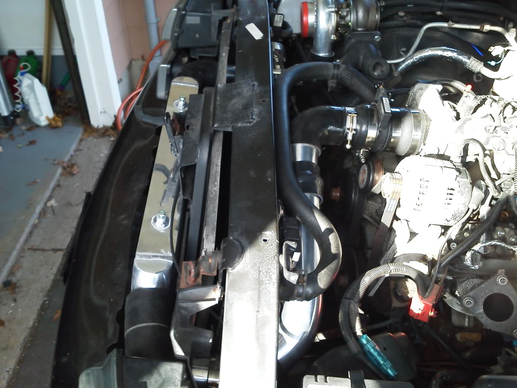

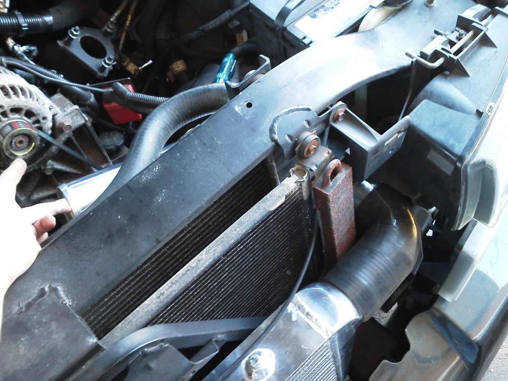

Update
Turned the wrenches all day, finally out of the test fit stages and started on the final install, happy I don't have to pull the flipped manifolds anymore, such a pain.
Got the cold side all figured out but unfortunately the universal kit isnt as universal as the name implies. Couple more hoses needed but its very short routing. Also moved the BOV to the hot side of the intercooler.

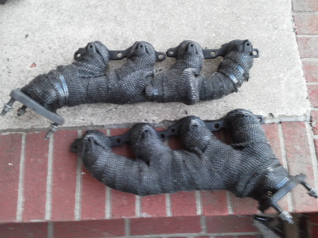

Heat wrapped the manifolds
Plug wires made and installed. Probably went overboard with the heat wrap and heat tape but I had it here so better safe then sorry

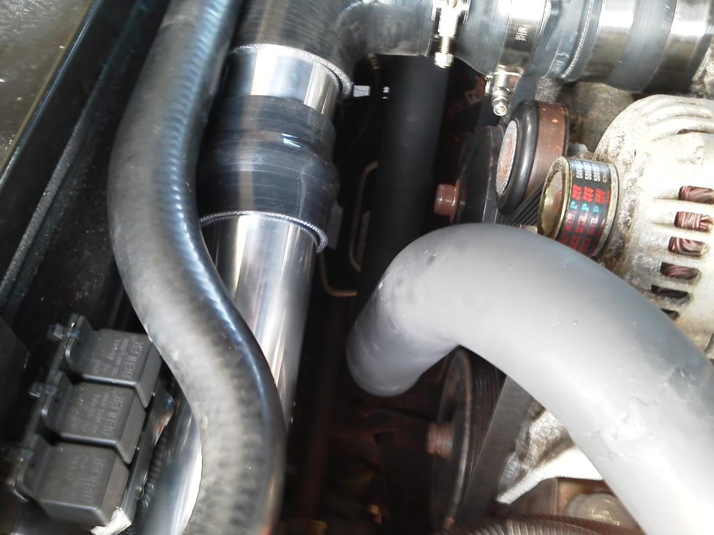

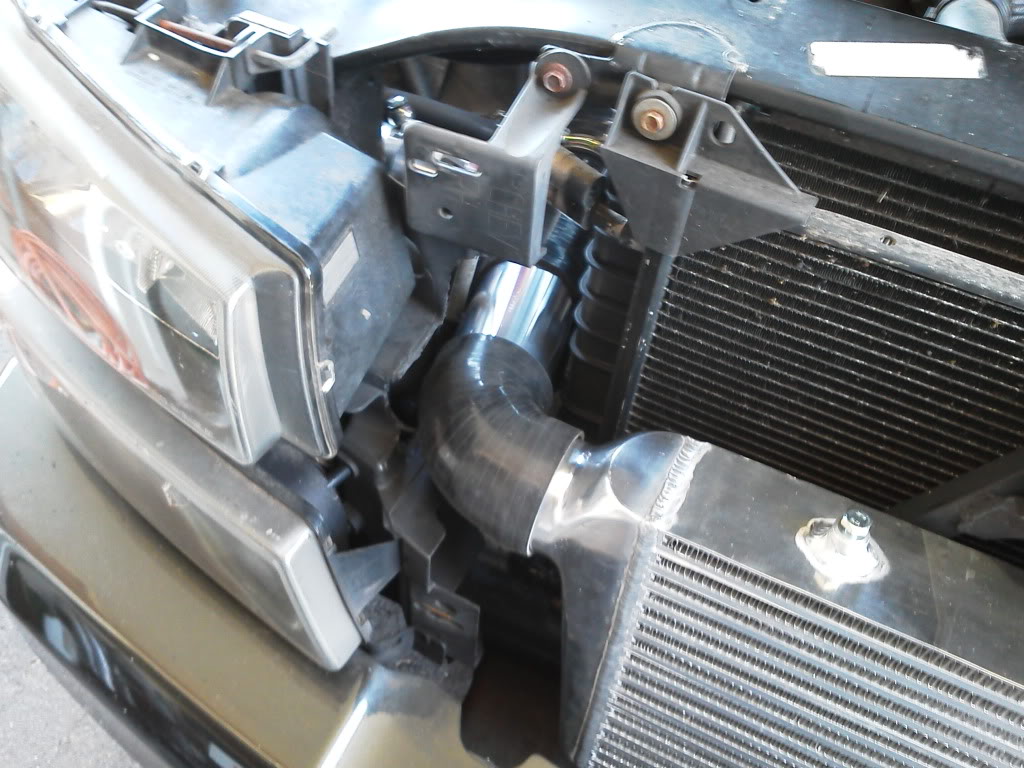

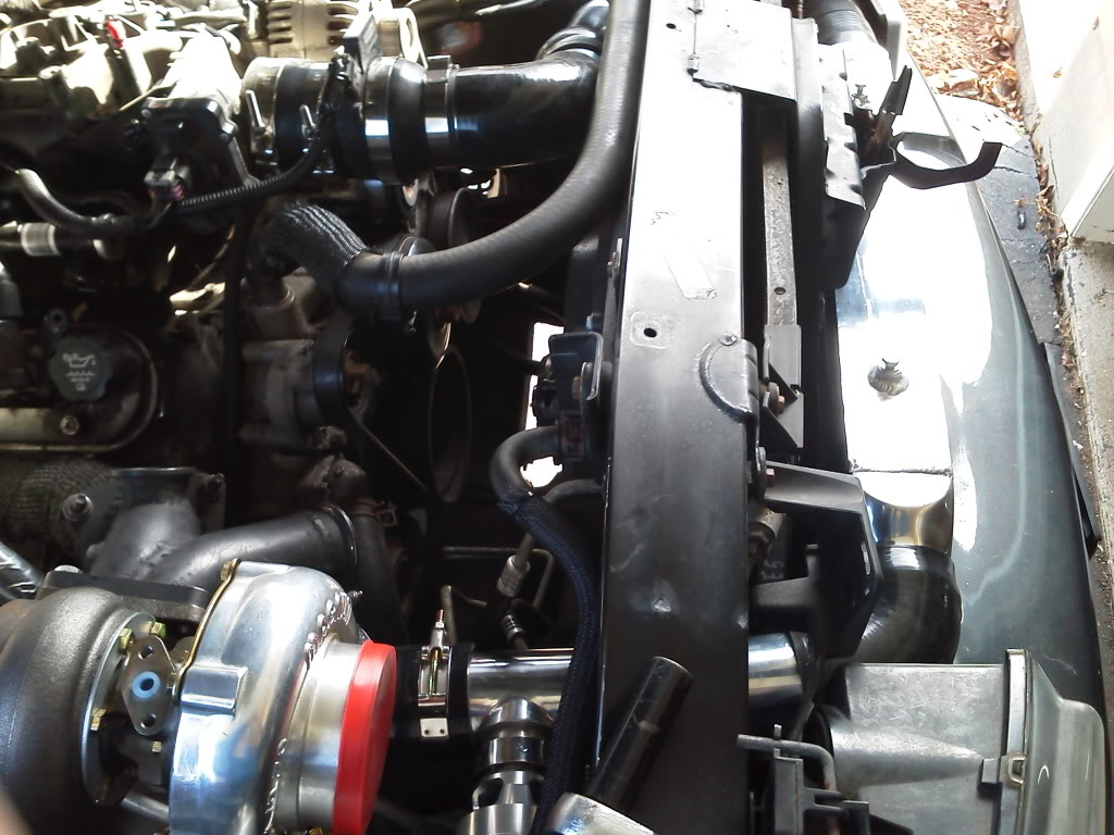

IC pipes
