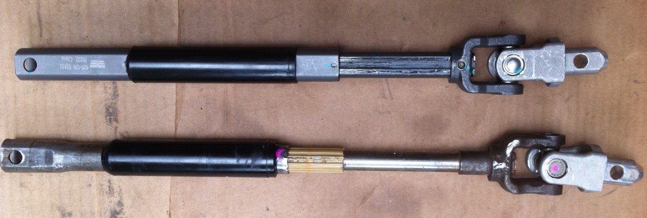

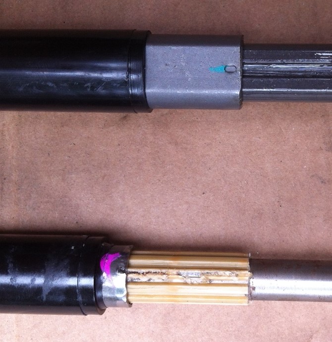

No plastic in the new Dorman shaft
Attached Thumbnails Holley Dominator Install-steering-shaft1.jpg   Holley Dominator Install-steering-shaft2.jpg

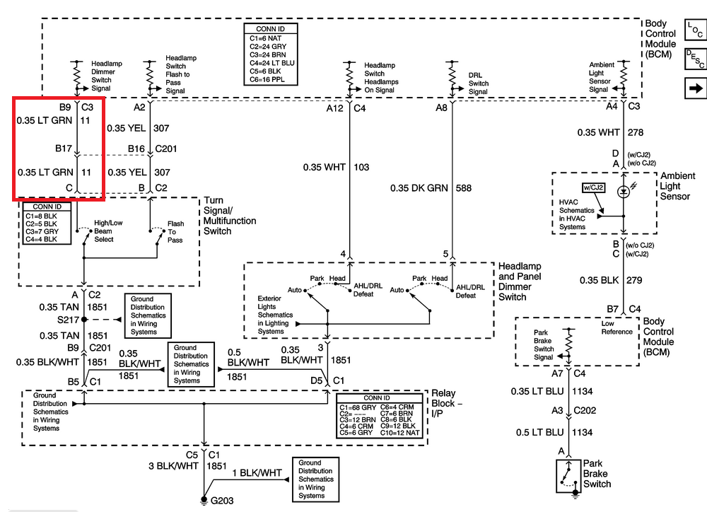

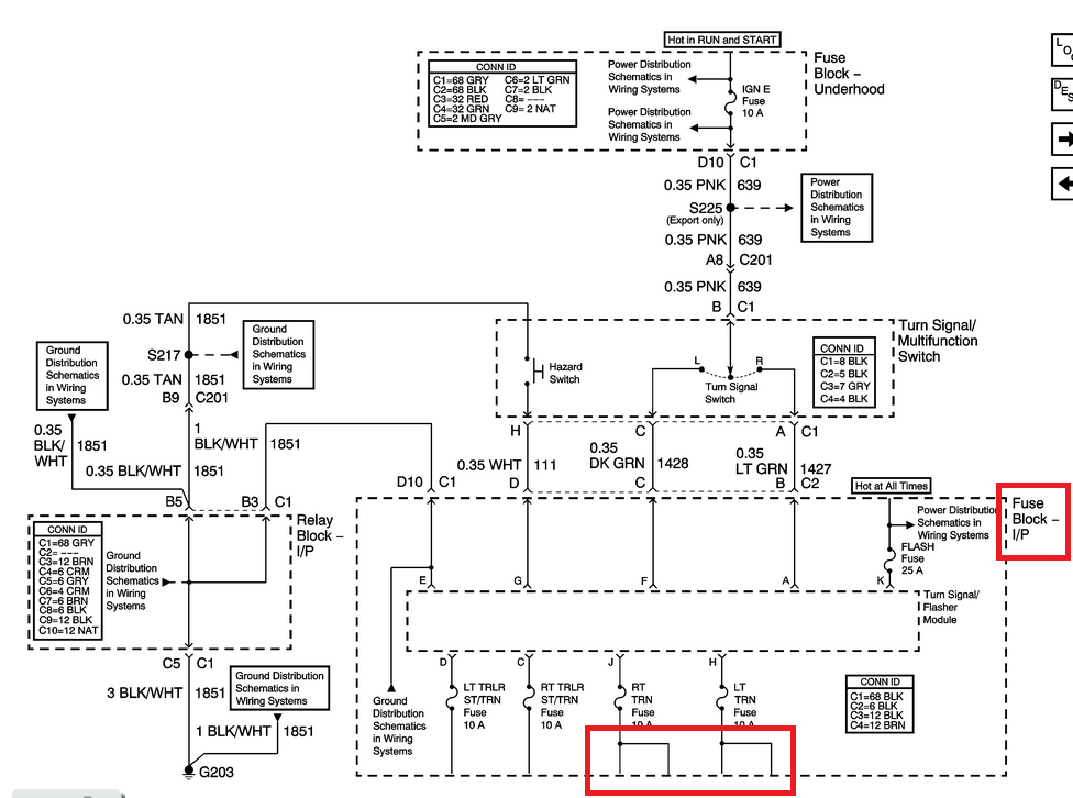

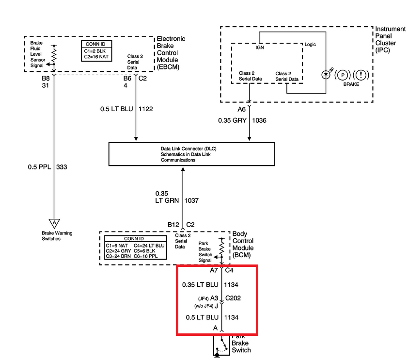

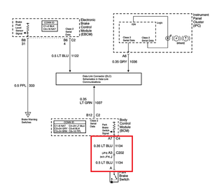

I had forgotten about some of the indicators on the factory cluster.
On my '04.......
Turn signals can be picked up as 12V at the turn signal fuses on the Instrument Panel fuse block.
High beam indicator and park brake switch are both switches to ground when active.
New indicators can be added or these may be configured as inputs to the 7" Holley Digital Dash if one purchases the optional IO cable for it.
Attached Thumbnails Holley Dominator Install-turn-signals.png   Holley Dominator Install-high-beam.png   Holley Dominator Install-park-brake.png

The dash can also display fuel level and odometer now with the use of the extra dash harness.
Nice job, lots of work and figuring out in this good to see you got it done..
Oh also good luck with that dorman interm shaft, ive been thru 2 and they eventually rattle also, im going back to trying the gm style..
Me too, I bought a borgeson intermediate shaft instead, problem free ever since. Take a look when you need something better but at a higher price tho.
Old Aug 2, 2017 | 08:54 AM
  #89
The shaft I replaced was the updated GM shaft. https://www.performancetrucks.net/fo...-wheel-392041/
Wasn't having any trouble with it until I went to remove and reinstall it. Wouldn't slide at all without a lot of help from a hammer. Maybe the plastic didn't like the heat from the headers??
The new Dorman shaft didn't fit into the lower shaft which had been compressed to fit the GM shaft. Had to do a little reduction with a sanding disc. Still a snug fit.

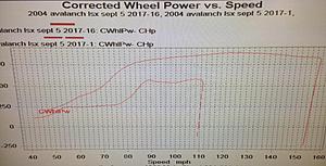

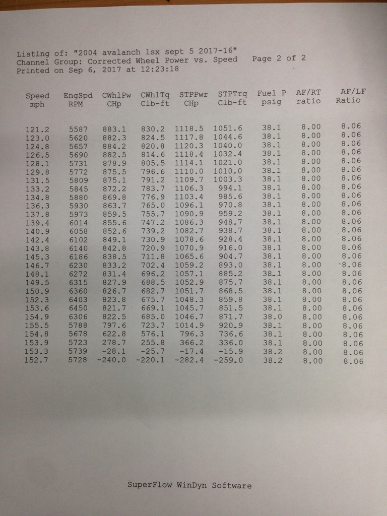

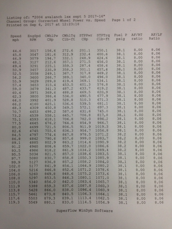

First time ever on a dyno.....
No parts came off on the 150 mph pulls. Base pull was only 9* of timing advance. Final was 20*.
edit: From the logs, it looks like he didn't put the pedal down 100% til the mid 4000's RPM. So ignore everything below that...I knew it didn't look like a typical blower curve.
Seem to have lost a couple psi though compared to the little road testing I did. Dyno logs are showing 16-17, but mine were 18-19 with warmer weather. All logged on the Dominator.
IAT was 140-145 by 125MPH. Highest was 155 at 150MPH, but most of the 150 MPH temps were also in the 145 range.
Bigger IC pump must be helping because I was previously seeing 185 at the track by 125 MPH. Improvement may be even better because IAT and ECT sensors seem to be reading high...like 10* above ambient key on/cold motor.
Attached Thumbnails Holley Dominator Install-dyno1.jpg   Holley Dominator Install-dyno4.jpg   Holley Dominator Install-dyno5.jpg
