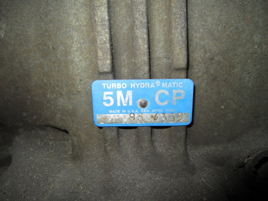

Nothing too exciting, but I did pick up another piece of the puzzle last night.
I also dropped the hitch off the back of it. Probably shaved a good chunk of weight. (although from the worst place) I will likely refinish it in case I need it in the future.

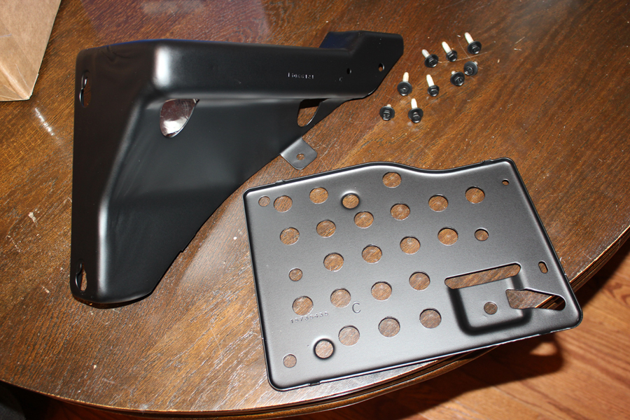

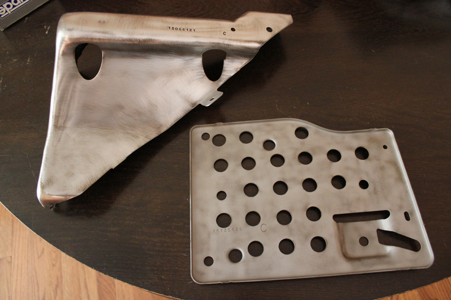

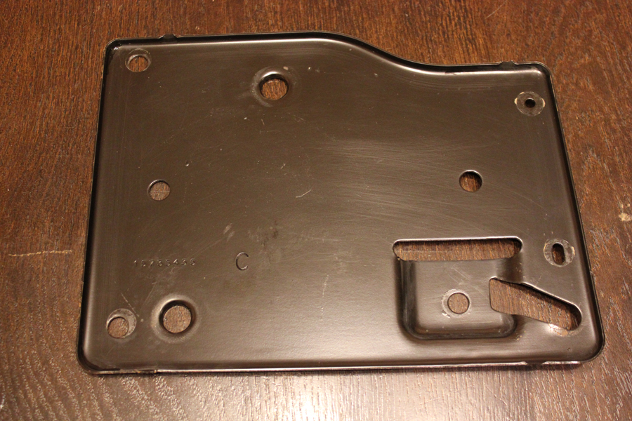

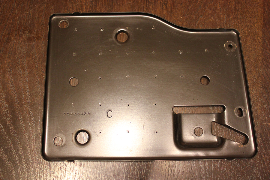

Also did a bit of engine bay work. Plan to cut the air box for a bit more airflow and figured I would do some sprucing up and additional work in the process.
I took of the stock airbox mounting plate and cleaned it up first.
Then I laid out a grid and using a punch and a small bit got some pilot holes started.

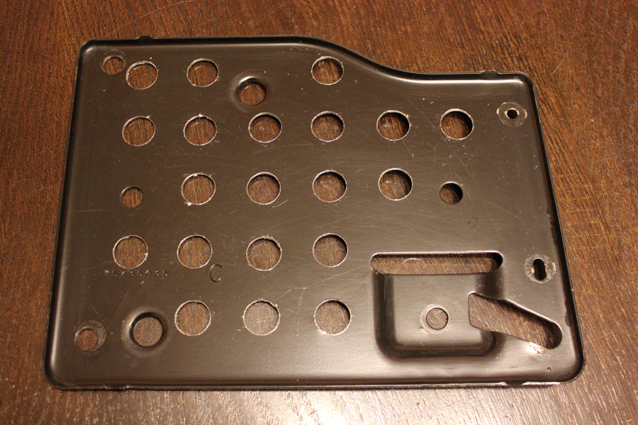

Then I stepped up the bits until I had 3/4" holes.
I then put the modified plate and plate mount into my stripper tank, did an outgas cycle, blasted the box plate and hit the mount with a Roloc since it had some rust on it.
Coated both pieces and all the mounting bolts in flat black. I apologize for the terrible photo.
I need to get the air box cut as well, but ran out of time. That will be a project for tomorrow.

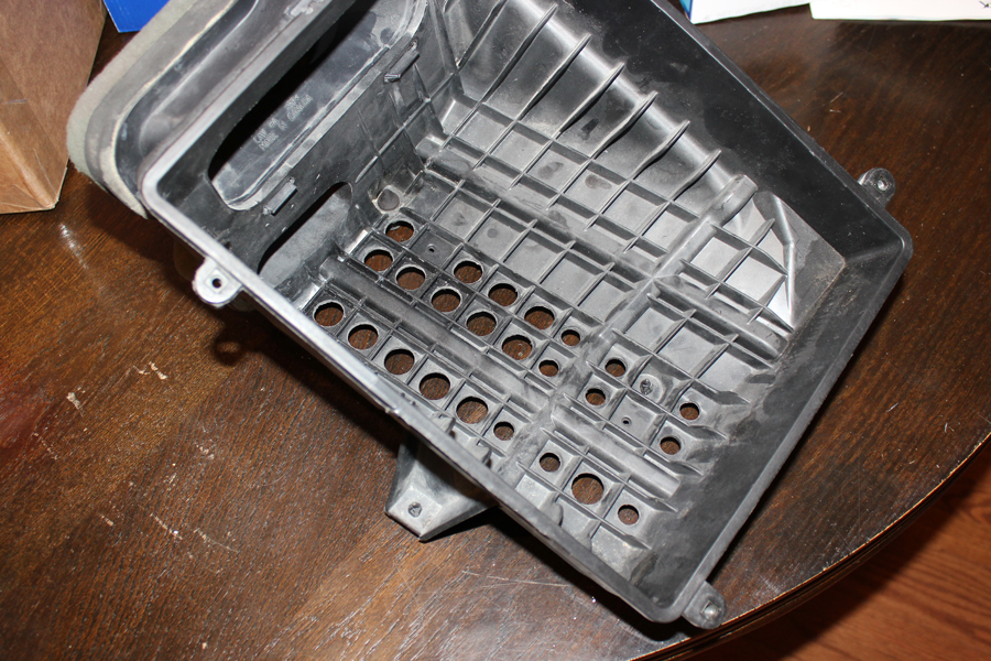

Finished the air box bottom the other day. Decided to drill holes instead of cutting it up, came out looking good and I think will do the job just fine.

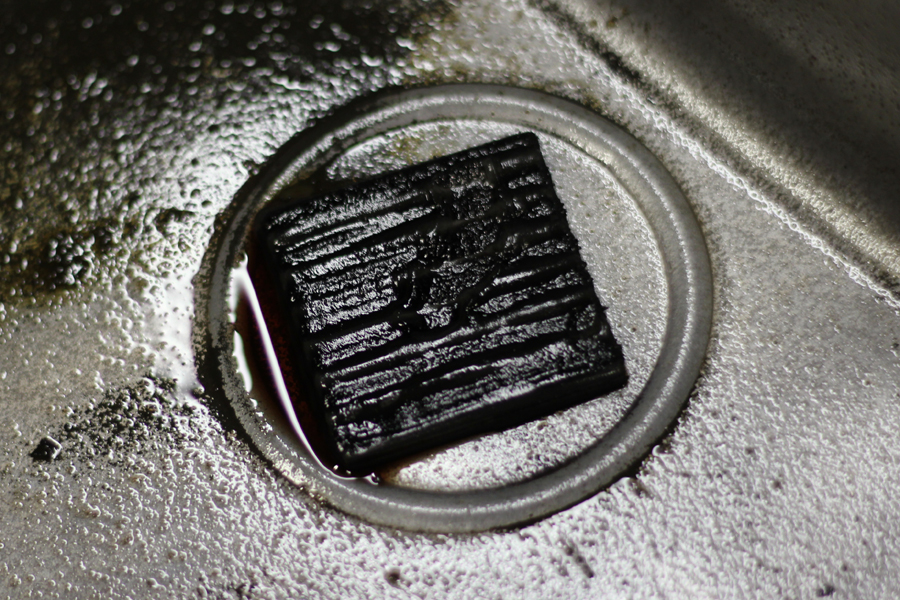

Also got the 4L80E up on the stand and dropped the pan.
Can't say it or the magnet were pretty, but I pans that have had a lot more in them have held up to more power than I will make for a while. Gotta save for a couple weeks now and then will be picking up my torque converter. In the mean time I am going to do some more small maintanence things and maybe a bit of interior work.

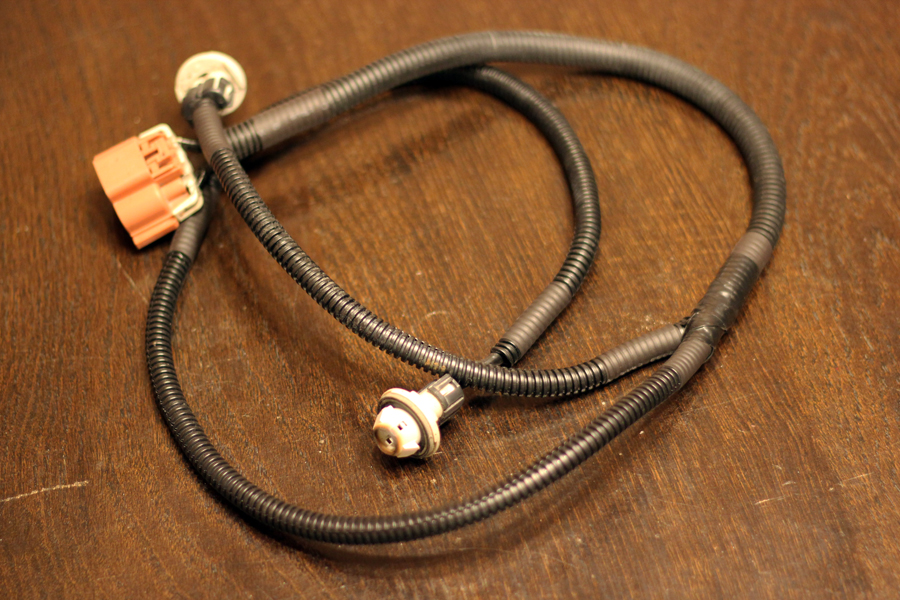

After that I went to swap the license plate lights to LEDs and relaized they weren't working. I changed the bulbs assuming they were both burned out, and they still didn't work. Everything was plugged in as it should be, so I pulled the license plate harness.
I took the harness apart and found a smashed connector pin and a cut up and smash wire. I replaced the wire and soldered on new pins. I cleaned up all the loom with some degreaser, heat shrinked the look and wrapped the still visible parts in electrical tape.
Powered it up with my makeshift 12v testing station and tested it out. Both lights lit up as they should.
