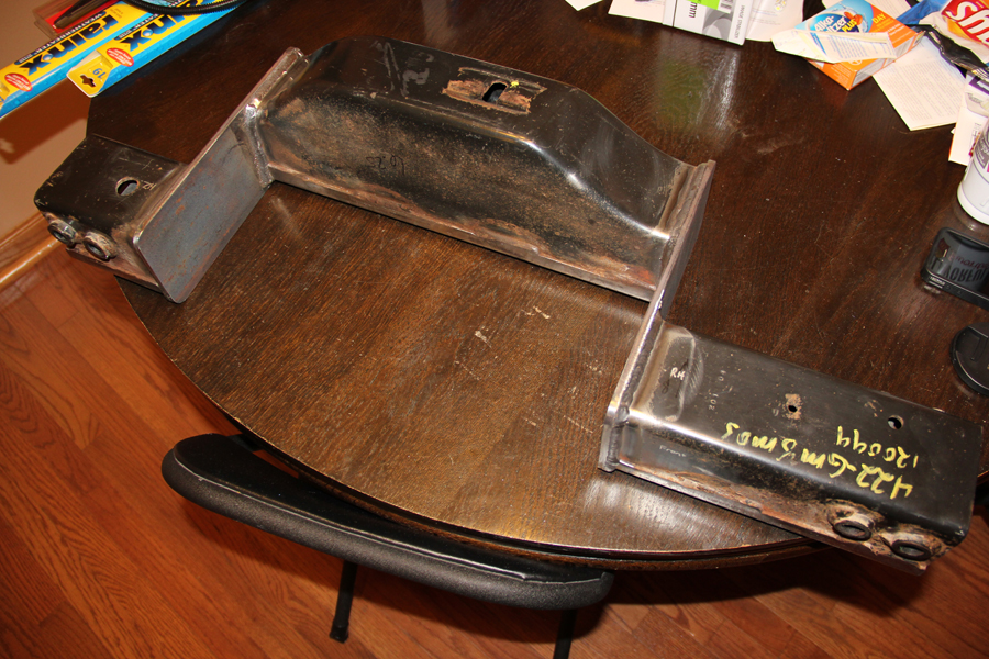

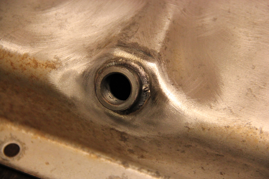

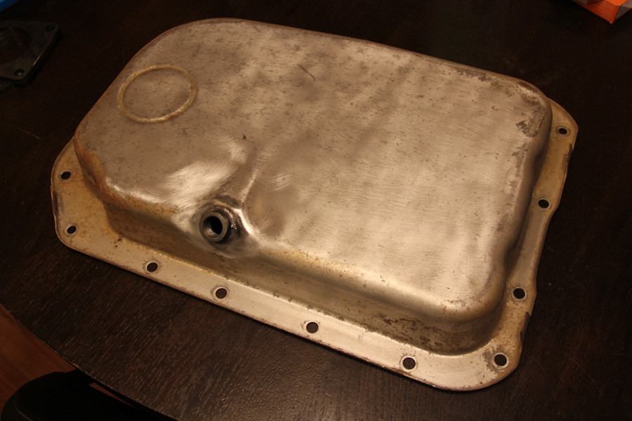

Took some parts to my fab/welding guy and had some work done this weekend. Had him modify a spare transmission crossmember for the 4L80E as well as weld a bung into the 4L80E transmission pan to make drains easier. I do also plan to prep and powder coat both parts the same flat black as the other parts.
Modified Crossmember:
Transmission Pan:

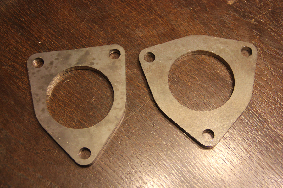

I also picked up some manifold flanges for welding the hot side.

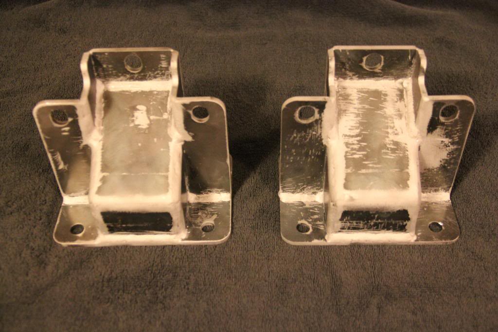

I am also going to start a thread for this, but I took him a spare set of engine mounts to have him weld them solid. After him and I talked for a bit we decided we are going to make some dedicated solid motor mounts and I am thinking about coating them and putting sets up for sale.
Regardless, those will be done in the near future.

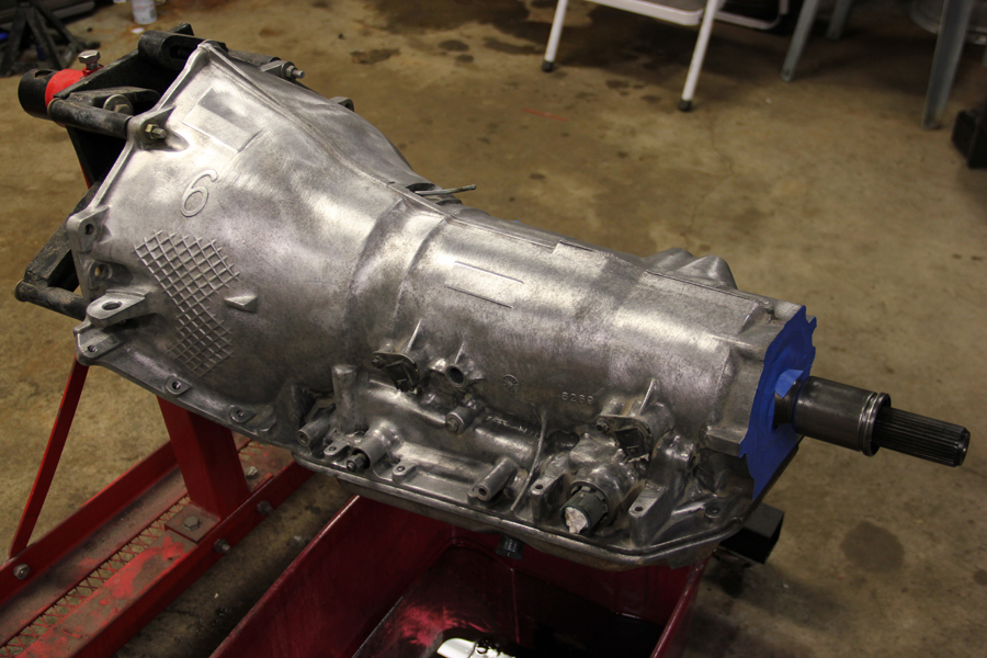

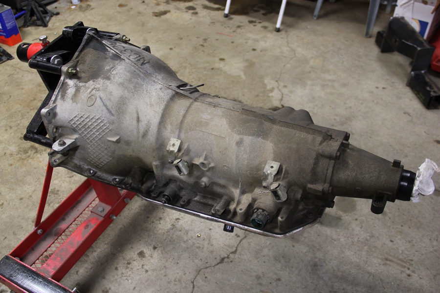

Alright, as stated before did some work on the transmission the other day. After getting the shift kit installed I brushed on some KBS. Not perfect, but it will do what I wanted it to.
Before cleaning:
Then after degreasing and hitting with Roloc wheel:
Finally a quick coat of paint:
However, as will be posted shortly. My transmission parts may be put on hold...

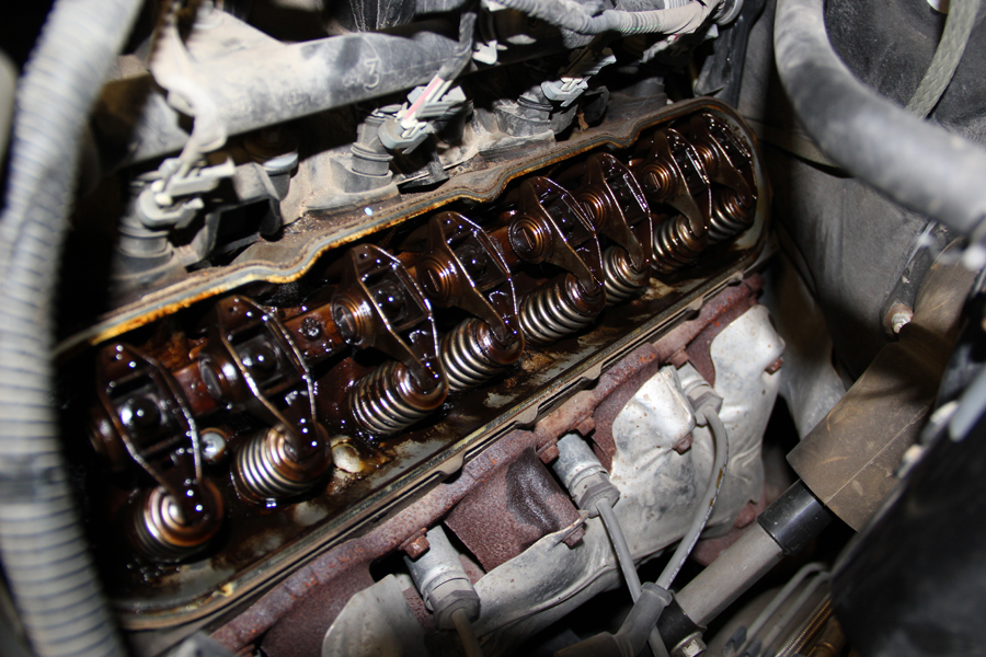

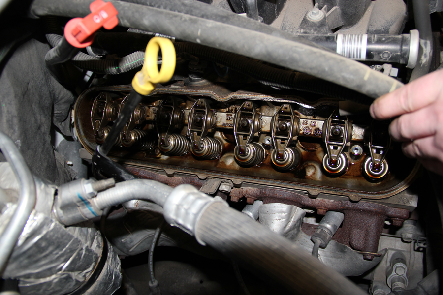

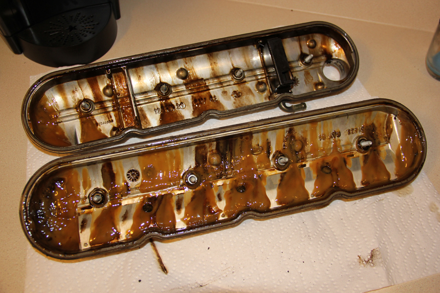

Earlier I noted an issue with coolant going missing. Well, I feared I may have the Catech heads since they are 706 castings. So I decided to pull the valve covers...
This, was not a good start:
The driver's head was covered in sludge:
The passenger head wasn't ideal, but looked tons better.

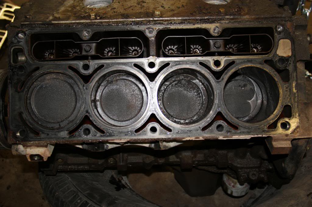

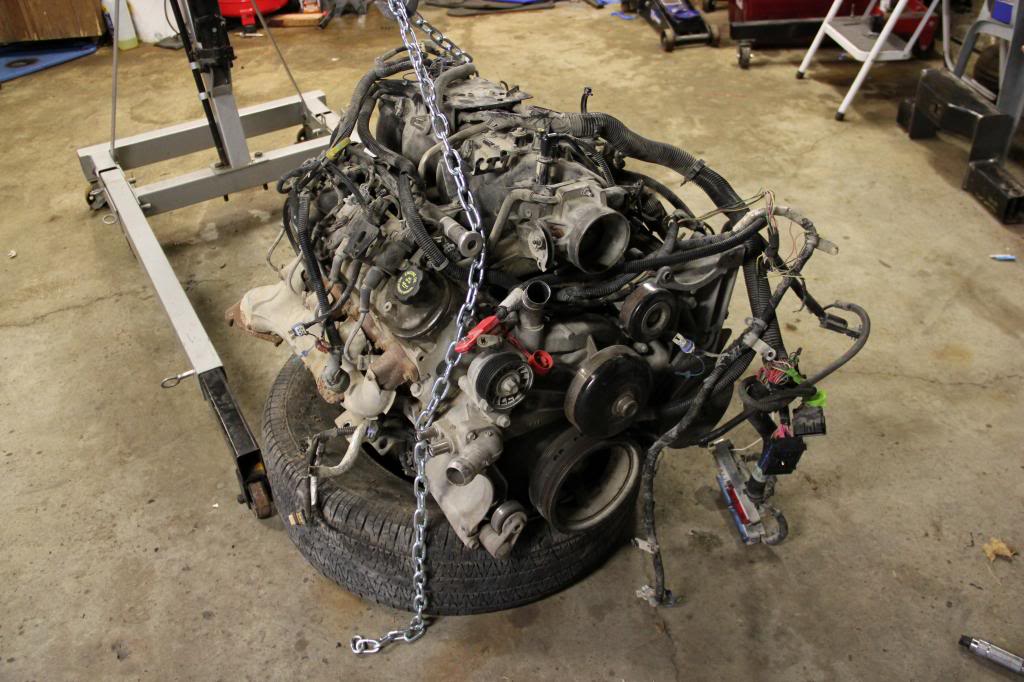

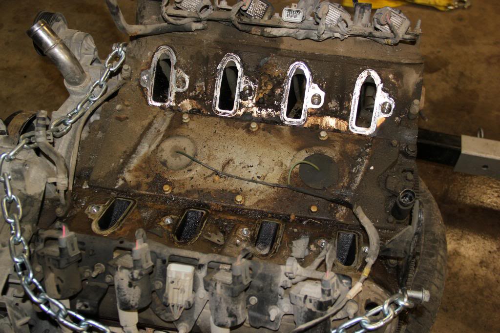

Picked up the spare engine this weekend. Picked it up, and here is how it looked.
Started getting it torn down, got the intake off. Was a bit on the dirty side.

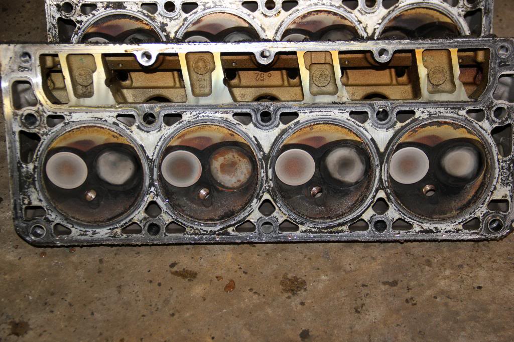

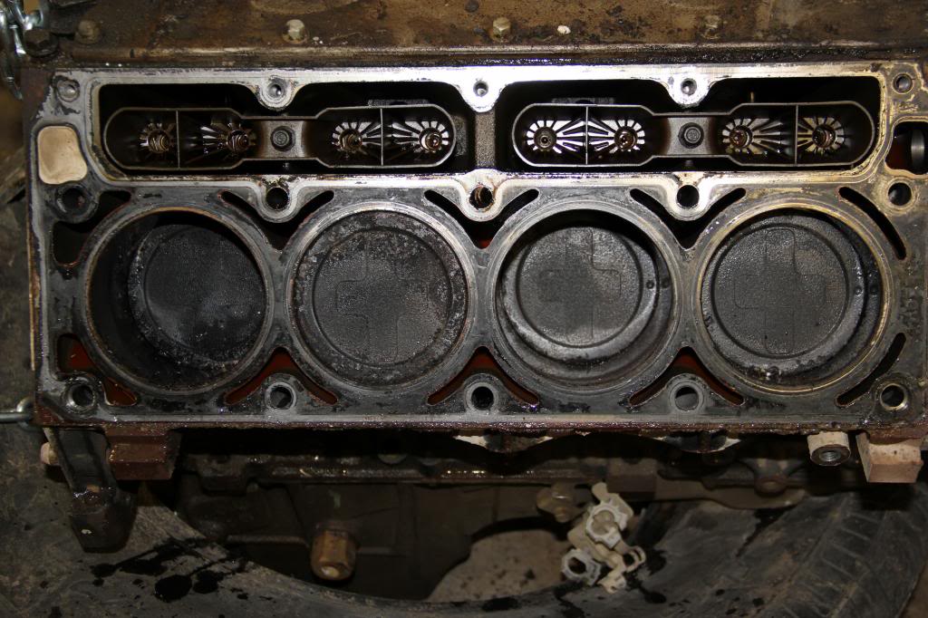

Got the heads taken off, here is the driver's bank:
Here is the passenger's bank:

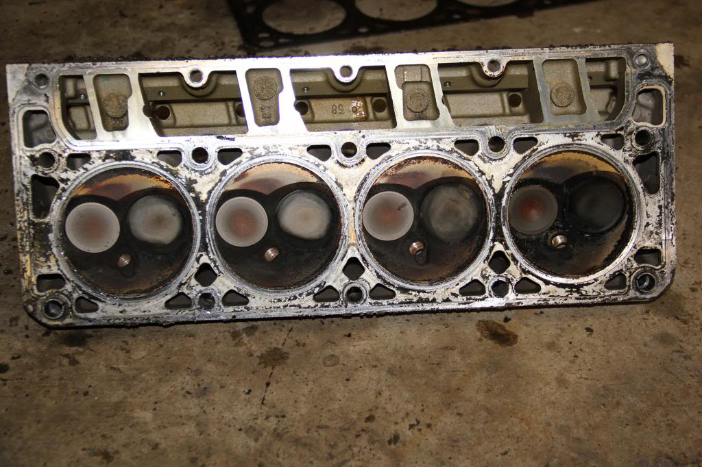

Cylinder head #1
Cylinder head #2
Going to get the heads disassembled, then hot tanked and spressure tested. Then put them together. Will be using Tooley springs, stock arms, probably Speed Inc. pushrods and Tooley lifters.
Also, the engine mounts are now ready to go.
For anyone following the thread for the mounts, I will be updating it as well. These still need to be powder coated, which I plan to do when I find some time this week.
