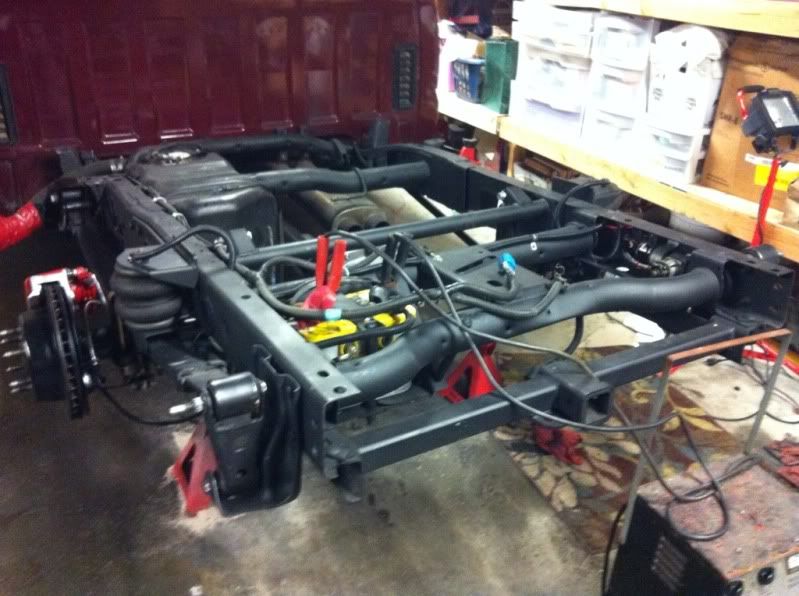

Almost done with the rear of the truck.
Caltracs installed:
6 Degree DJM shims:
SUV Rear brakes:
Almost done!
Air compressor installed:

What helper kit is that and how hard was it to setup?

It is the standard belltech kit with firestone bags, Straightforward install, shouldn't take more than a couple of hours to install.

How long did it take you to install that air compressor?
