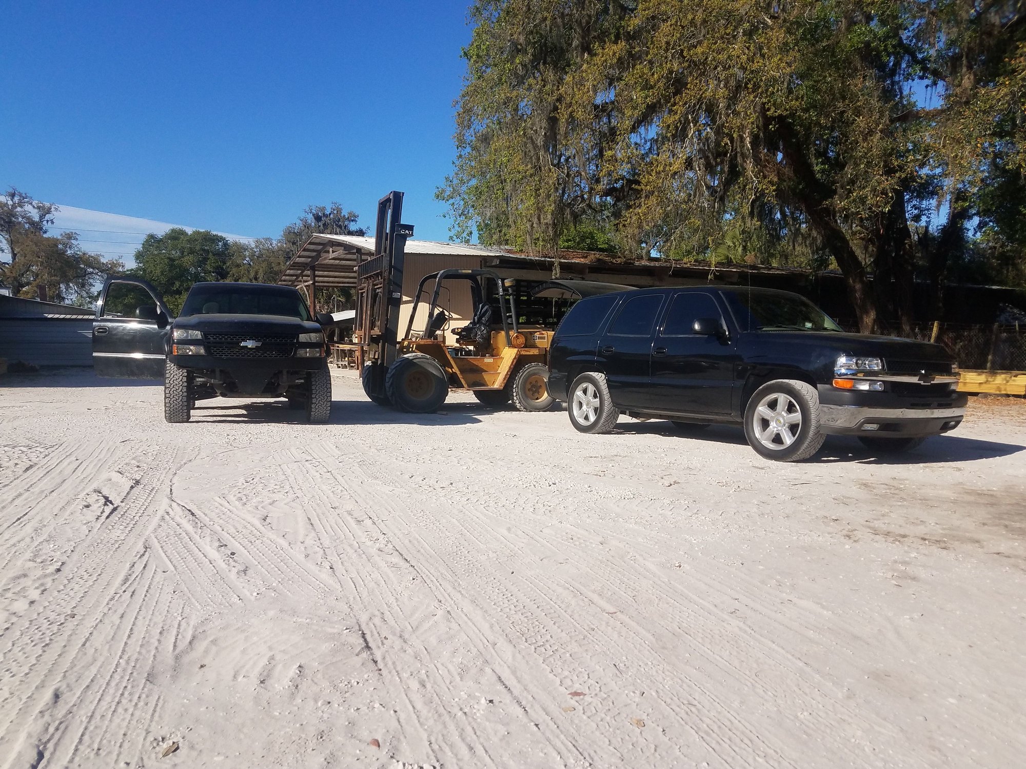

So many little issues have arose since the 6.0 swap most of them self inflicted due to rushing or just not knowing. The newest is the Walbro 450 I Installed 2 years ago taking a crap. Started the truck and was sitting idling while I pulled up my GPS. Suddenly it started to run rough and shut off. Fuel pump never came back on. Tried hot wiring it through the fuse box and got nothing. Drug it to a buddies lumber yard so I could use the forklift over the weekend to pull the bed. Got the pump out and will bench test it tonight but I had power going directly to the bucket. Only other possibility is the intake connector is bad which is doubtful. Got a new 450 coming tuesday.
Tahoe playing support truck as usual.

HD front end on the Hoe looks great.
Do you have any more pics of the traction bars? Interested in how you mounted everything.

Thank you. I will take some pics for you tomorrow. Basically had a crossmember made for it to mount to and the axle bracket is welded to the axle tube. Pretty simple setup and works great!
