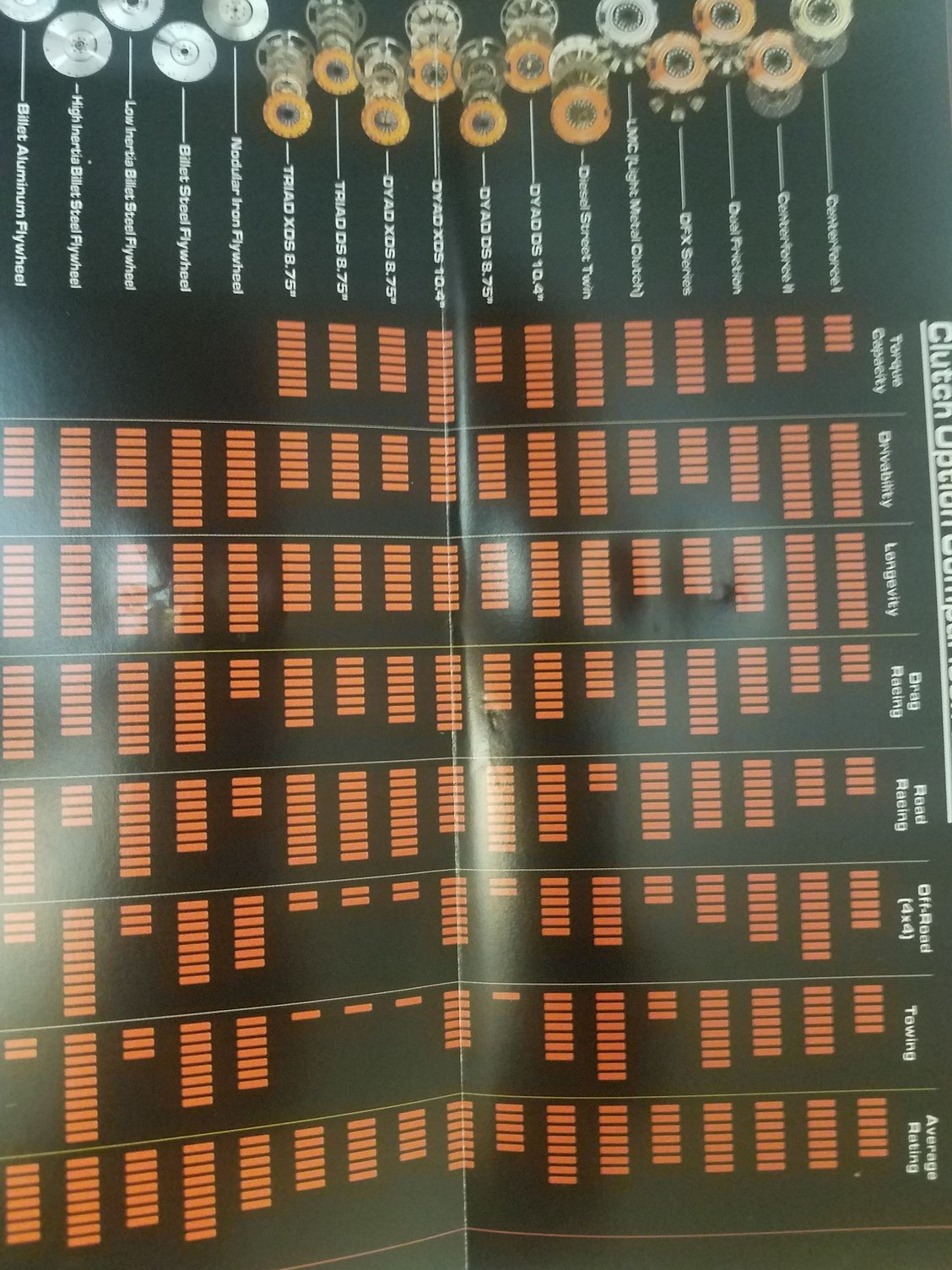

Alright I spent a considerable amount of time research clutches over last few days and this is what I’ve come up with.
Single disk: I don't want a dual or triple disk clutch. The LUK OEM replacement single disk clutch I had behind the supercharged 4.8 lasted 30k hard miles and would likely last another 20-30k. Since I will likely only make another 200hp/torque with the new motor and not add any weight or traction a single disk is for me.
12in Diameter: I saw a lot of conflicting information on 13in clutch upgrades for NV4500 and the only definitive information I can find is that all 13in clutches have a 1.25 input shaft diameter. The GM NV4500 that came behind the 6.0 in Silverado 2500s has a 1.125 input shaft. I have a GM NV4500 and don’t want/need to upgrade the input shaft therefore I’ll stick to a 12in clutch. Also I spoke to Midwest Transmission, South Bend clutches and, Valair Clutch on the 13in clutch upgrade. None of the technicians or sales people I spoke to knew for sure if the 13in clutch, pressure plate and, flywheel would fit in the bellhousing of the GM NV4500.
Organic friction material: This is pretty straight forward I asked different clutch technicians as well as lots of google searches. From what I've gathered this is my opinion. Organic is plain and simple the best for DD applications. Ceramic is best for hardcore racing with lots of hard engagements repeatedly and can withstands lots of heat but not very friendly to drive because they often require more clamping pressure and that in turn makes the pedal very harsh. Kevlar is good for DD but has a 1,000 mile break in period and is much more expensive. I only found dual disk Kevlar clutches with the 1.25 input shaft diameter so that’s not an option for me.
So these things helped narrow down my search and what I came up with is this. DF997997 - Dual Friction , Clutch Pressure Plate, Disc, and Flywheel Set
https://www.centerforce.com/product/...p65148-c326886
I will wait until tomorrow evening to purchase the clutch so please if you have any disagreements speak now before I waste my money!

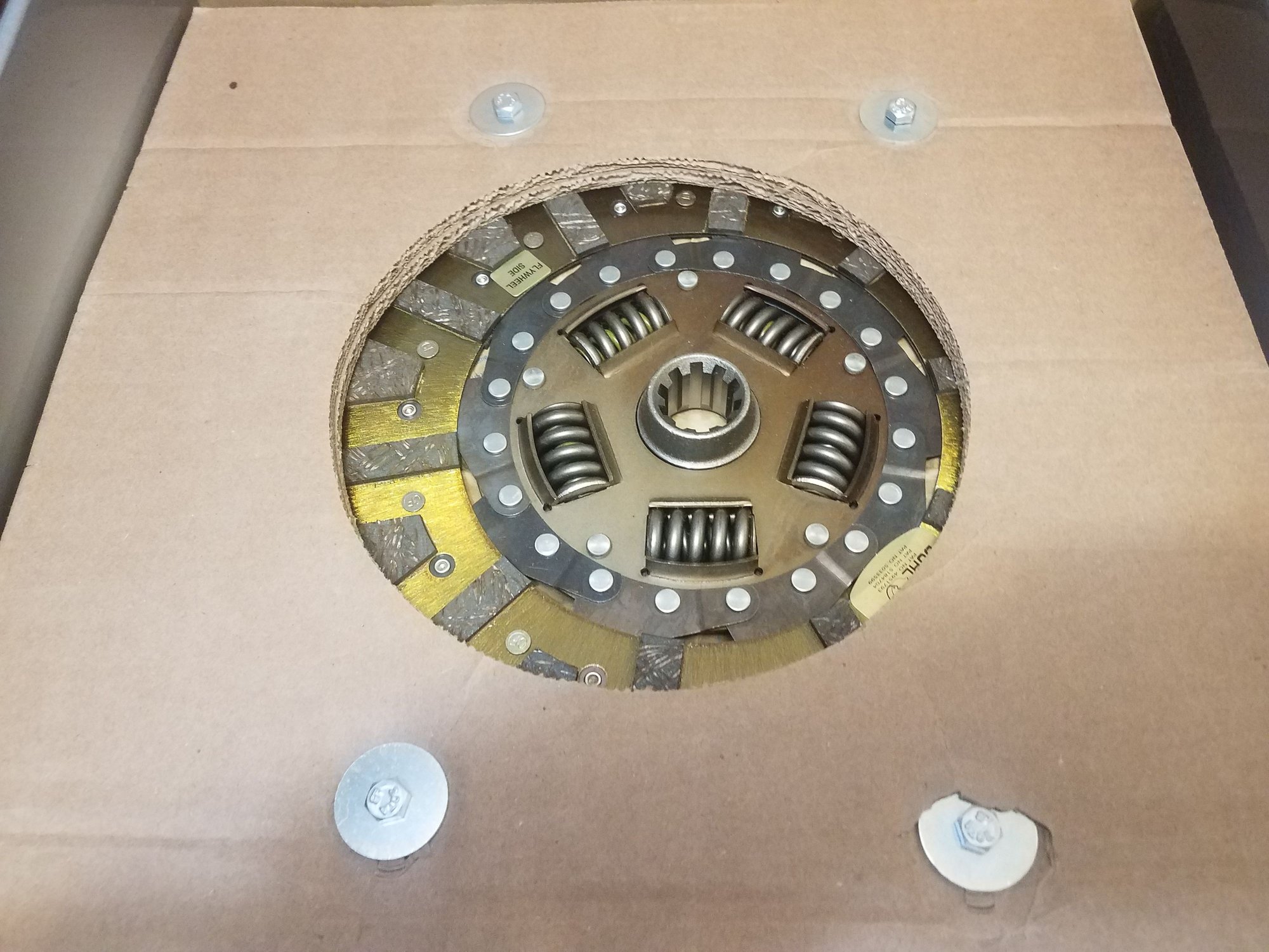

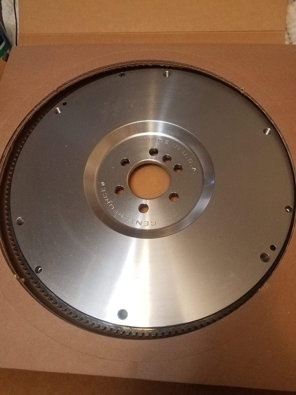

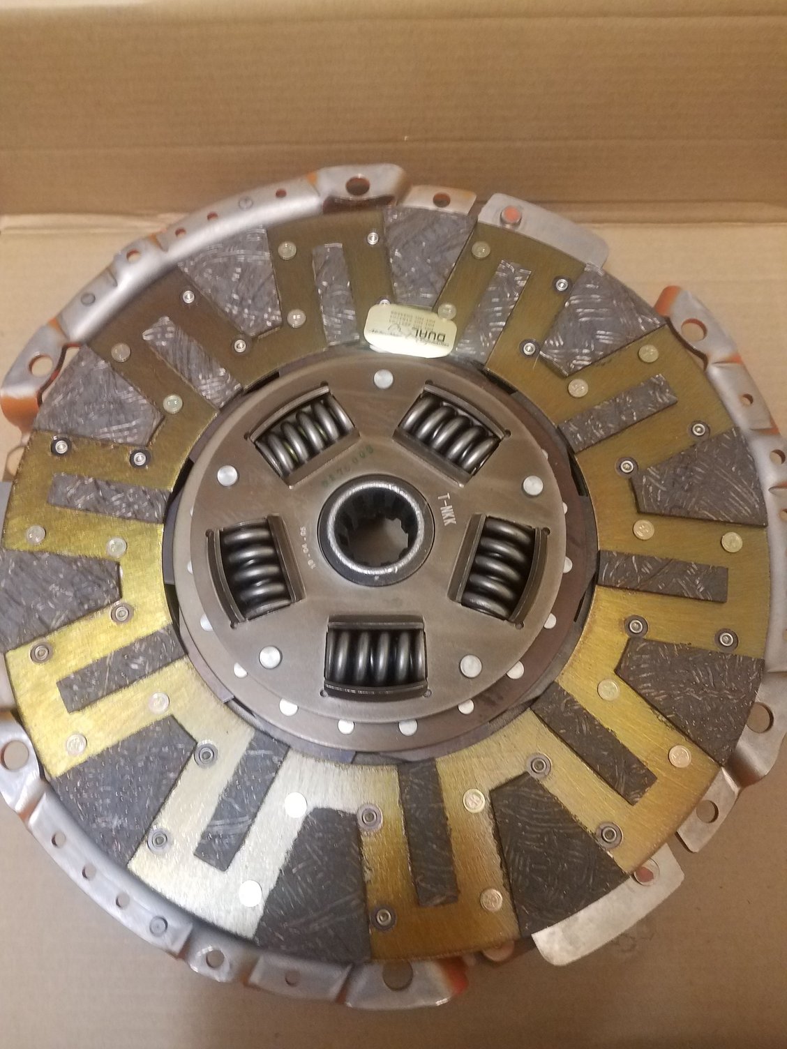

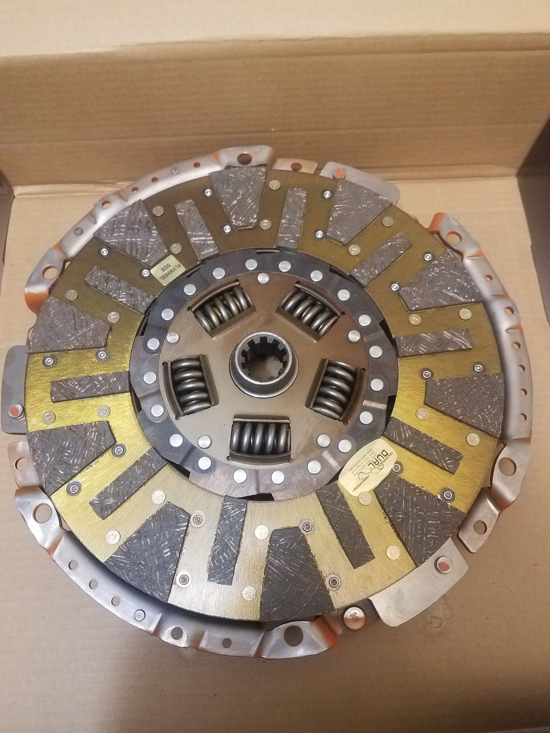

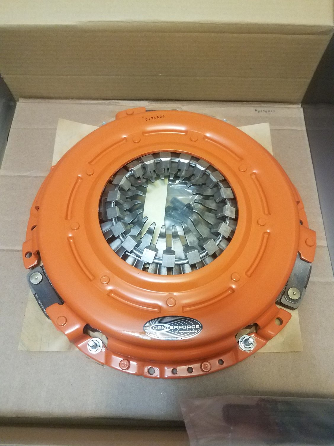

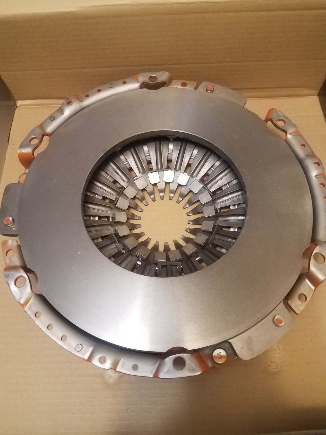

Clutch came in and it seems a little more aggressive than the description sounded. Maybe it's just the orange paint.
