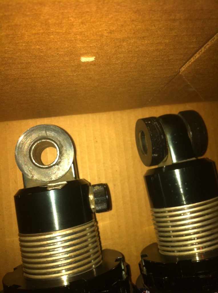

I spoke with Jake from Vi-king shocks today. He was very helpful. Unfortunately, it looks like I'm going to run into the same issue I had with the QA1 shocks; the bushing won't fit the factory bolt.
So I'm going to go to Home Depot and grab a bushing (3/4" OD x 1/2" ID) and cut it length-wise and see if that will work. That looks like what they do with the factory shocks.
If that won't work, I'll cut off the top mounted shock nut and just use true 1/2" dia bolts.

I had no problem putting the QA1 or Viking on with the factory bolts and yes the top nut is welded to the bracket on the truck. Just make sure you get the Poly bushing.
https://www.performancetrucks.net/fo...rt-1-a-527184/

This is what im talking about, i just used a washer to fill in the space.

Do you have a part number for that ploy bushing? That's what I can't seem to find to make this work.

When i order the Qa1 and Vi-king i ordered them with the poly bushing and that's how they came. I will dig up some info for you that i have.
