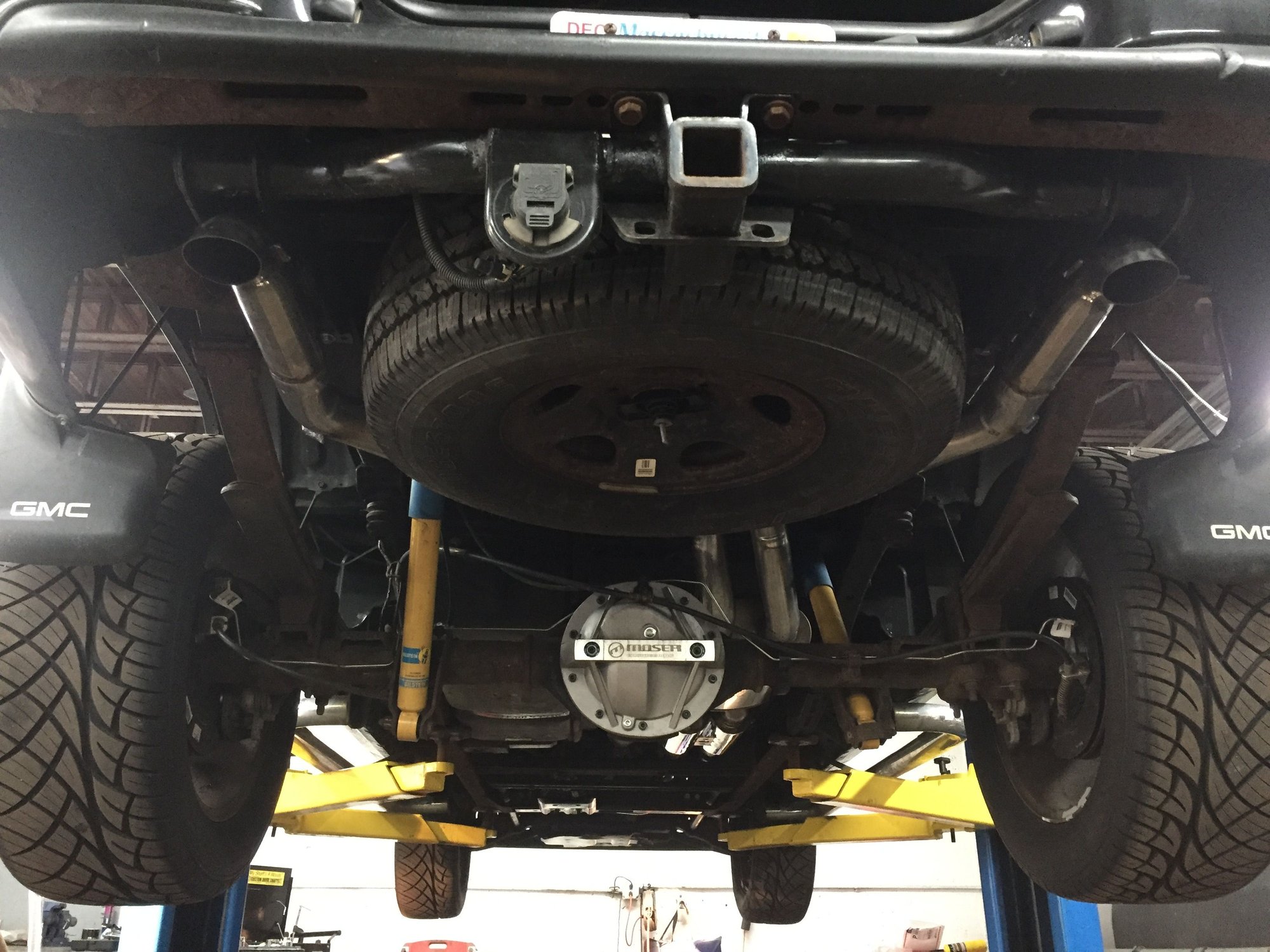

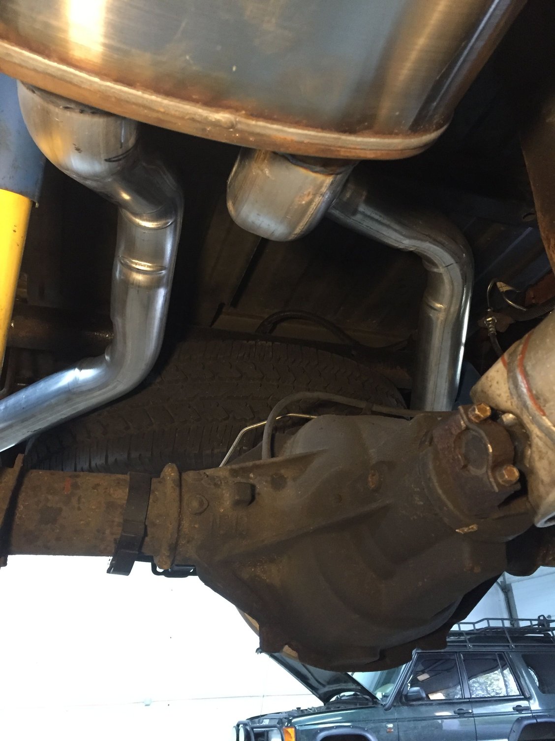

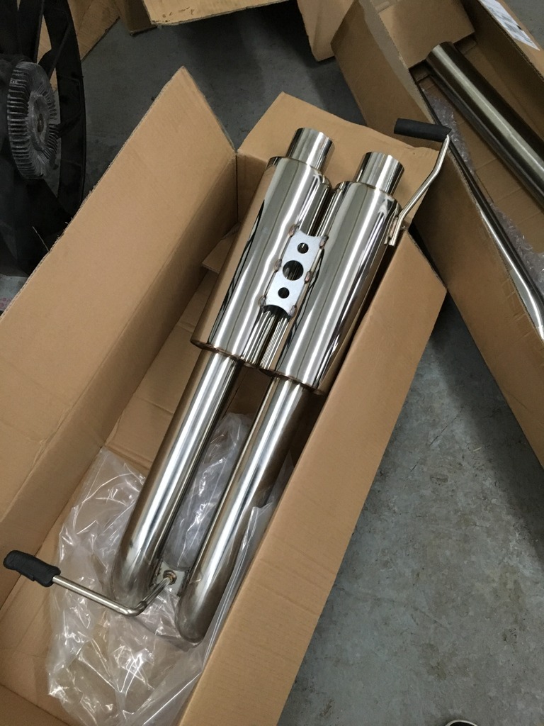

The exhaust was way to friggin loud, worst sounding, droned so bad you wanted to jump out of the truck on the highway. Without a window open you'd have a headache in minutes. So I had a shop add a magnaflow 12599 muffler and get the exhaust over the rear axle.
Now it's kinda too quiet.

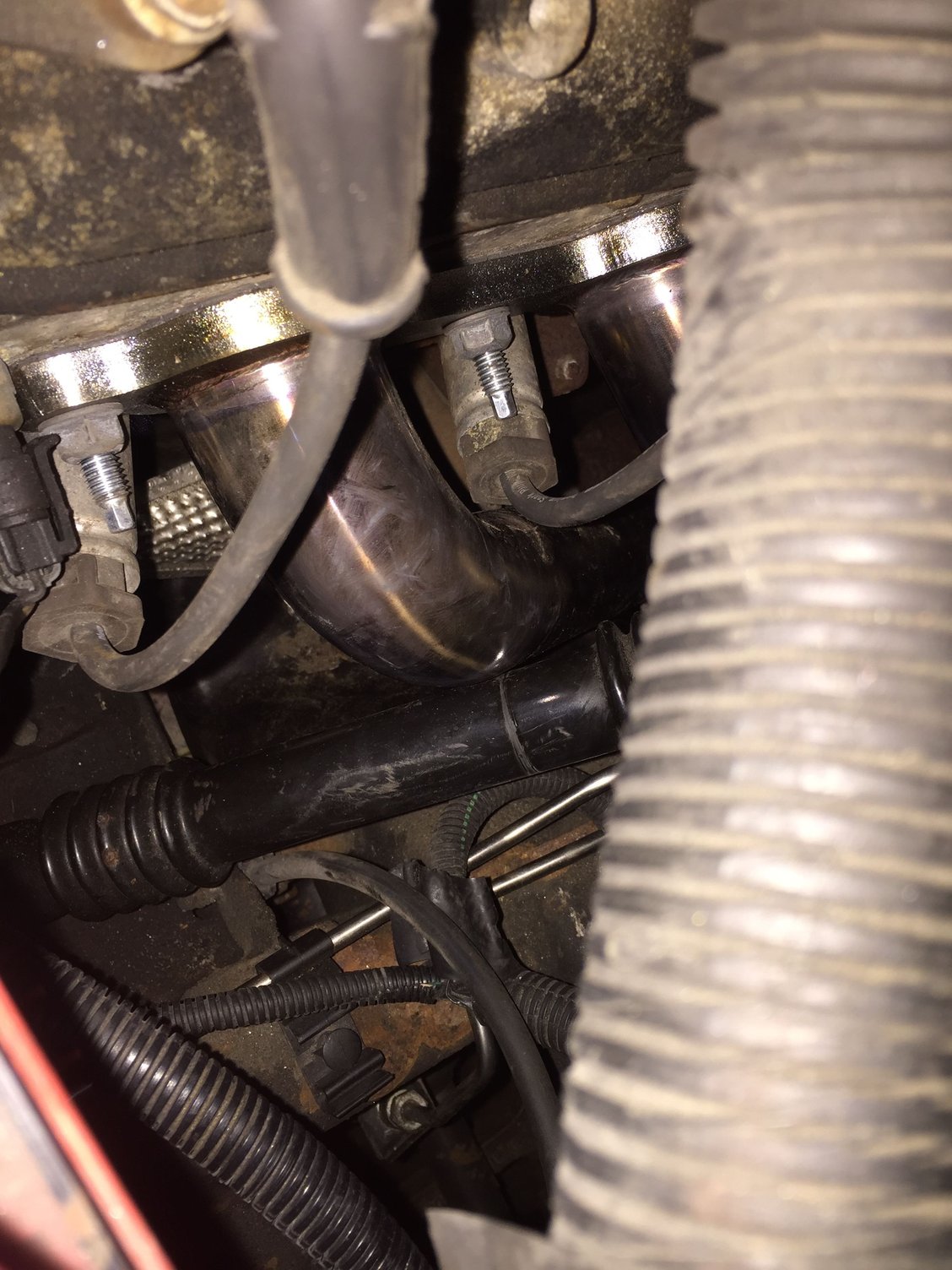

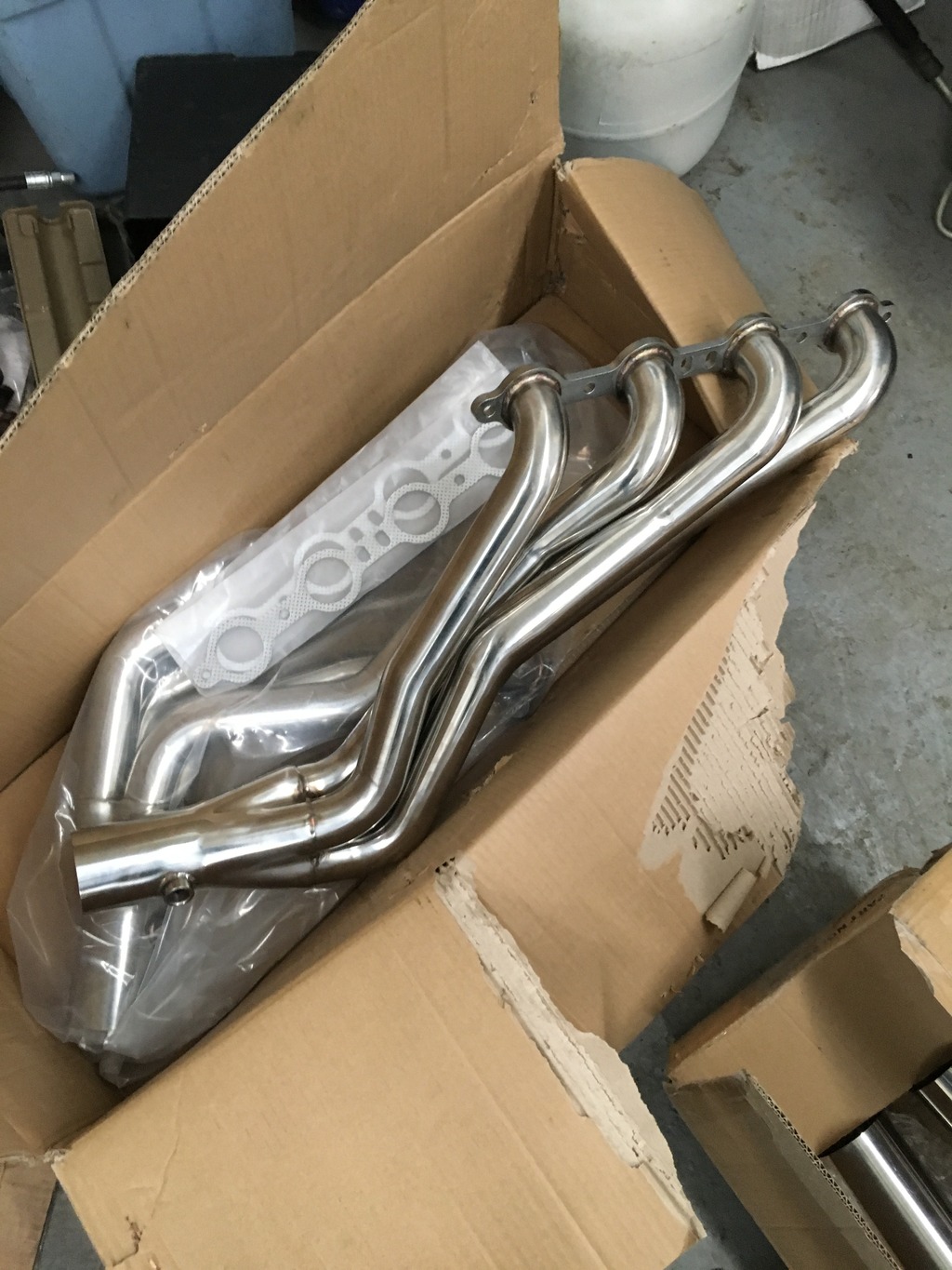

Does anyone else have a problem with the 1 7/8" speed engineering long tubes hitting the steering shaft? Motor mounts look fine.

I've got Speed Engineering 1-7/8" headers on a '02 Tahoe 5.3. They don't hit the steering shaft but they're dang close. I had fitment issues with the headers hitting frame rails on both passenger and driver side... replaced motor mounts and gained ZERO clearance.
I ended up denting mine... the motor mounts are a PIA!!!

Glad to hear someone else had similar experiences with these. Going to dent the header in a bit to clear the shaft, the steering vibration is... 'interesting' to drive with, to say the least.

Seems more and more of the Speed engineering headers are not clearing any of the 4wd/awd trucks without use of the BFH.
