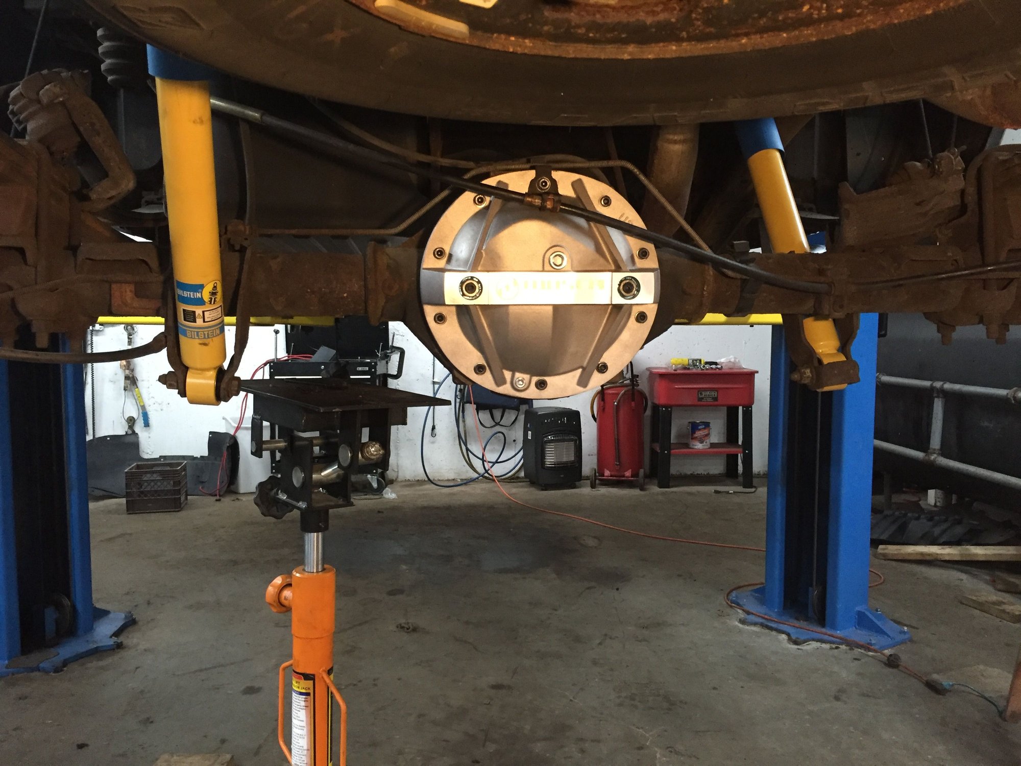

Update:
Only having limited time to work on the truck during the weekends, I've made some progress on fixing all the odds and ends with it being an 11 year old truck (front end, brakes, brake lines, hoses, shocks etc)
While doing this I added tie rod sleeves, the rough country sleeves apparently don't work with the moog tie rods so I went with AC delco which appear to be a nicer quality.
Also, the stainless pre bent brakeline kit from summit for $96.00 fits perfectly and is of equal quality to the classic tube kit I purchased for my duramax for over $500. I'm going to guess the fittings are either not stainless or crap stainless but that's a big price difference for the amount of time they will last.
While changing the ebrake assemblies I also added ARP main cap studs and a Moser girdle cover.
Just needs tires and an allignment now, maybe a final brake bleed as well.
